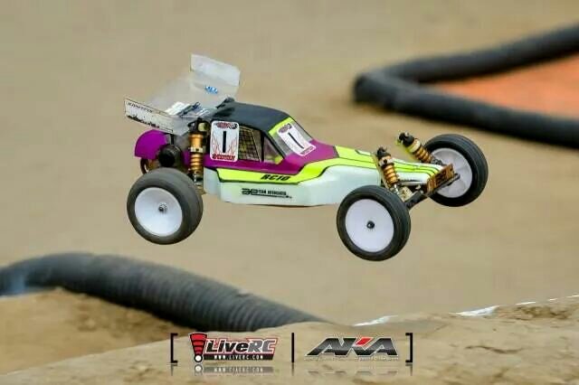

Well, raced it this weekend. And yes, I changed shocks again.
--Joey --
Vintage A&L and Factory Works
JKRacingRC.com

Post by ca-rj »
Why the shock switch?
RC10 Short Arm | Novak Tempest ESC | Tamiya Torque Tuned 25T | Savox 1258 | Stealth Trans w/ Exotek Slipper Eliminator (geared 24/81)
RC10B3 | HW Just Stock Club Spec | Reedy 13.5 | Savox 1258
JK Racing
Posts: 4603
Location: Placentia, CA
Has thanked: 103 times
Been thanked: 200 times
Re: JK's re-re Racer build
Post by JK Racing »
I built my son a B4.2 from all the extra B4 stuff laying around, so it naturally wanted the big bores off it. I originally put the Team C small bore shocks on there, but had my gold shocks/white parts just laying there staring at me, so I dropped those on :) The feel more "natural" on this car, and look correct. I will admit, to anyone looking at the shock collars, I continue to use the Team C springs, as they are much longer than the AE springs and the car feels fantastic with them. I will need to ask the person I got the shocks from which ones they are...but I think they are the "soft" version.
