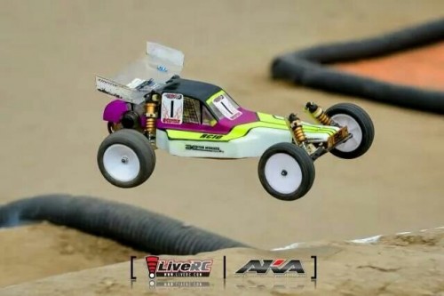

So, based on something I saw Michael from Revolution Designs do, I was able to swap on B4 wheels by only adding a spacer and changing the outside bearing. Can't wait to try it at the track!!
This uses the STOCK axle, either inline or trailing, no need for GT WIDE axles.
The "demo" picture:
Installed on my re-re:
The "demo" picture:

Joey I've seen twice now thus spacer trick but I've mounted up two sets now with no spacer and it's on the money. Spacer for kicking out the tire for wider width? Love the build and trying to get two cars ready for an upcoming race. Following this closely.

Reggie can probably chime in to verify but I'm pretty sure what they don't like about a longer axle or offset to run those wheels is that the pivot point is wrong and it causes the handling problems that Reggie mentioned in the Worlds ReRe thread. Physical fit may be perfect but the geometry is "off"

Johnboy, are you using the 2 different sized bearings? If you do that, with a B4 offset wheel, it will glide back and forth on the axle. If you use standard B4 bearings in standard B4 wheels on stock axles (which fits perfect, no issues, no spacers), it will narrow the front end up. If you use the GT wide axles (and now re-re Worlds style), the pivot point "swings" the wheel around, not pivots. I can't really explain it well, but I did notice a difference.

That's it. I was using the non flanged bearings on both sides. I'm trying two things with the standard rear arms and two different rear hubs. We'll try to get them to the track to test which one works for us.
