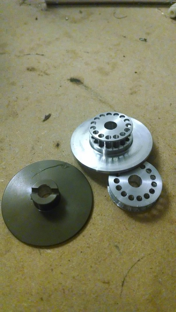

...and the rear slipper pulley. Gonna have to trim the motor plate a tad bit :mrgreen:

Sprockets on...now to locate a 582mm belt :shock: haha
I do need to sink the rear pulley just a tad more. I didnt check to see if I was bottomed out it not
This shaft can get cut off
Btw, perfect size on the pulley jake! Smaller would have rubbed and larger would have also

The parts look good and I am glad they work. We could always take some more material out of the rear pin slot to have the pulley set deeper on the shaft.

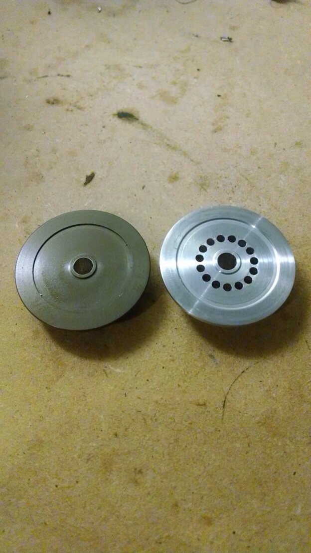

I sunk the rear pulley a tad more, you can see it is fairly flush with the plate now. Also test fitted a Protech, just a tad high in the front but not too bad.
