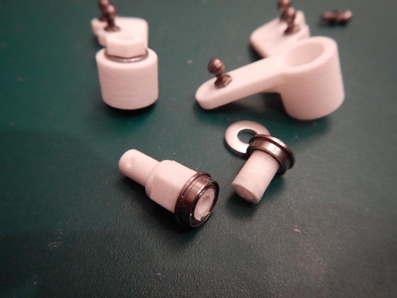

I had an issue with the racing steering for my runner. While threading the post screw, the top of the post sheered off!
There was still enough meat to thread it on, so now it acts more like a lock nut. One question to Niki or Jake, should we use the lower nut on this steering kit?

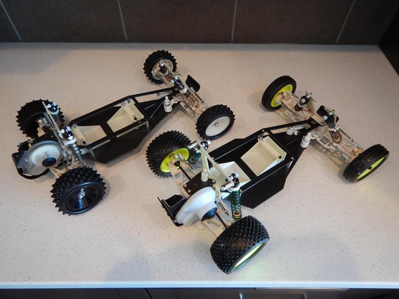

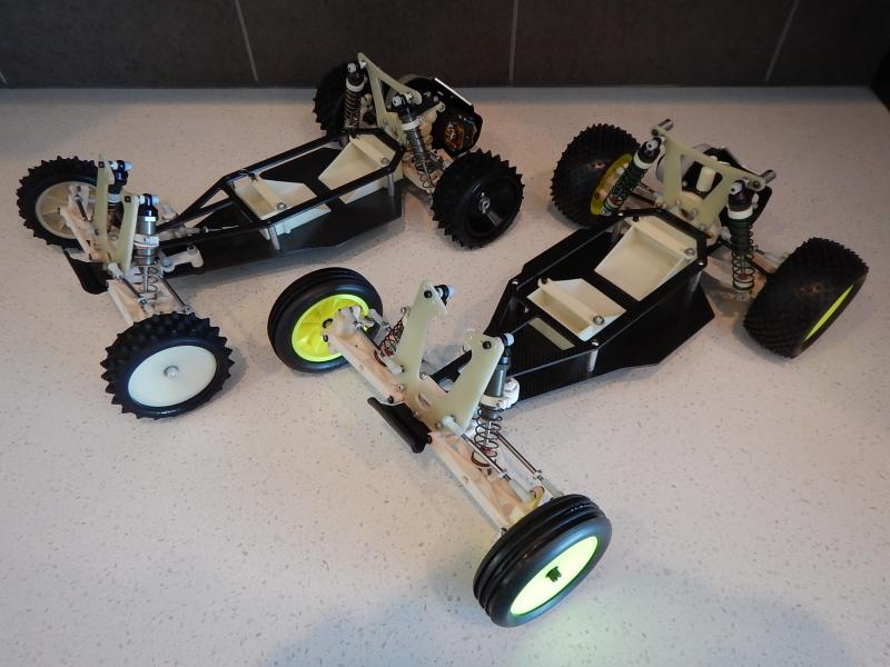

The runner with the yellow wheels has a rere US tranny with a B4 top shaft and VTS slipper http://www.teamassociated.com/pdf/cars_and_trucks/shared/91175.pdf . Also the new RPM gear cover. The front wheel has one inner rib removed to narrow it and give it that vintage feel. I wanted a racer with hidden modern upgrades. The racing ball bearing steering by NIX is silky smooth and requires 4 1/4x3/8 flanged bearings.

Yes, thin nut #8182 should be used under race steering bellcranks. Check out the drawing:slotcarrod wrote:I had an issue with the racing steering for my runner. While threading the post screw, the top of the post sheered off!![]()
http://www.rc10talk.com/download/file.php?id=91922&mode=view
On drawing only one nut is missing under right hand side std bellcrank (NIX91-012).
As bearings around NIX91-025 and -026 does not allow them to expand at all it's really important to drill the center holes clean. While assembling the bellcranks, parts 025 and 026 do not need to be tight on threads as thread is so long and almost zero force is trying to loose them.
-Niki-

Rod the pair of cars look great. Cant wait to see the Cliff version completed and even more curious to hear about the track report on your runner.

I tapped my steering parts, installed a screw, then sanded down the bearing surface so the bearings installed without stress.
