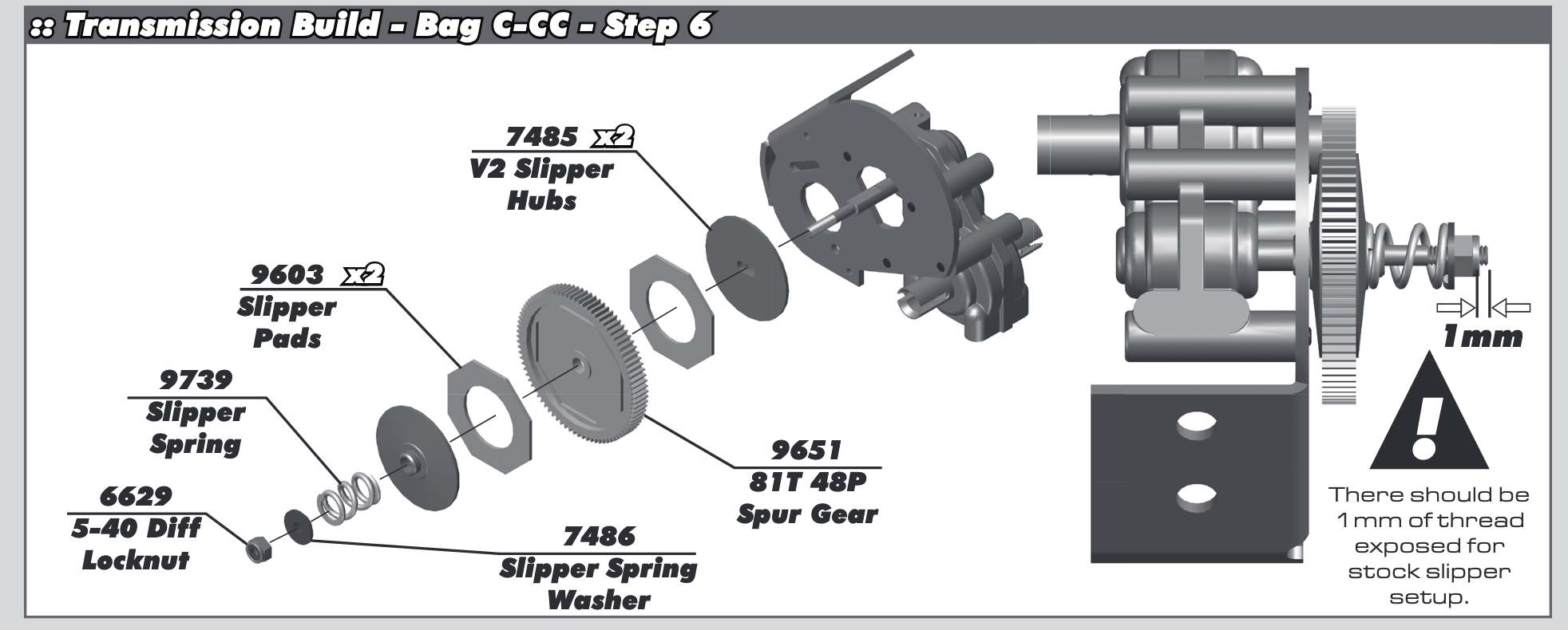

I think the parts for going associated are
https://www.associatedelectrics.com/factoryteam/parts/details/7485-ASC7485-ft_v2_slipper_hubs/
https://www.associatedelectrics.com/teamassociated/parts/details/9739-ASC9739-slipper_spring/
slipper pad
https://www.associatedelectrics.com/teamassociated/parts/details/9611-ASC9611-slipper_pads_v2/
spur gear
https://www.associatedelectrics.com/teamassociated/parts/details/9649/
Top shaft
https://www.associatedelectrics.com/teamassociated/parts/details/9601/
slipper nut
is just any 5-40 lock nut
https://www.amainhobbies.com/protek-rc-540-high-strength-standard-zp-steel-locknut-20-ptk-h-5602/p-qqqwtaqahzzxactz
The manual here https://img2.associatedelectrics.com/pdf/cars_and_trucks/RC10WC/Worlds_Car/RC10WC-Manual-updated.pdf
can show you how to assemble the new parts

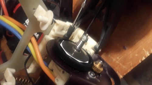

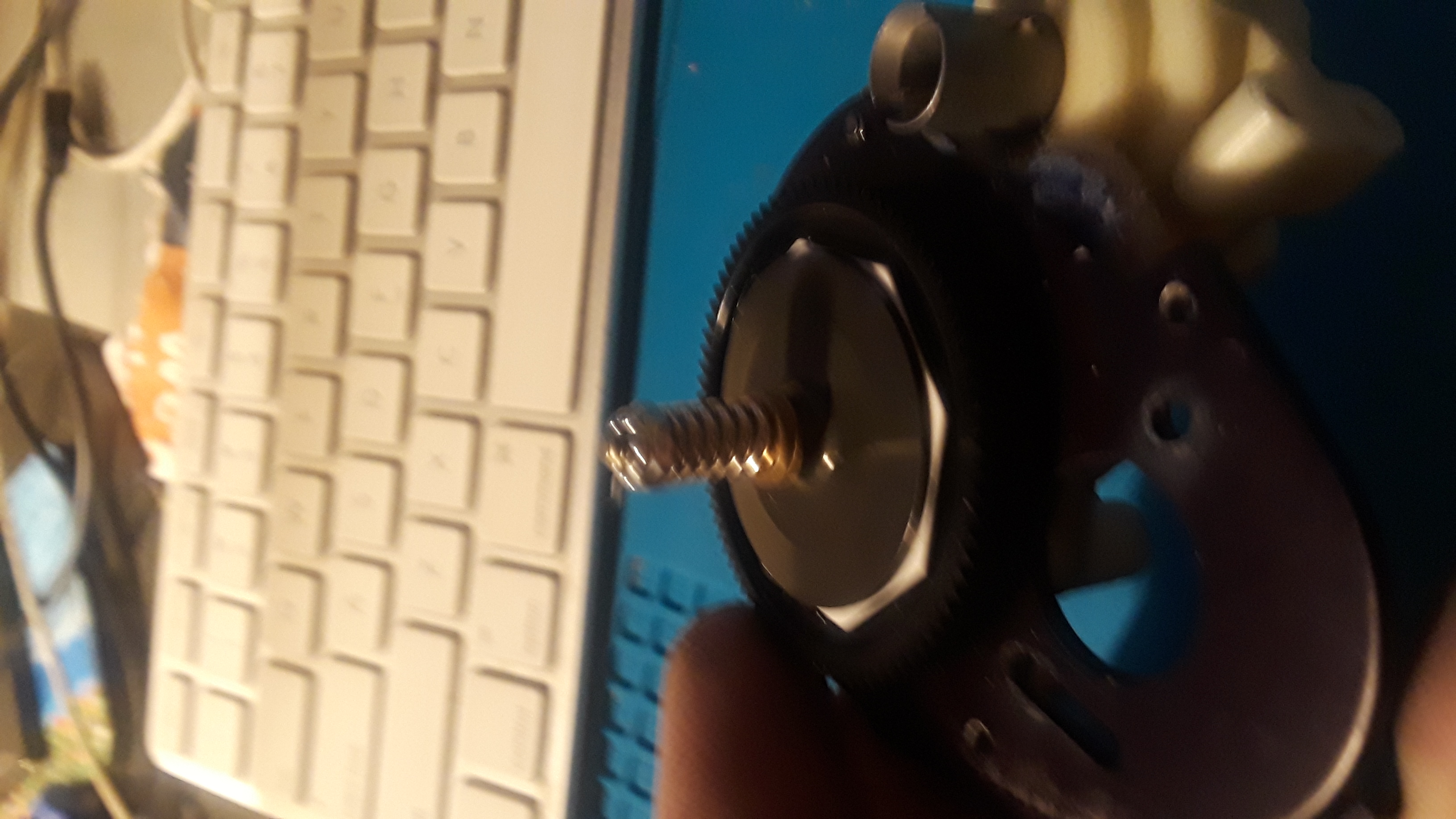

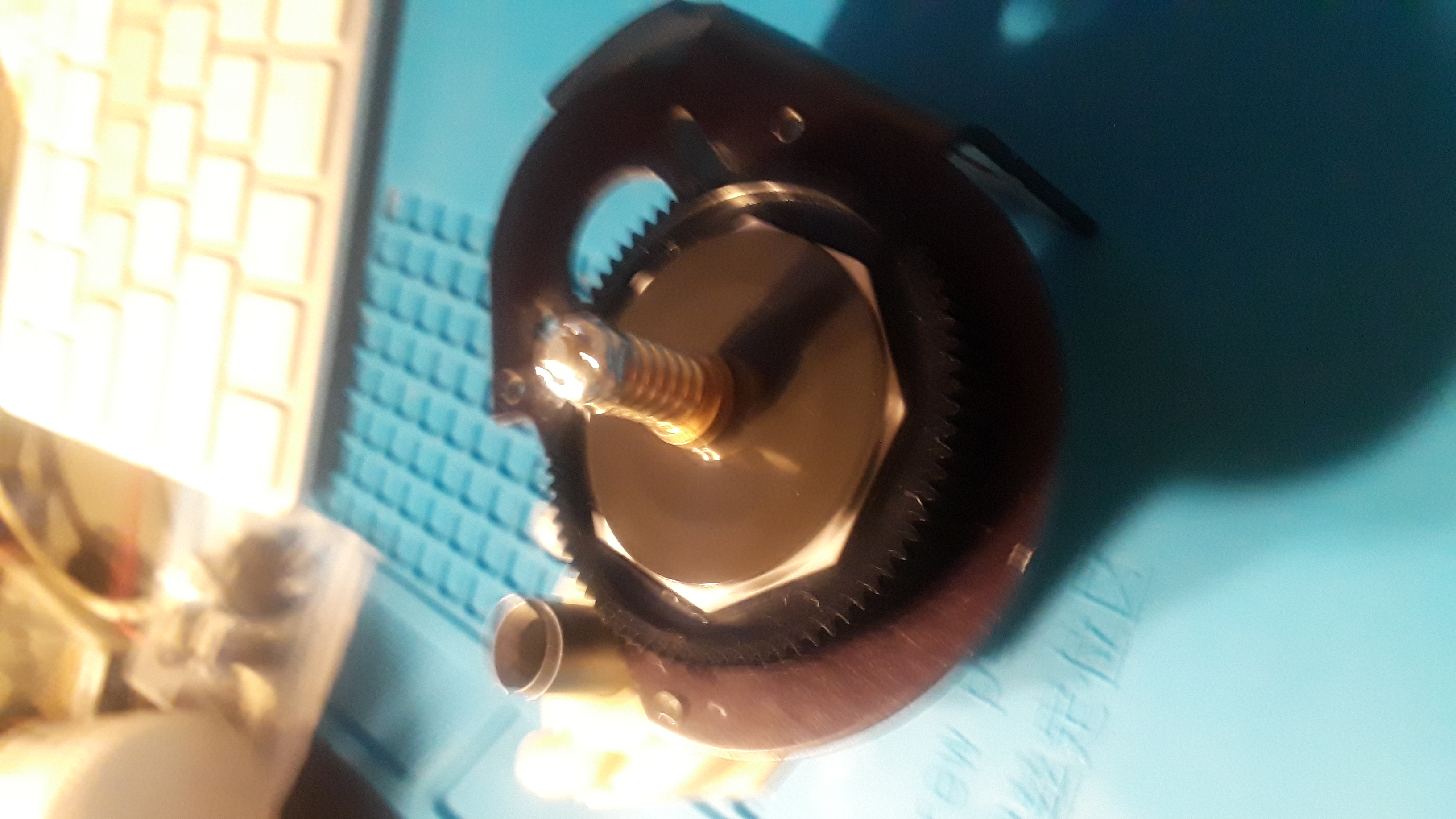

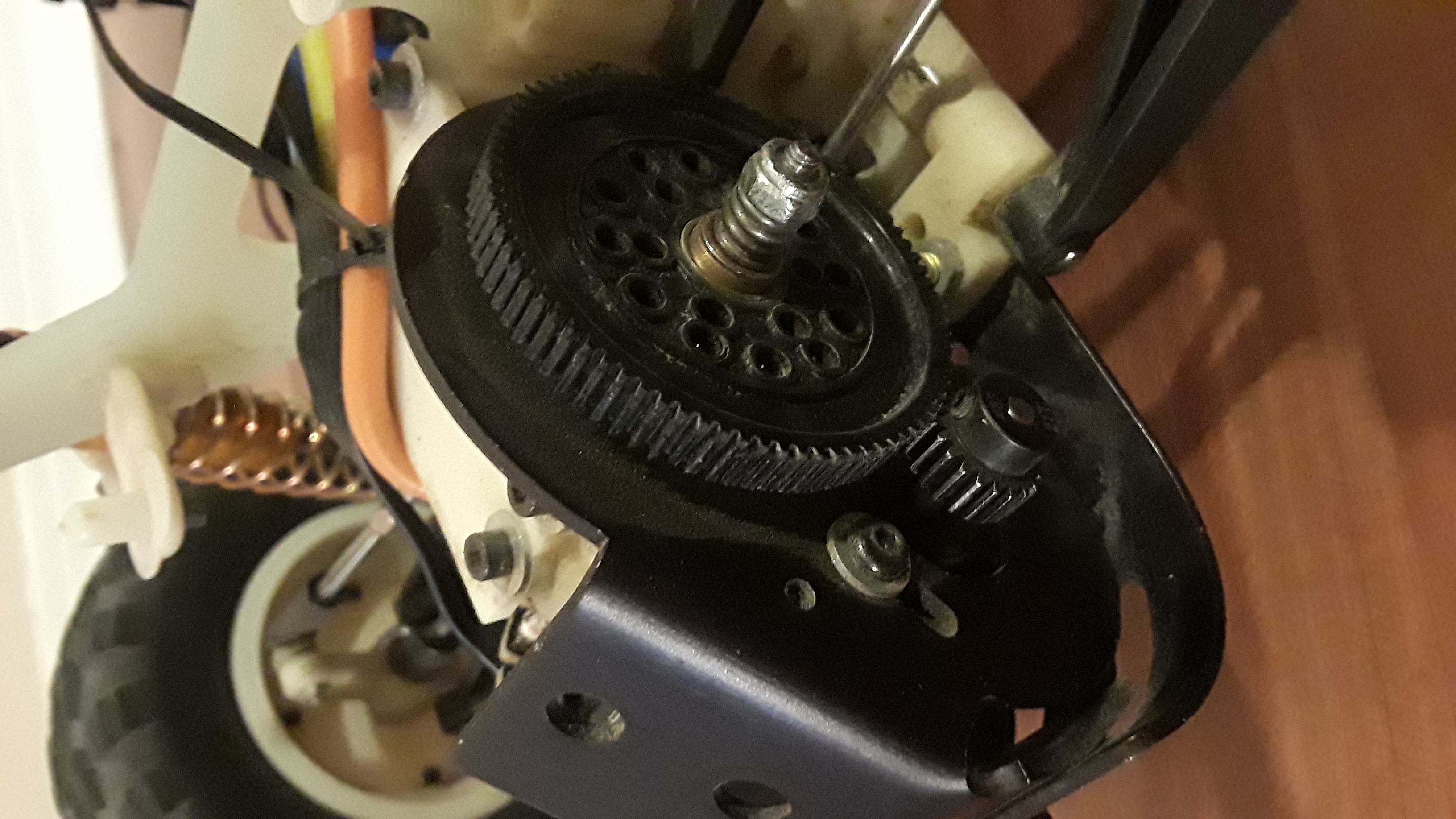

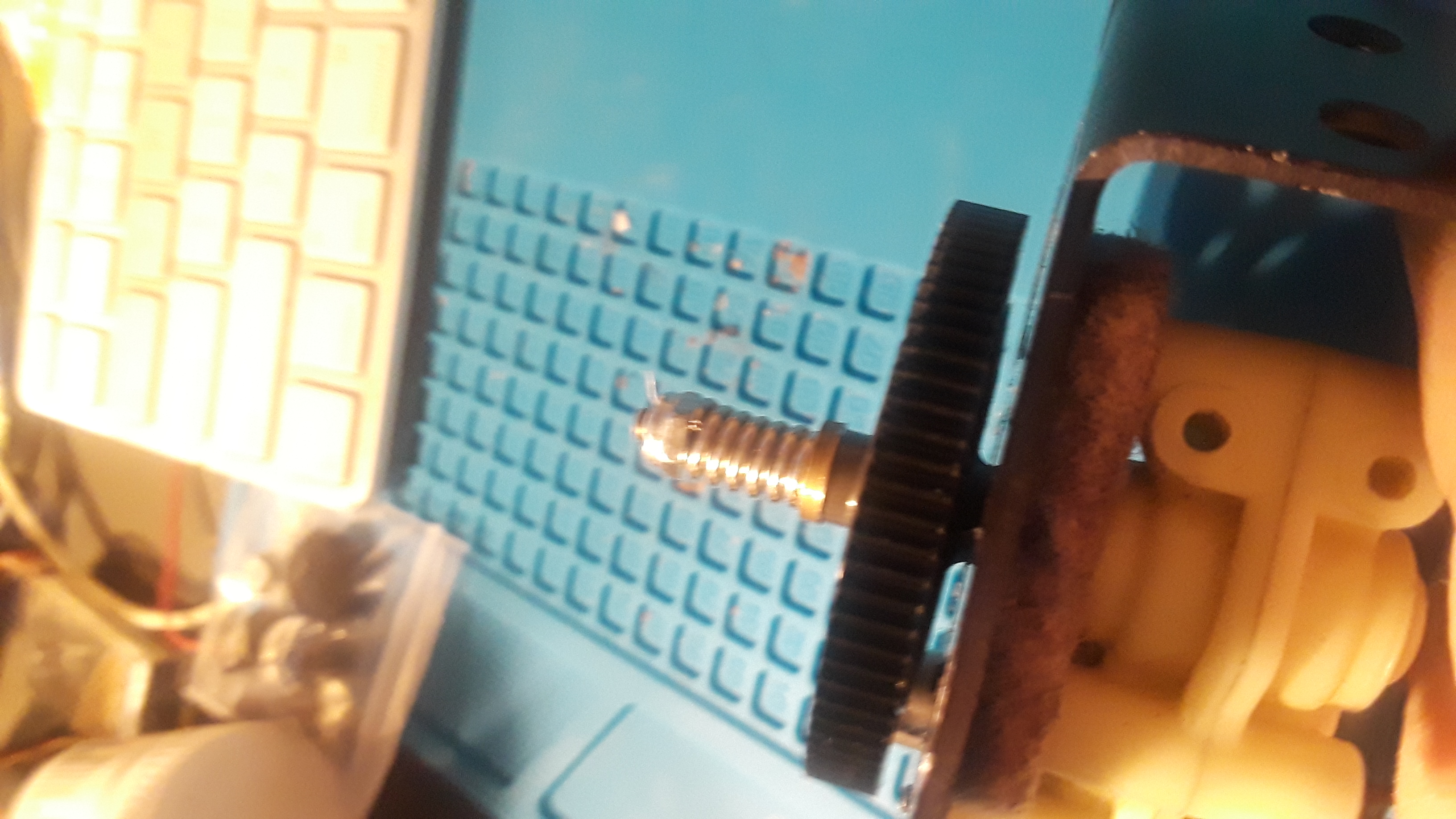

Check my work?
Is this how to set this up?
I replaced the top shaft and the slipper with an RC10 B4

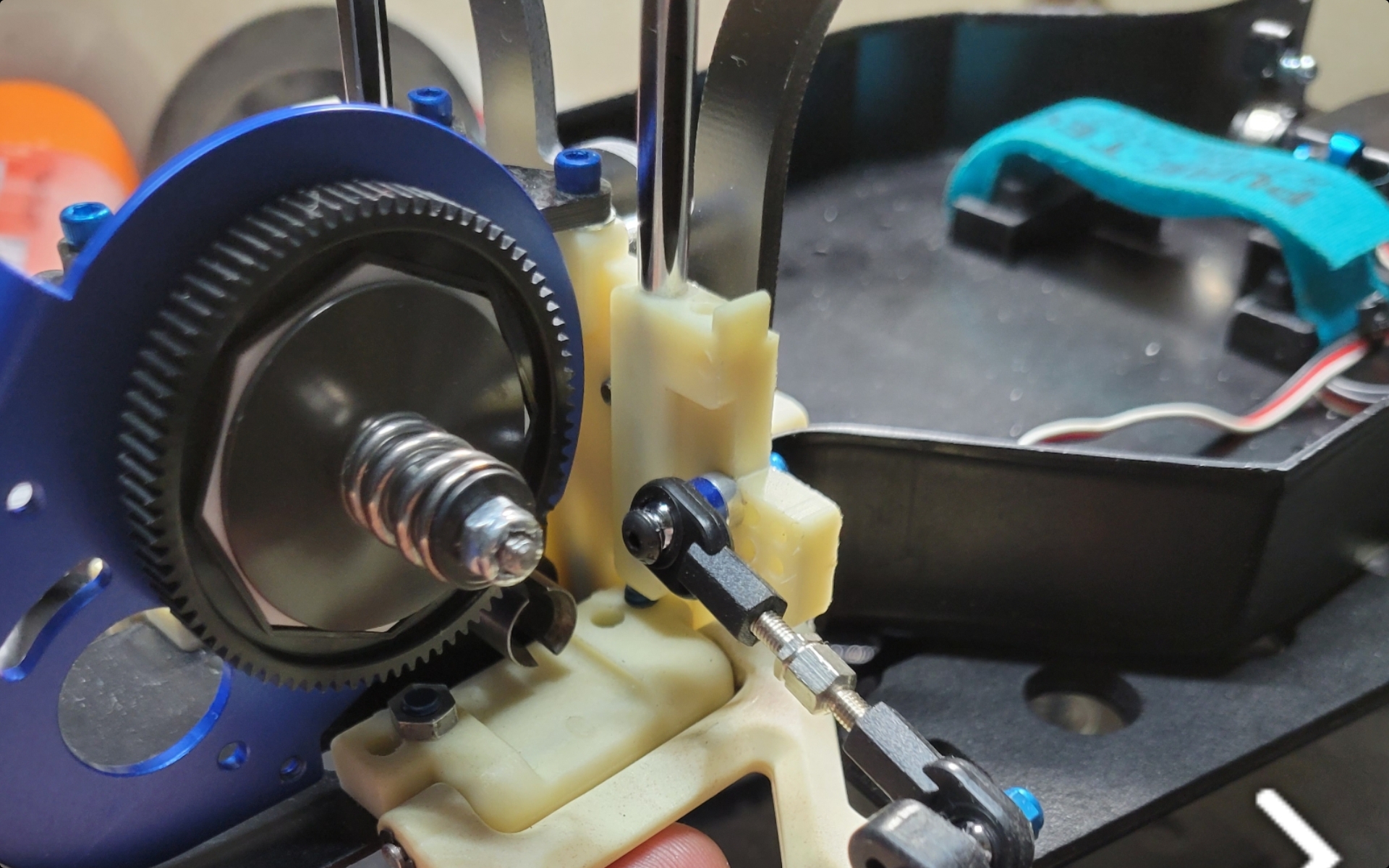

Posts: 3535
Has thanked: 268 times
Been thanked: 2094 times
Re: B4 top shaft in RC10 stealth trans
Your spring assembly is wrong. This is one of mine.
mikea96
Posts: 3599
Location: Puyallup, WA
Has thanked: 659 times
Been thanked: 878 times
Post by mikea96 »
Yours is the v2 slipper and the other is the first version b4 slipper.
BohemianBabyDev
Posts: 27
Joined: Sun Nov 07, 2021 11:53 pm
Has thanked: 28 times
Post by BohemianBabyDev »
Yeahhhhp saw that when i went back to review the instructions.
Thank you for your input!
This has all been a great help.
I got some MIP dogbones in the mail today and polished them and added those as well.
Still waiting on a front arm to get back to it to test drive but it's super smooth and quiet.
