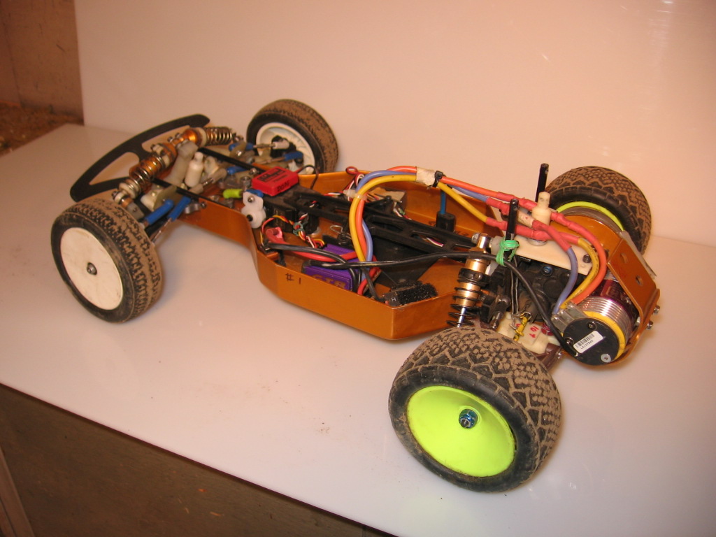

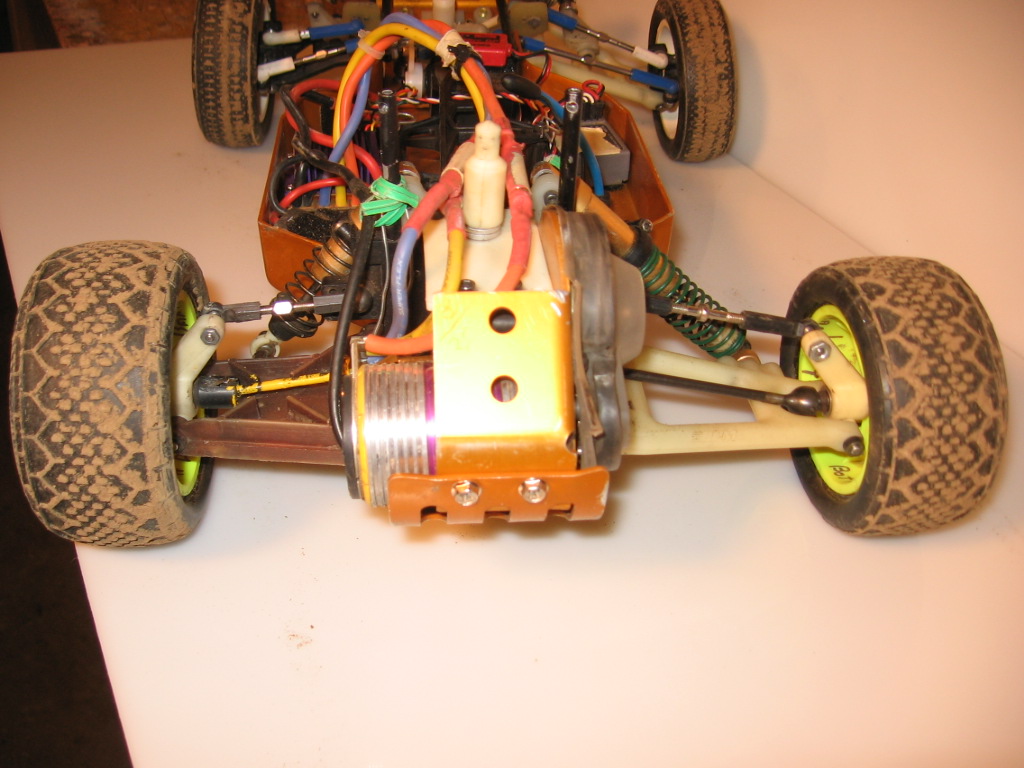

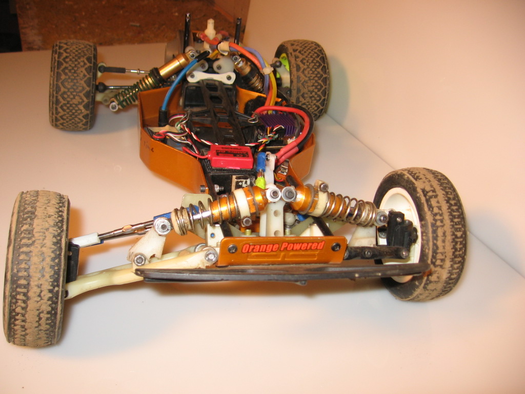

OK I finely rase up the right side rear. but did not run it for racing was over by the time I did it. ON Any sudjustions ?? It was one of those bad nights whear what ever you did nothing work.

The rear top shock mounts appear to be on the wrong sides.If on correct way would require shorter shocks for better rear end handling and better steering.Astiffer spring on left front and right rear helps too.Want way more left steer than right if only running Oval.Hope it helps ! THE other DON
Now that the pics loaded i see why!! Need to go back with buggy frontend not use truck arms,then the mccallister parts will help better.Steering parts cant work with that setup correctly.Makes it crazy out on the track,gets slack when turn and to tight when other side maxxes out.

OK NOW I am starting to understand. So your saying go back to the stock set up front and back and let the RC 10 arms go.? THEN add a stift spring front and rear? ONE thing I saw the camber and stearing arm that go to buld head was locking and the spring was not moving . I turn the caster onto the other side it seem to work but then started locking up.
THE oval of RC 10 racing is new . YES I can use all of the help I can get right now .. Thank you . Last night was a compleat wash out and like I said I spent more time corning and wrenching then racing. thank you so kindly.

OK NOW I have another question weight of oil would you sudjust and what springs. ? Should still use the lay down set up or go back compleatly to stock?

Use the mccallister parts and just use the rc10 buggy parts be it stock or aftermarket.Useing the rc10T parts are messin your setup way to much out of wack.As for shock oil im not sure i never changed mine i just used a stiffer shock spring on left front and right rear.Maybe a zero degree rear hub carrier or rear arm mount hinge block that holds rear arms to chassis.You try to get as much steering as can,but not so much it pushes into the turns.Look at some the sprinters on here to see if any info and parts you see might help you figure things out more.Don
