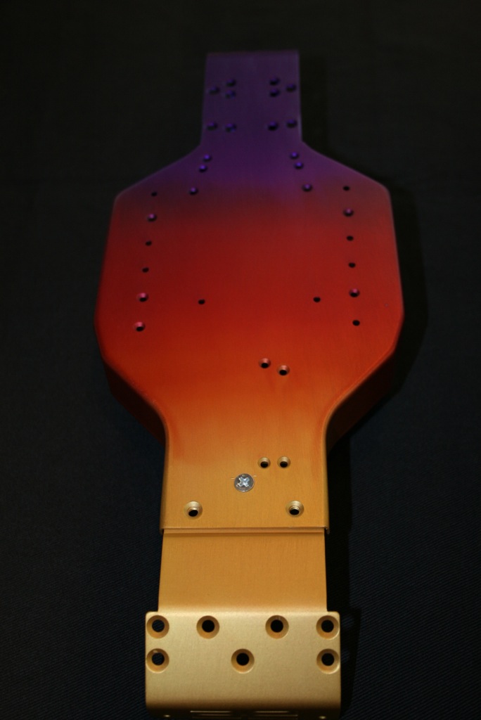

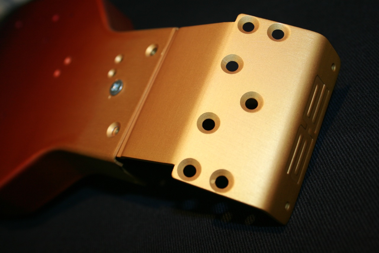

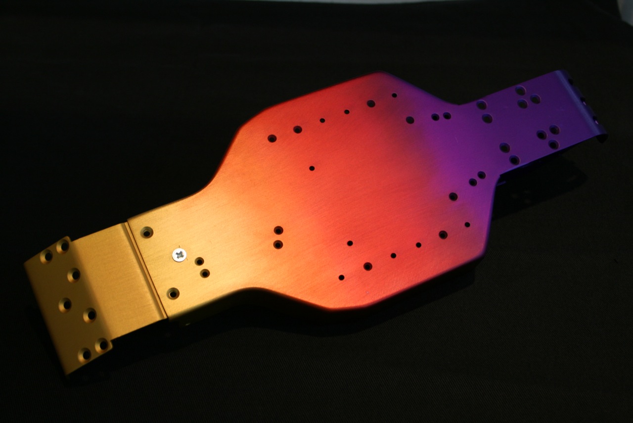

Well I tried this with the anodizing shop I normally use and it wasn't right. So I called around trying to find someone who could do this and finally found the place who said they could, and oh brother they were right. This is a very tricky thing to do with anodizing, but they were able to get exactly what i wanted. This is a keeper, I might make a small 9 piece run of these in the future, but if you think the others i have done are expensive, these are very pricey. I hope everyone enjoys the photos. Just got this in today. And really digging it.

The colors might show up better with a white back ground looks cool though

Unless these are done by Cannon process, then it is only a matter of dyeing in the correct order before the anno seals- shouldn't be too much more, unless you are getting the wrong end of the stick- But it looks nice!

Well seeing as if you put red over the purple it comes out dark and muddy, and you can't put red over the gold or it will come out orange, and to anodize it must be dipped . I think they use some liquid mask and it seems they have a lot more time and technique involved, seeing as 2 other companies could not do this process. And yes it is a lot more expensive. Do you have any suggestions on someone who can do this process? I am always looking for a better price, or do you do anodizing? Thanks for any help.

Check out places that do paintball marker anodizing. Amazing things can be done with aluminum from laser etching and digital camo to multi-color fades and drips. The prices usually aren't that bad either.

Depends on how the anodizing co performed the process on that chassis, they probably dyed/etched/dyed/etched/dyed the chassis instead of other processes. And as Dave mentioned
the paintball field has the most technology in multicolor anodizing- and if you can imagine a silkscreen process for the dye instead of an immersion method it is something along those lines, but
most anodizing places depend on volume, not creativity-
