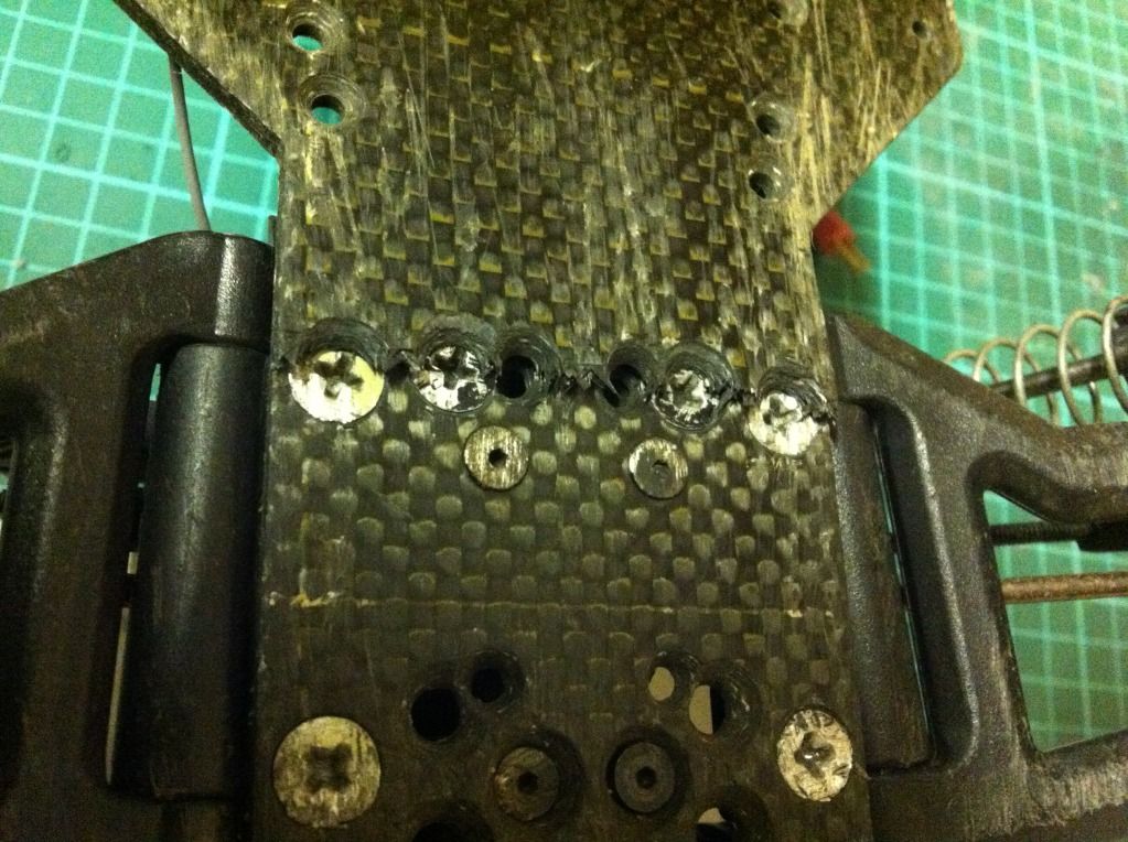

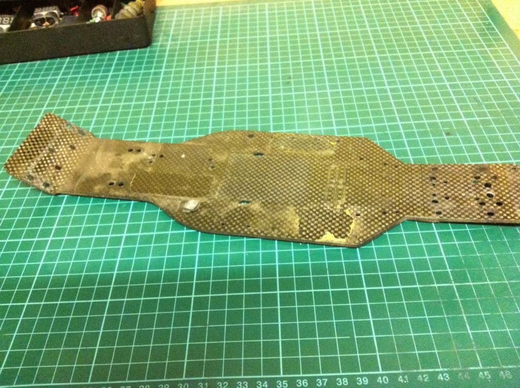

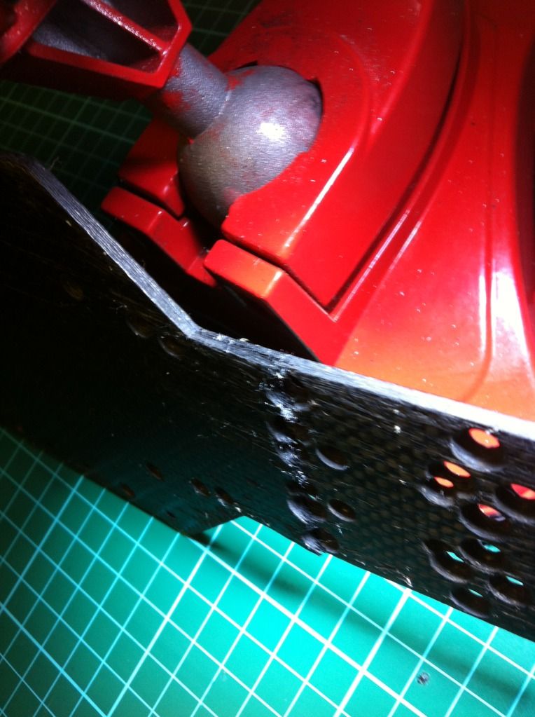

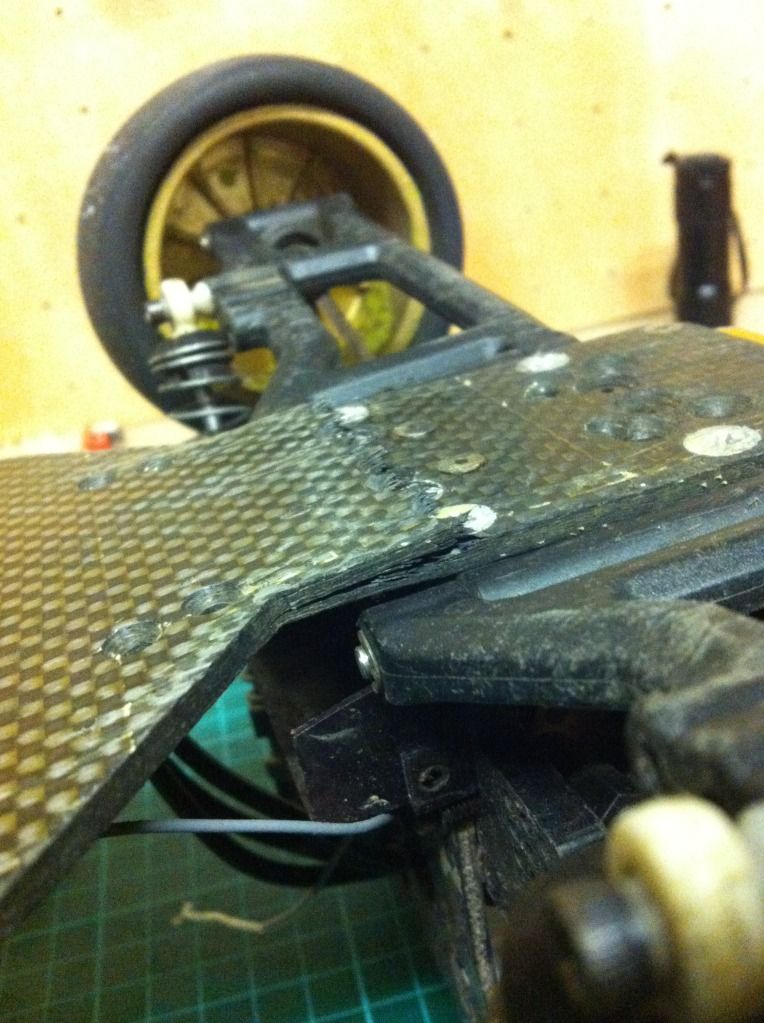

Here you go, ive just finished stripping it down and think it may be fixable as i have some carbon fiber cloth and 2 ton epoxy if i can inject some epoxy into the crack and clamp into a vice it might do the trick

Ouch!
Composite craft has my tub and others have sent in theirs as templates too- may be able to buy a brand new vintage chassis soon.
The epoxy may very well get you going again if you can clamp it up real good. Let us know!

Those "extra" Stealth holes did you in :?

Agreed on the extra stealth holes - not enough strength left in the small section between the screws. Were the extra holes for mid-mount motor placement?
Some have luck using CA to repair CF, but that's a pretty significant break. I've also heard of incompatibility of epoxies being a factor. Repair in the bike industry generally entails cutting out then re-laying up the critical area. Google around in the CF and boat building webites for repair techniques. I seem to recall some discussions on rctech.net as well?

RC10resto wrote:Those "extra" Stealth holes did you in :?
X2. Looks like it was a mid motored oval car once

I think I found the solution to this carck.
2mm thick carbon fibre plate under the chassis. Only in the rear will be perfect.

Thanks for the replies, I've used some CA and soaked the crack then clamped in a vice overnight, it's come out pretty good, I've also got 2mm carbon plate which I will use if it breaks again!

Better yet find a trashed gold pan and cut off the tail portion. Cut it off so you can pick up the rear bulkhead holes, and this will give you a rear bumper too. Take a belt sander to the front edge and give it a taper so it doesn't get hung up. The holes won't line up on the motor mount because it will be too low unless you bend the tail pan up to match.
EDIT I lied, you'd have to cut the pan off to try and pick up the speed controller servo holes, since that one is broken right through the bulkhead holes.

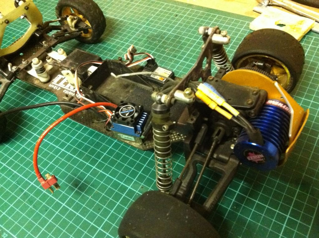

Mattwarner wrote:Image
what rear arms are those?

rpm "truck" arms (front and rear - not 10t).

Come on Joey even my blind ole A$$ saw that :shock: :mrgreen: says RPM
