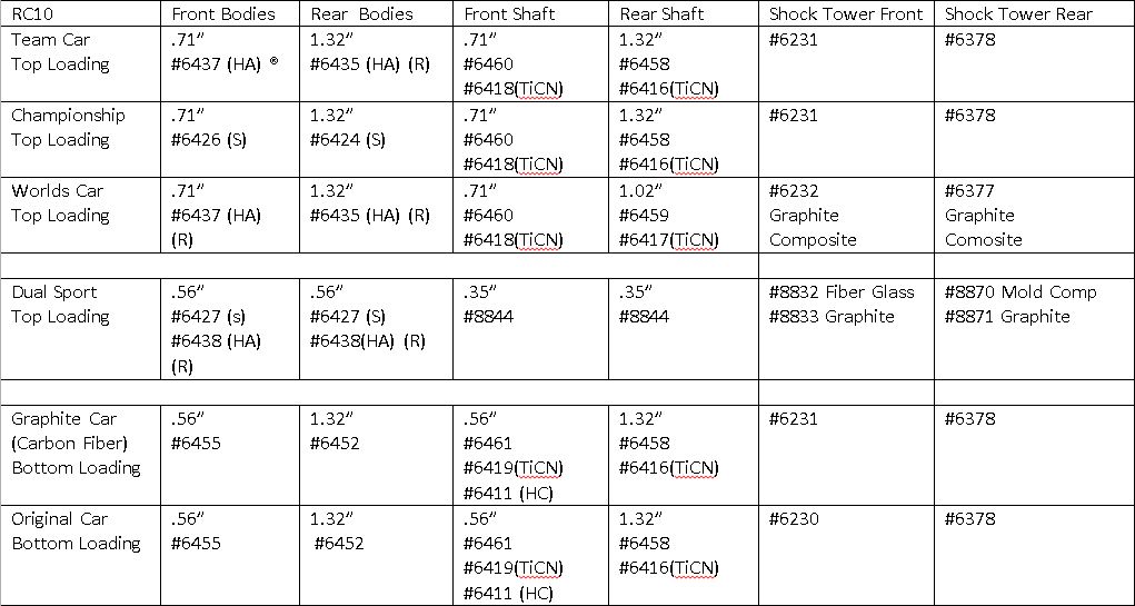

I started making this chart. If the more experienced members could modify it as they think it should be or let me know how to modify it that would be swell. I plane to measure actual overall shaft and body dimensions and plug them in to the chart to be able to have a list were we can easily identify what one has. If you want the original file just pm me. any feedback appreciated.
I still have yet to place the
1.02 Standard Bodies (6425)
1.02 Racing Bodies (6436)
.56 Standard Bodies (6427)
.56 Racing Bodies (6438)
1.02 Bottom Load Bodies (6453)
.71 Bottom Load Bodies (6454)
S = Standard
R = Racing (Hard Anodized, Grayish Green Shock Bodies)
HC = Hard Chromed
HA =Hard Anodized ( probably should pic this or R to simplify)
TiCN = Titanium Carbonitride Coated
S = Standard
HC = Hard Chromed
