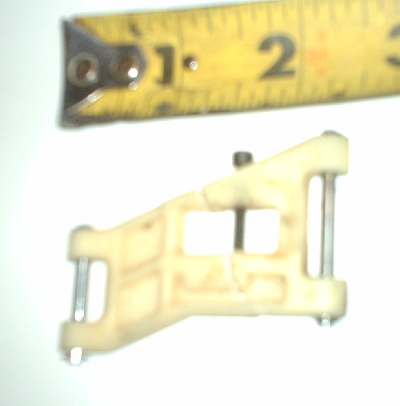

I've got a photo of the broken arm for you experts to compare. I've tried to upload the photo as an attachment. Not sure if it is there.

the tq10 is basically an rc10 with a graphite chassis. they were made and packaged by team associated and sold only through horizon hobbies.
the "RC" in rc10 actually stand for one of the founders of team associated, roger curtis (rc). the 10 would be the scale.
the tq10 came with both short (your first link) and long (second link) arms. if your car has the short ones, unless you want to get into purchasing longer turnbuckles, you'd be better of sticking with them. if it already has the long arms, then go with those.
one thing with those rpm arms, your lower shock rod end won't fit in that arm. the ball is too big. you'd be better off going with these:

Thanks for the advice on the short and long arms. So short arms are the default? I measured the length of the broken arm and it is just under 2.5 inches or approximately 6 cm. How does one insert an image into a post?

the short arms came on the early cars, wide arms on the late ones. you probably have the wide arms with that measurement.

I also did a more precise measurement of the arm length. Looks like 2 5/16 inches or 6 cm. I sent an email to Tower Hobbies to see if that length matches what they have.

or we can do it this way...the 6205 early or 6206 late are what it could have come with. both are available thru tower hobbies, ebay, etc
if its not one of those,it may be an RPM or Andys aftermarket arm- however its not likely as they rarely break!

In my first attempts to upload the photo I failed to notice the message at the top of the screen that the image was too large. So I've cropped it and should be viewable now.

thats a 6206, currently available only in black
as Scr8p said, you can purchase a RPM arm for greater durability, but you need the later style ball ends
arms: http://www3.towerhobbies.com/cgi-bin/wti0001p?&I=LXGAF4
ball ends: http://www3.towerhobbies.com/cgi-bin/wti0001p?&I=LXATKT&P=7

My photo definitely matches the later arms. Thanks for the great post. I'll order a set of the later arms tomorrow.gomachv wrote:or we can do it this way...the 6205 early or 6206 late are what it could have come with. both are available thru tower hobbies, ebay, etc

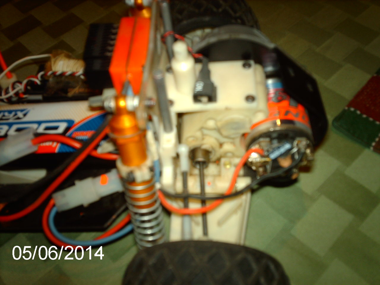

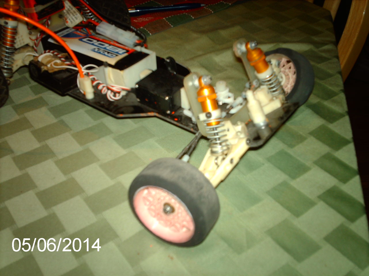

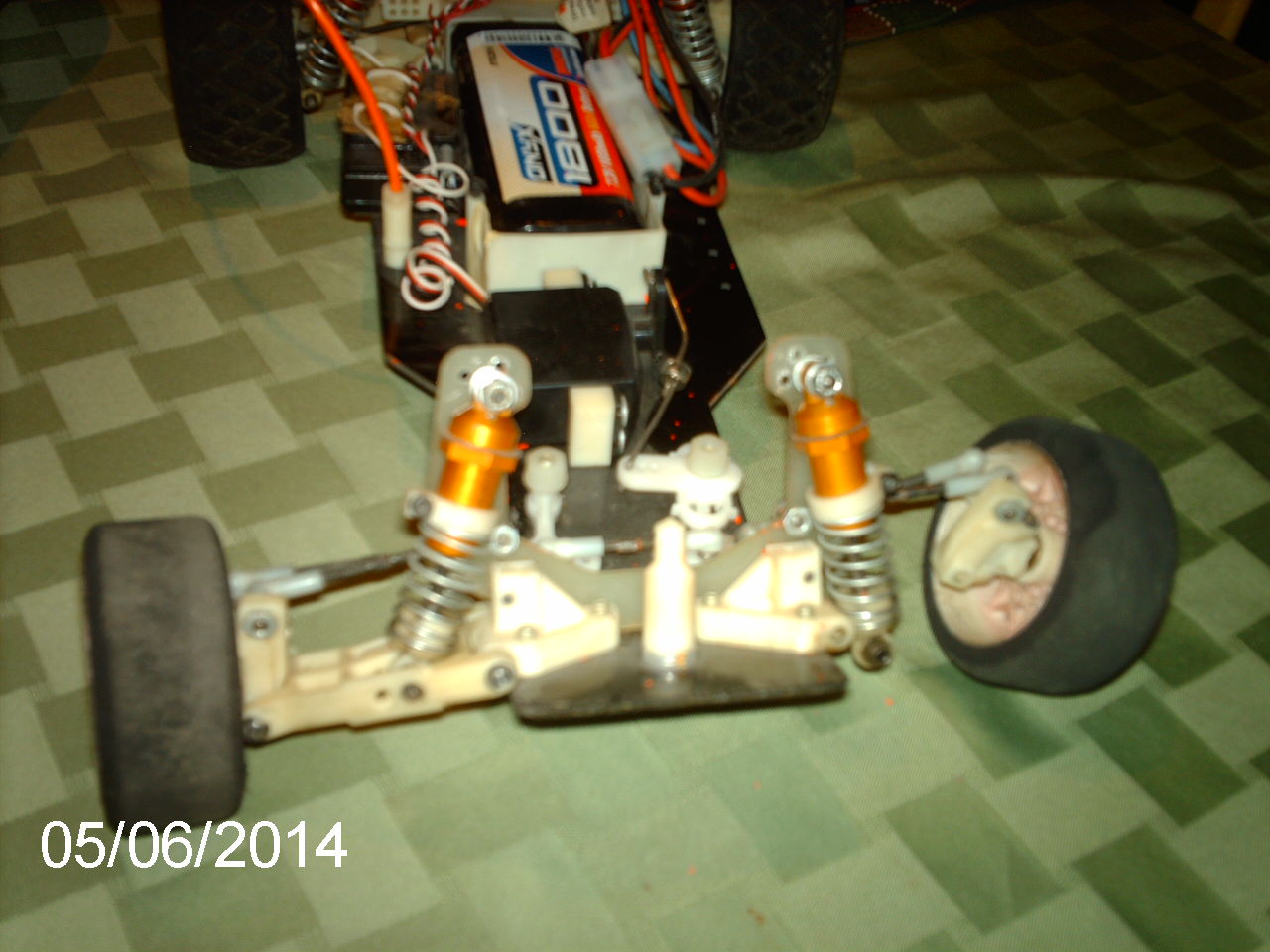

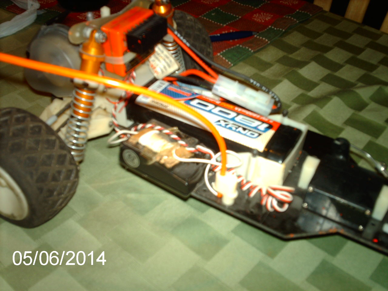

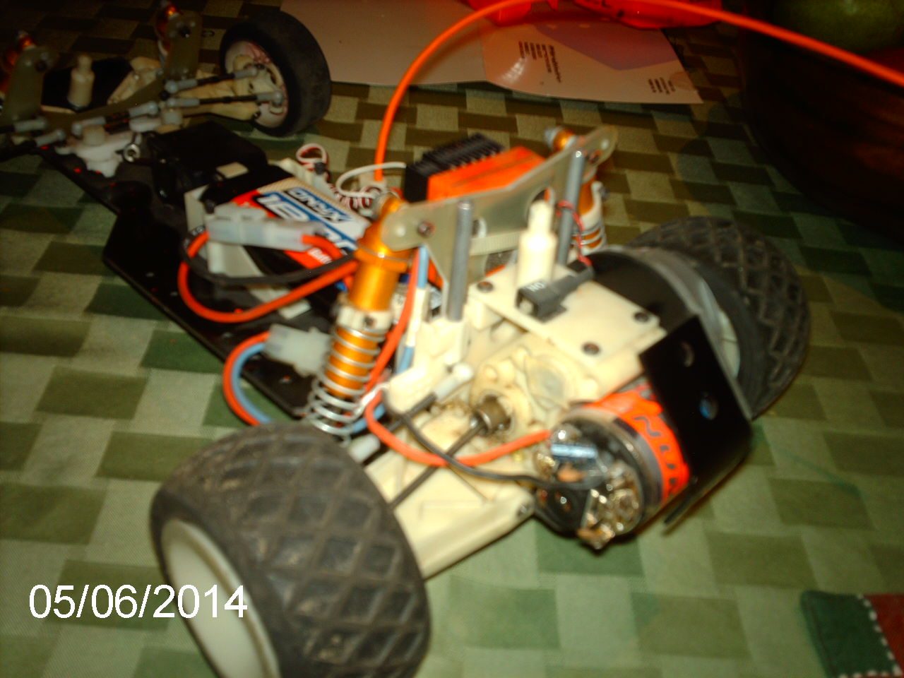

Took a five pictures of the TQ10 without the ugly orange body on it. Just wondering what you can tell me about the car from the pictures. Is it a rather standard setup?

Re: TQ10 Graphite
it's basically an original car, nothing fancy. looks to be in nice shape though.
the front tires are more of an on-road tire. but you can get newer wheels and tires that will fit to take it back to an off-road buggy. it really depends where your daughter is going to be running it (what kind of surface).

Re: TQ10 Graphite
If you need a manual, the RC10 Graphite is basically the same car. I think the TQ10 had a unique body but that was pretty much it.
http://www.teamassociated.com/pdf/cars_and_trucks/RC10/Team/graph_manual.pdf
I had one, my first new R/C car. Now I wish I never sold it 15+ years ago.
The only think it looks like it needs, besides a new front arm (and a 'proper' set of off-road tires and wheels), is a replacement battery strap.
http://www3.towerhobbies.com/cgi-bin/wti0001p?&I=LX2779&P=7
Associated has gone back and forth between white and black parts over the years. Sometimes improvements have been made to the nylon or the molds, but they are generally functionally identical.
