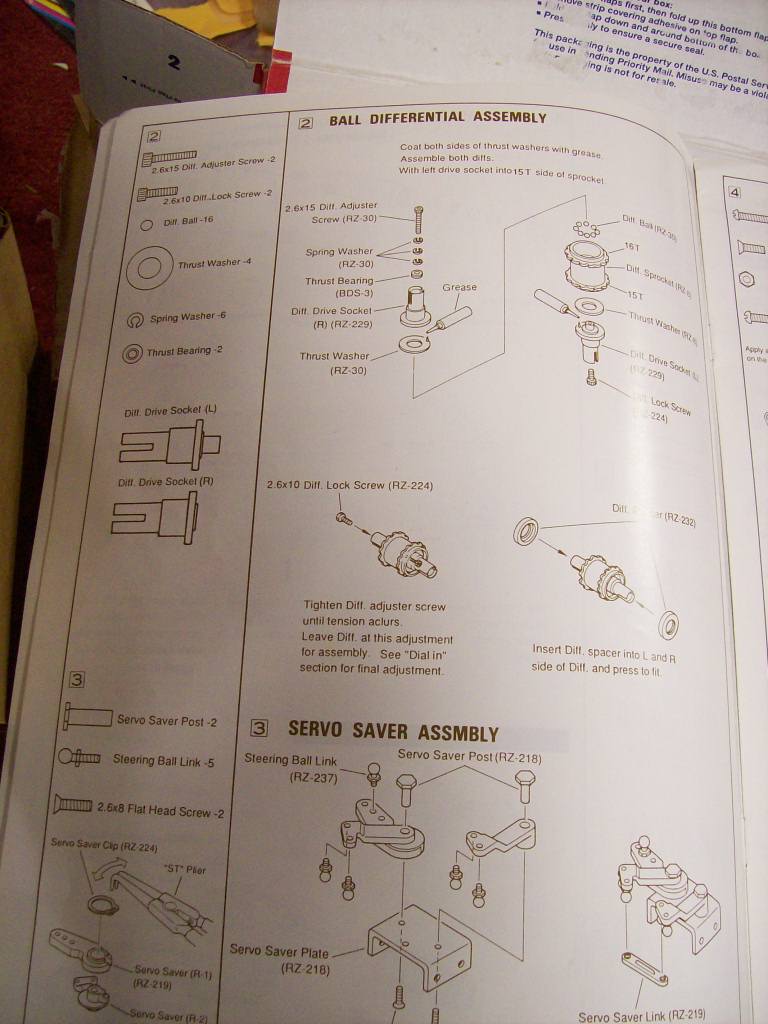

if you have the servo saver plate still in place in the car, then you are almost where you need to be.
you can modify bellcranks from a few different models and get something that will work, and just mount where the factory ones did. See this picture of the manual:

Re: AYK Radiant Steering Help Needed Please
The essential part needed is the RZ-218 aluminum plate as shown in the instructions above.
"RZ-14 IN THE RADIANT KIT".
Oh, I've got the plate on the one in the garage.
Not sure if the plate is with the second machine - it's in the attic somewhere.

I located the 2nd Radiant in the attic this morning, but that one does not have the plate - MIA.
The one in the garage does, so I'm interested in doing one at the moment.
I have not looked through my parts box yet, the second plate could still be around.
