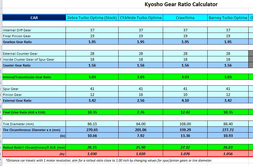

What size pinion do you guys think I should run with these tires? The tires are 108mm. I have a 12T pinion on order but I'm thinking it may not be small enough.

Returning_Jim wrote:What size pinion do you guys think I should run with these tires? The tires are 108mm. I have a 12T pinion on order but I'm thinking it may not be small enough.
I could probably help you calculate a "best guess" starting point pinion gear, but I'll need the Ultima's gearbox gear ratio and the diameter of your tires. Is the Ulty's gear ratio the same as the Optima? I created my own Rollout Ratio Calculator in Excel that should get you to within 10% of your theoretical optimal ratio.
EDIT: I just noticed you had your tire diameter. I'll punch some numbers and reply in a bit.
How many teeth is the Ultima spur gear?
EDIT: Nvm...looks like 41T. If that's incorrect or you're using an aftermarket spur gear, let me know.

Okay, sorry to be triple-posting...it appears that the Ultima has the same gear ratio as the Optima, 3.03:1, and the same stock spur gear, 41T. So factoring in the extra height in your tires, to have a rollout ratio comparable to stock--all else being equal, you could try either a 9 or 10T pinion gear. Either of those should put your rollout within 0.9 and 1.1".

Hey thanks for helping me out with that. Looks like I need to order another pinion.

Pick up both a 9T and 10T, maybe even an 11T, just to have all your bases covered. Pinions are cheap and usually available locally. For a crawler--and this is certainly not my area of expertise--you'll want a motor with high number of turns, like the other guys said...and probably I'd go so far as to suggest a sensored brushless setup, as unsensored setups sometimes suffer from cogging at low speeds. You shouldn't have that problem with a sensored motor & ESC.
