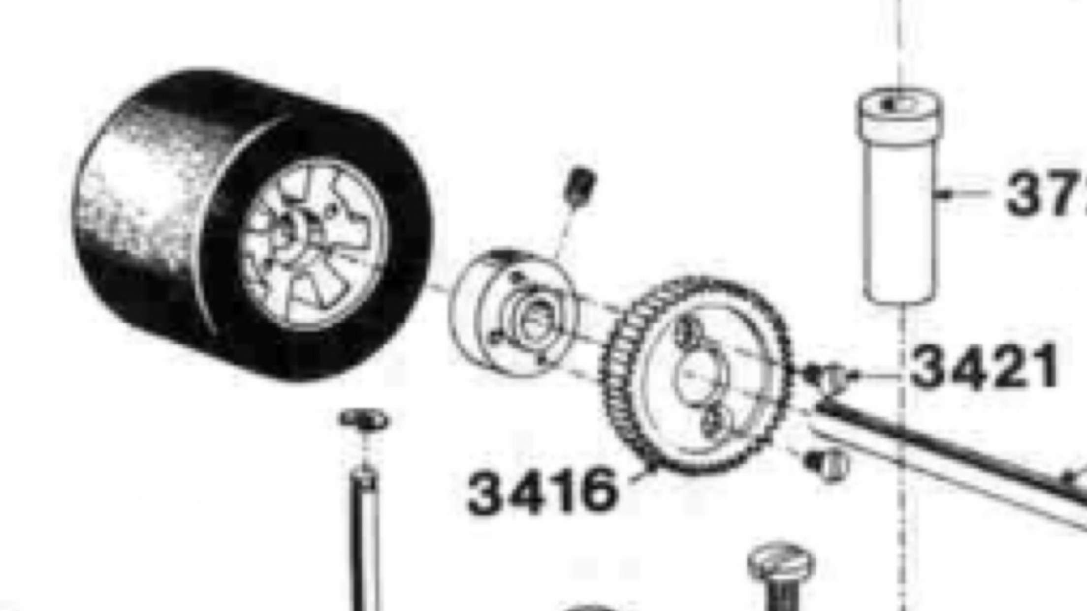

I have a set of lazer lite wheels
I want to use on my drag car.
I looking to find a gear mount that will bolt a gear directly to the axle. Does any body know of something that will work
Posts: 12242
Has thanked: 1101 times
Been thanked: 3780 times
Re: Spool rear axle for 10L
A 1/12 scale left side hub is perfect.
shodog
Posts: 3813
Location: Washington
Been thanked: 91 times
Post by shodog »

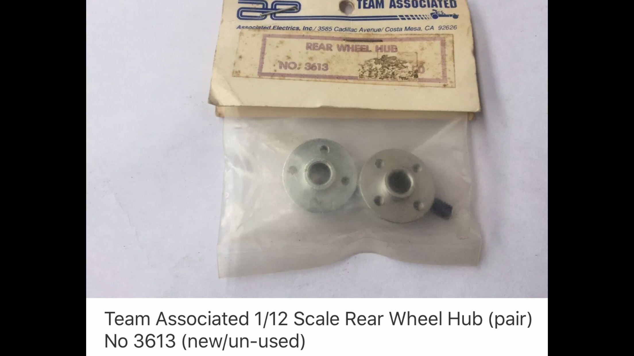

A gear can bolt to these hubs?
Posts: 12242
Yes, on the 12e cars they bolted a wheel to one side and a gear to the other. It's the standard spur pattern

Thanks for the help guys. I'm get one of those RC12 hubs if I don't already have one in my boxes.
RC10th
Posts: 4709
Has thanked: 50 times
Been thanked: 1506 times
Post by RC10th »
Surprisingly they aren't going cheap anymore
