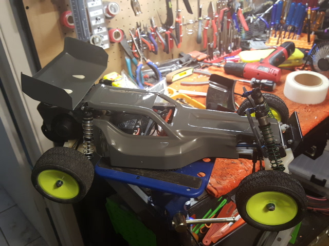

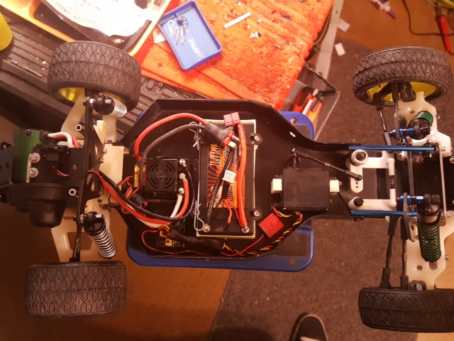

So a friend of mine asked me to get a 2wd vehicle so we could race at our local track. I responded that I only have, and drive, 4wd vehicles. A B64D, a Losi Ten SCTE, and a VERY highly modified 4x4 Slash. Then it occurred to me that I DO have a few 2wd vehicles, they're just older. So I've decided to try my hand at this car in novice. I have a vintage sticker kit coming for it. We'll see how she does. It has a Castle esc and motor, truck front end, Klein arms, stealth tranny, and the shorty battery mounted sideways further forward.

First... very nice looking buggy!
Second... what is the name of the color (and brand) of the paint used on the body? I dig it, gotta have it!

It's made by SEM, and is a vinyl auto/boat paint. Made for vinyl seats and such. You can find it on Amazon, along with other colors. They make at least 3 kinds of grey. One can will do a mix of like 6 buggy and truck bodies, so don't let the price scare you. This one is called "Ranger Gunmetal Grey".

it does sound odd to say... but that is a sharp looking shade of grey for sure.
And great looking ride in general.

looks pretty sweet. It looks like you are running the truck bellcranks up there? You might want to change them out to buggy (shorter) versions, as many guys ditched the truck ones on the trucks since they end up being 'twitchy' compared to the buggy length.

I'll have to look into the buggy bellcrank setup. It used to be a 10T, hence the truck front end parts.
