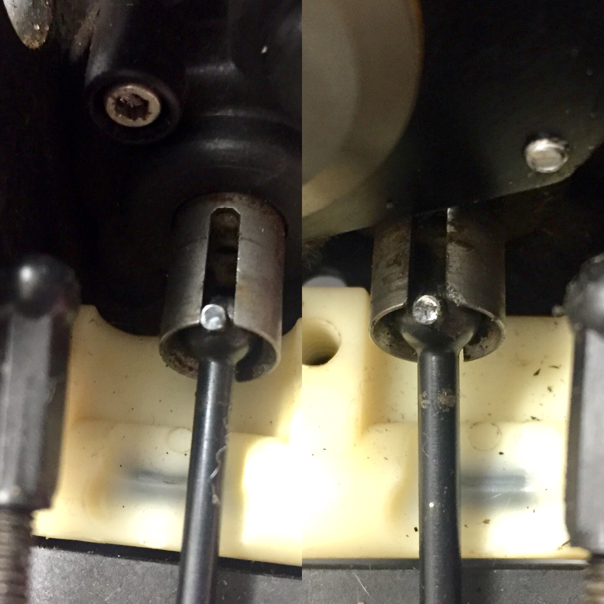

I also found 9911 axles from local seller, they have 3 in stock. Are they really needed? I have already spent way too much on these.

I had to take a look on my worlds car driveshafts and they seem to have the same issue, on the spur side even more so. Is this even worse with rerelease parts? Could this be fixed with limiting schock movement (is it called droop)?

If you are going to race or run on a bumpy track your going to need to change the drive shafts to 9911. Reducing the droop helps,but you need some droop to land jumps properly without bottoming out.
The worlds car is probably not shimmed right. The cars with the universal joints came with about eight 1/4" shims you need to place two on each side of the axle. (Fig 98 in the manual)
