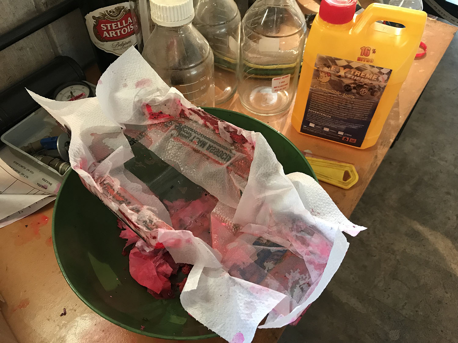

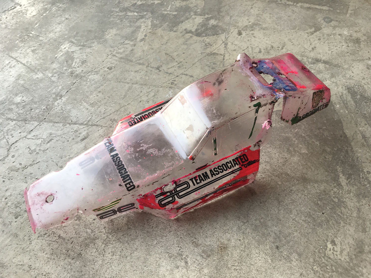

I have been trying to remove the paint off of an old body. I tried some old DOT 4 brake fluid with no luck. Maybe it was too old and had lost it's properties.
I then tried 16% nitro fuel which, relatively easily, removed most of the paint from the body. However, there are some stubborn areas (and an area which seems to have been painted with some sort of pen) which I haven't been able to remove yet.
I've been at it, on and off, for about three weeks now. I didn't paint this body, so I can't say what paint was used. I'm planning on one more sitting focusing on these remaining spots, and if that doesn't do it, I'll paint the exterior.
By no means a simple chore in my experience.
Here's the body before I started working on it:
Here's the process:
And here's about where I'm at today (I'm a little further along actually):
Here's the process:
