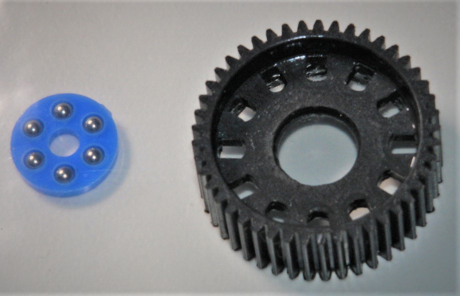

The 6 gear is a quite poor candidate for a slipper.
If a slipper was added at the Spur gear location…
There would be no independent adjustment of the slipper vs the only other portion of the trans that could perform the task of a differential.
That task would now fall on the tiny 6627 diff thrust bearing. If compared to a modern diff, there is no room inside a 6gear to fit an adequate ball or gear diff.
The original 6gear ball diff functions mainly as a differential but as a “slipper” as well.
It can also have a tendency to act as a “posi” when centrifugal force at high rpm throws the ball outward.
The main trouble is metal on metal, wearing the balls and drive rings. Even the newer ball diffs, if slippage occurs (barking), the rings and balls could use a rebuild to keep it smooth.
Pic is stealth spur vs RC10 thrust
Chuck
