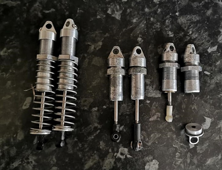

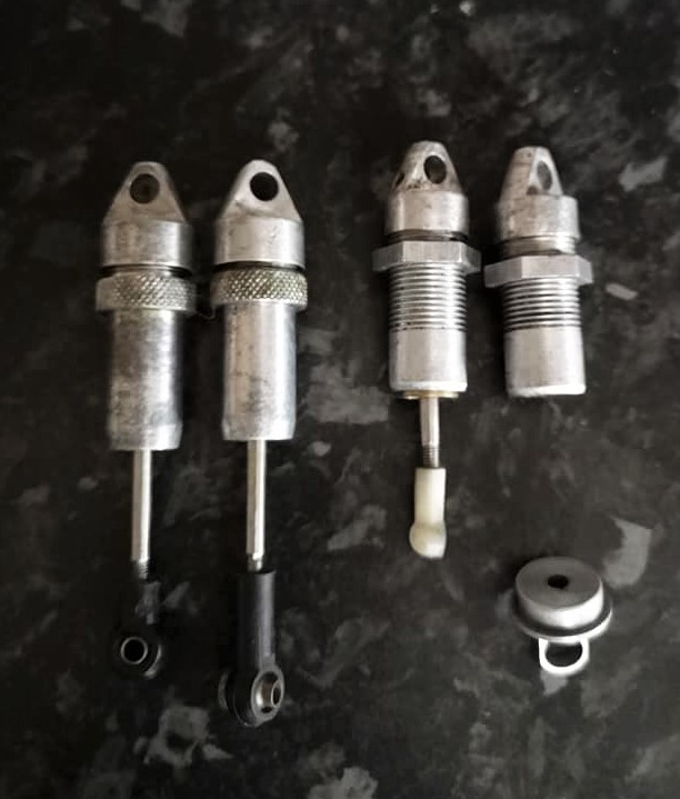

There have been several posts about the box art shocks and also the press car shocks for the original SWB CAT, with questions over the shocks which appeared to be unthreaded Brimod items.

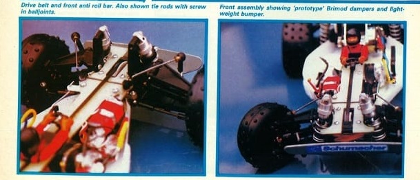

I had heard that Brimod did indeed make unthreaded shocks in their early days, but had never actually seen a pair. I have also found a mag review from July/August '86 on the new 'Schumacher CAT' which actually references the new 'prototype Brimod shocks.'
Yesterday I managed to purchase 3 pairs of Brimods, all of which were a slightly different spec, but it was the centre pair in the below picture which were the most interesting.
They are identical to the CAT boxart shocks, same upper ring, no body threading and even a slightly increased taper at the lower end of the shock body when compared to the later threaded variant. I grabbed a pic off another thread discussing these very shocks for a comparison.
Pretty cool to finally find a pair of these protoype versions 8)
Once these have arrived i will strip and restore them all and then probably put a thread together detailing all of the models, a timeline and their differences.

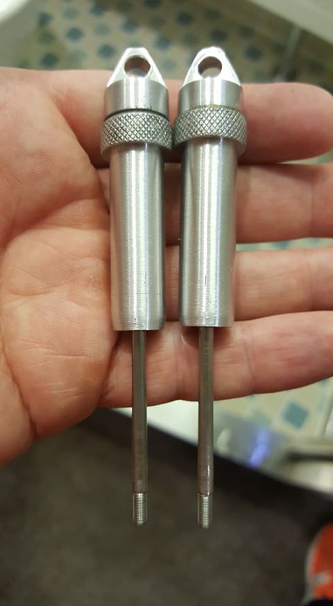

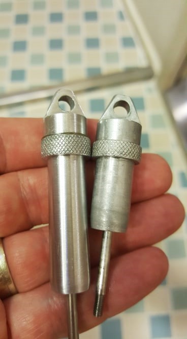

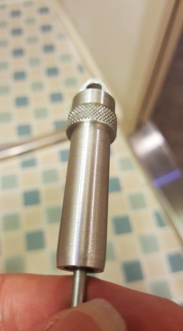

So a little more good fortune has come my way..... following on from my lucky purchase of the elusive front prototype Brimod shocks for the 'boxart' swb CAT, I have now managed to get my hands on the matching rears. In fact, i uncovered a complete set of four shocks so actually have 2 pairs of these fronts now.
The rears are unusual in that they have a slightly deeper knurled ring at the top compared to the fronts, and another quick look at the boxart car confirms that this was indeed the case on there also. I was slightly surprised to discover that the ring is actually turned from the same piece of metal as the shock body itself rather than being a screw-on addition. My guess it that the original intention was to use it for grip whilst tightening down the upper cap, before subsequently being threaded and being used for the spring tension adjustment also.
I have already started to polish one of the rears up with some rough emery paper, and will go finer before a final polish, but you can already see they are going to come up really well. The second rear is jammed up solid so will need stripping to inspect and free it off.
The rarest version of some of the rarest shocks out there 8)

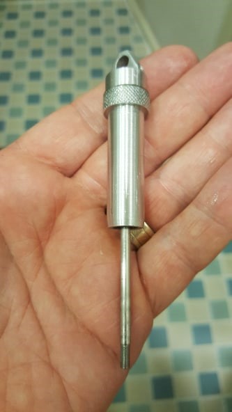

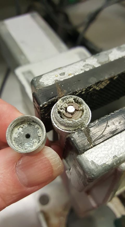

Well, i managed to coax the cap off the jammed rear shocker... took a bit of brute force but i can now see what the issue was. Dry as a bone in there and has obviously not moved or contained any oil whatsoever in a long long time. There was a bit of furring up and corrosion holding the piston solid, but a little clean out and a rub over with some fine emery and all is good. Two functioning rears :D

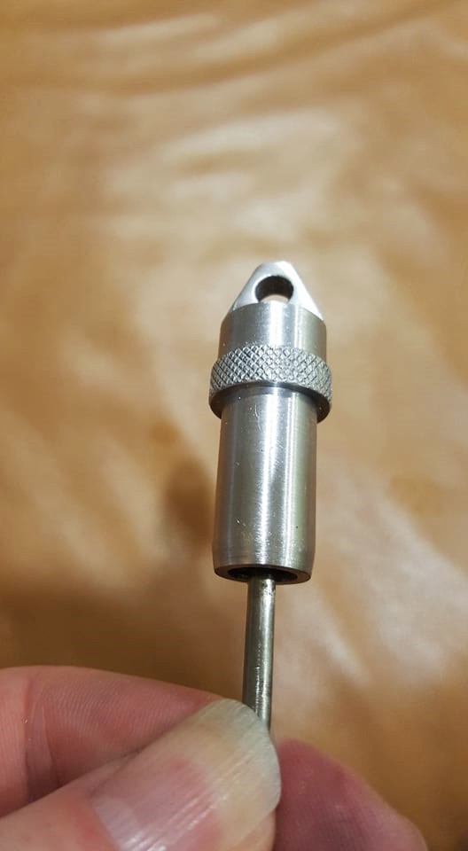

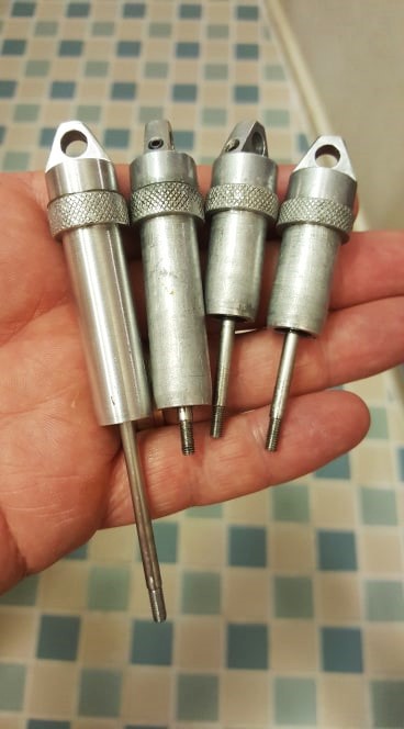

One front cleaned up too now. This one still had oil in it and a good upper sealing ring also.

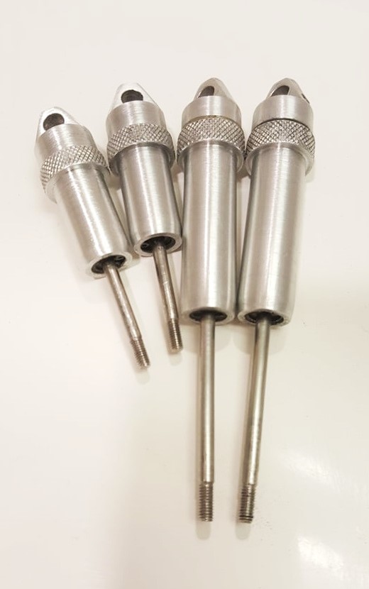

All four. Came up really nicely in the end :D

That one had oil in it as i put some in to see if it still sealed, then drained it 😉
