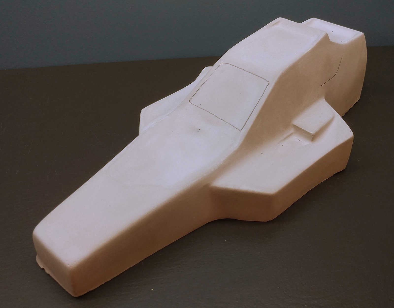

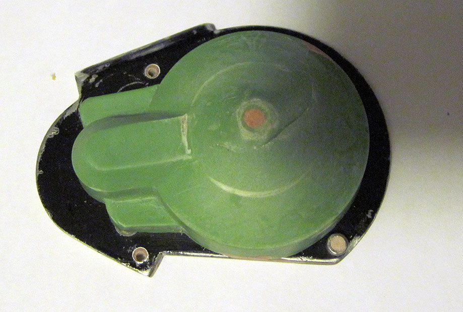

I don't know exactly what the pros use, but here's my materials experience in vacuum forming...
Thermo/vacuum forming requires a rigid, tough material with a low coefficient of thermal expansion, as well as the ability to withstand cyclical 400F+ temperatures. As polycarbonate cools and shrinks, it grips like a vise and really puts a lot of stress on the buck. Also, when you back pour a body or a mold to create a buck, you want the copy to shrink as little as possible to not lose even more of the original body's dimensions. So, concrete type materials can work. I have successfully used Ultracal 30 (https://plaster.com/product/usg-ultracal-30/) to back pour existing bodies. The resulting bucks have great detail reproduction, but are a little fragile and hard to drill with "helper" holes in the corners and tough to form areas. It works well, but I wouldn't expect to make a lot of copies. I've had better luck with a high temp resin. This one is specifically made for vacuum forming: https://www.alumilite.com/resins/vac-master-25/ It's very expensive; you can end up with hundreds of dollars in material to create a buck from a 1:10th scale body, so I mostly used it for smaller parts like gear covers and wings.
For non-repro parts, machined aluminum works very well. Wood also works well; it just needs a lot of sanding to get the grain out. I've used pine with a clearcoat on it. I imagine hardwoods would be better.
Ultracal 30 Back Pour
Vac-Master 25 + Aluminum + a little Bondo
