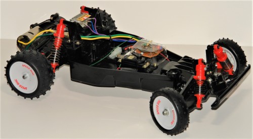

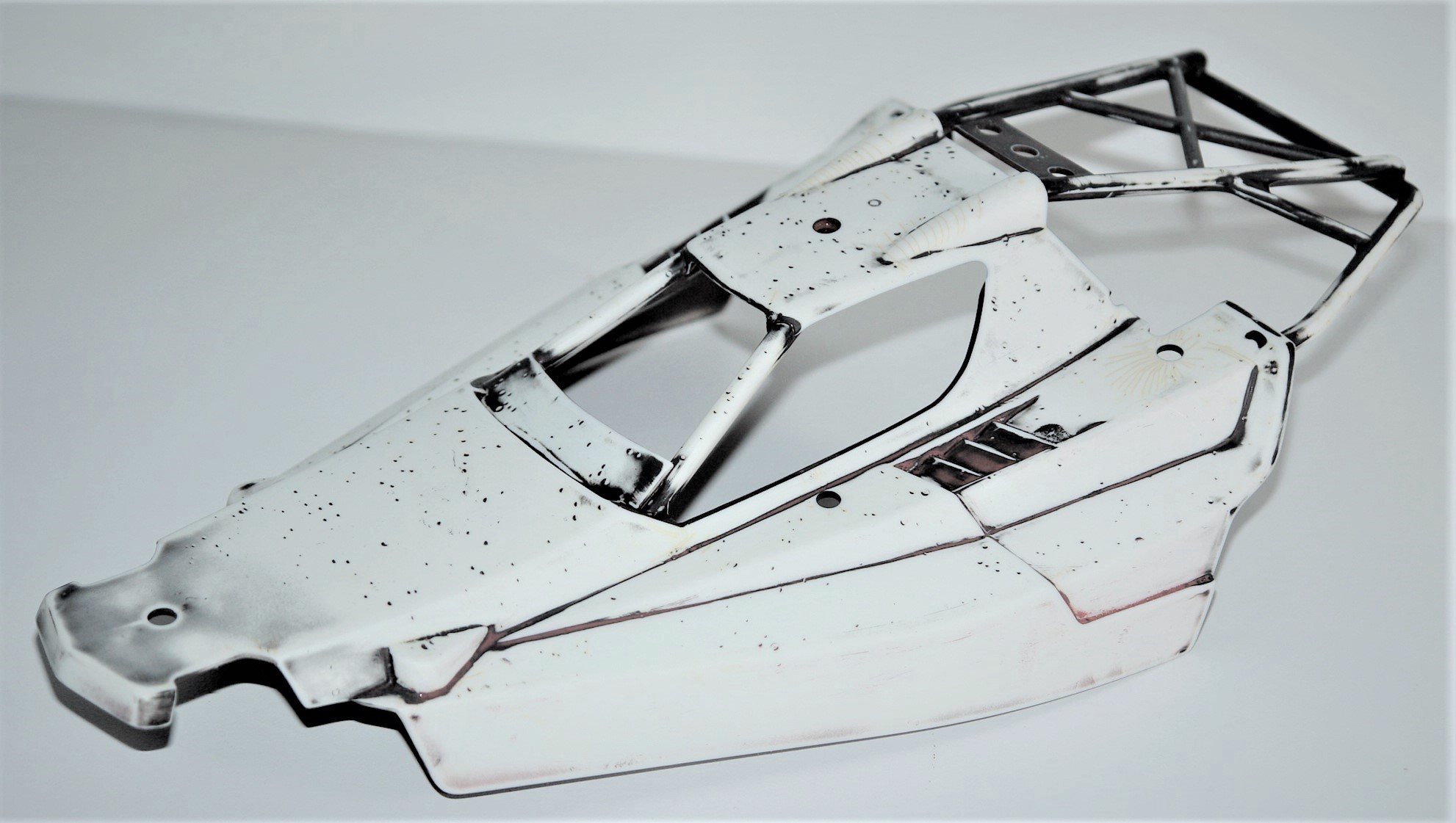

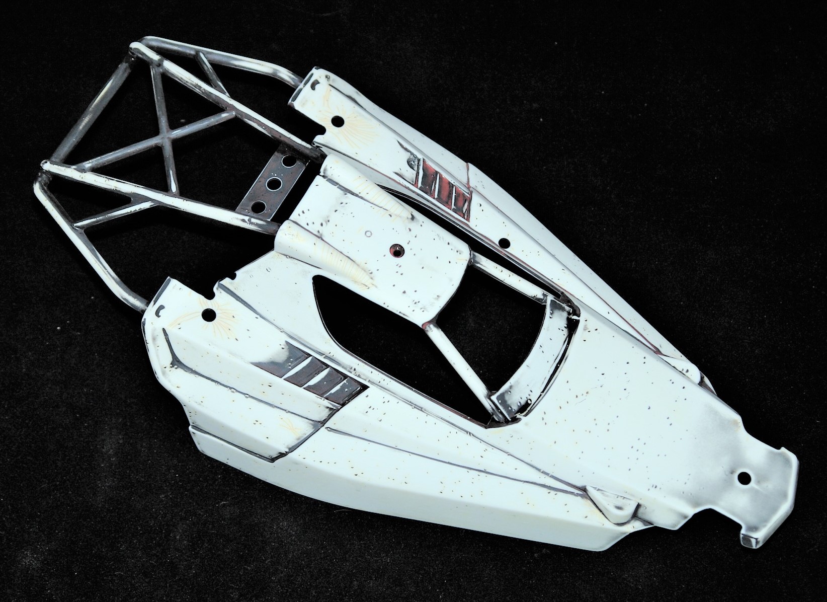

I got this as a "mystery" auction item purchased by the wife. :D
Been cleaning, sanding, painting, sanding, painting and trimming decals for a while.
Turning out pretty nice if I do say so.

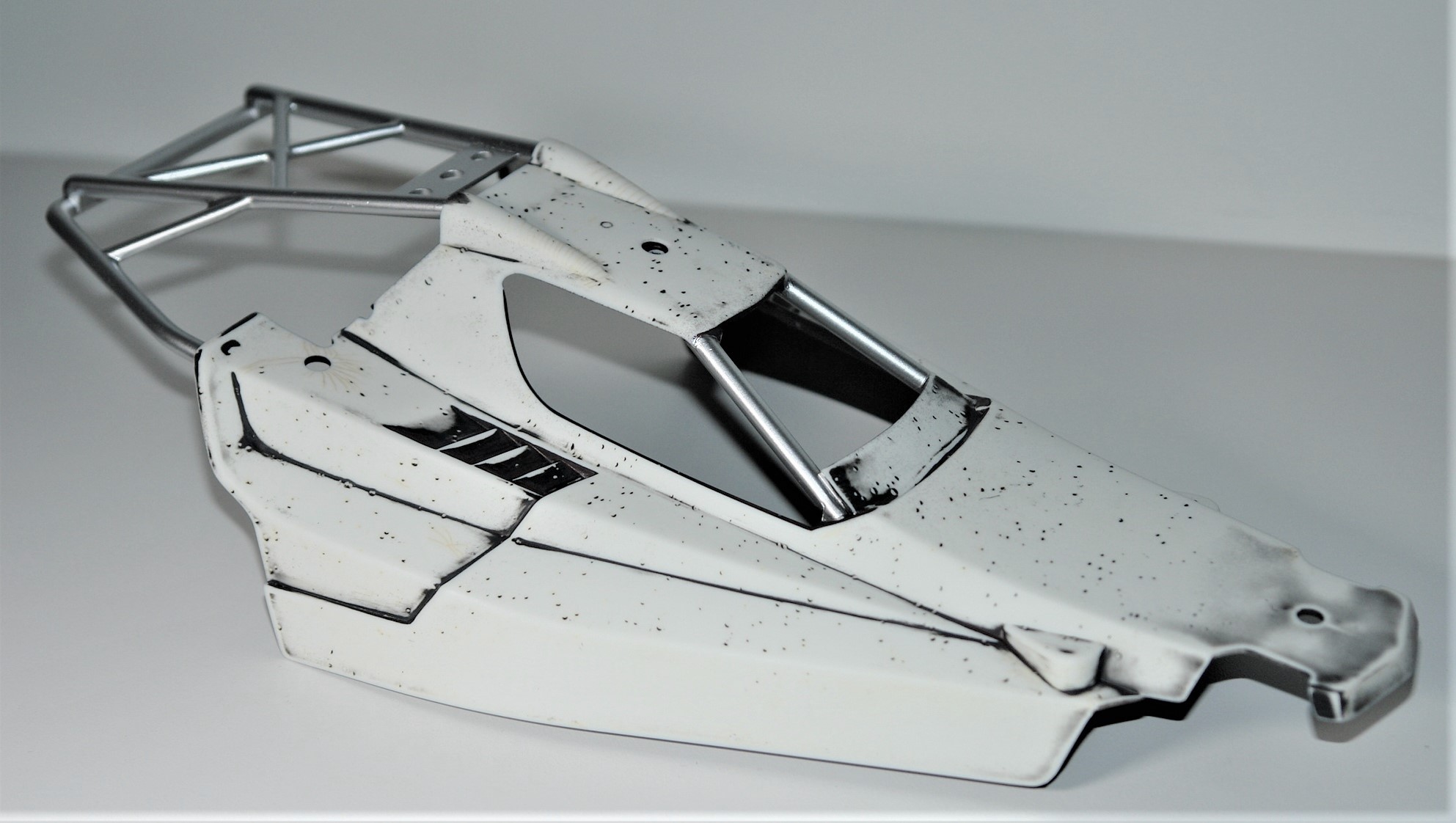

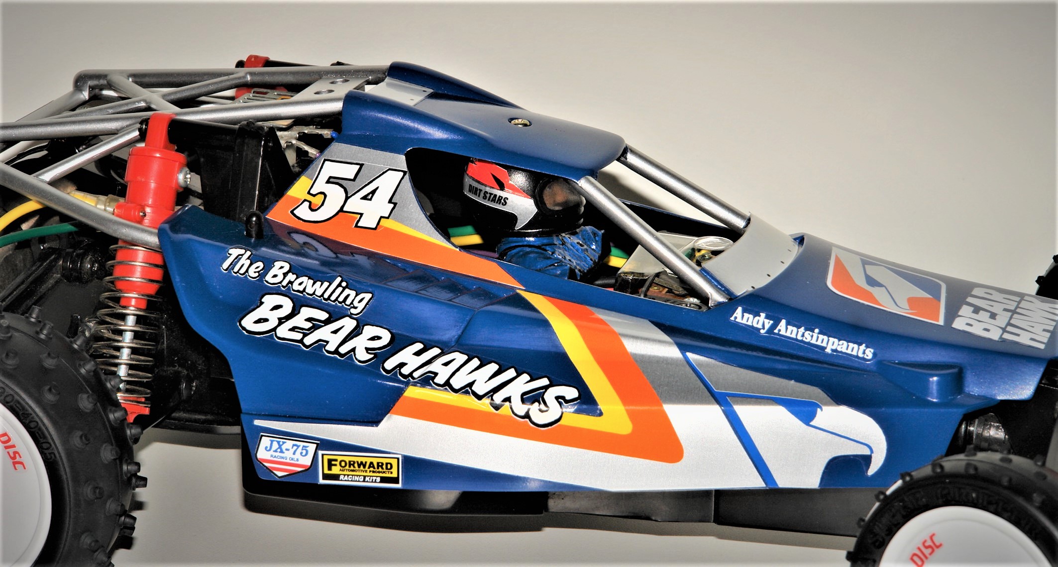

She was in pretty bad shape paint-wise. Lots of runs. Really thick.
I went with box art Tamiya TS-15 Blue lacquer and MCI decals.
Kind of surprised that the decals were available.
Front wheels were painted as well. Chucked them into a drill and sanded, then polished.
New rear wheels as the originals were HPI.

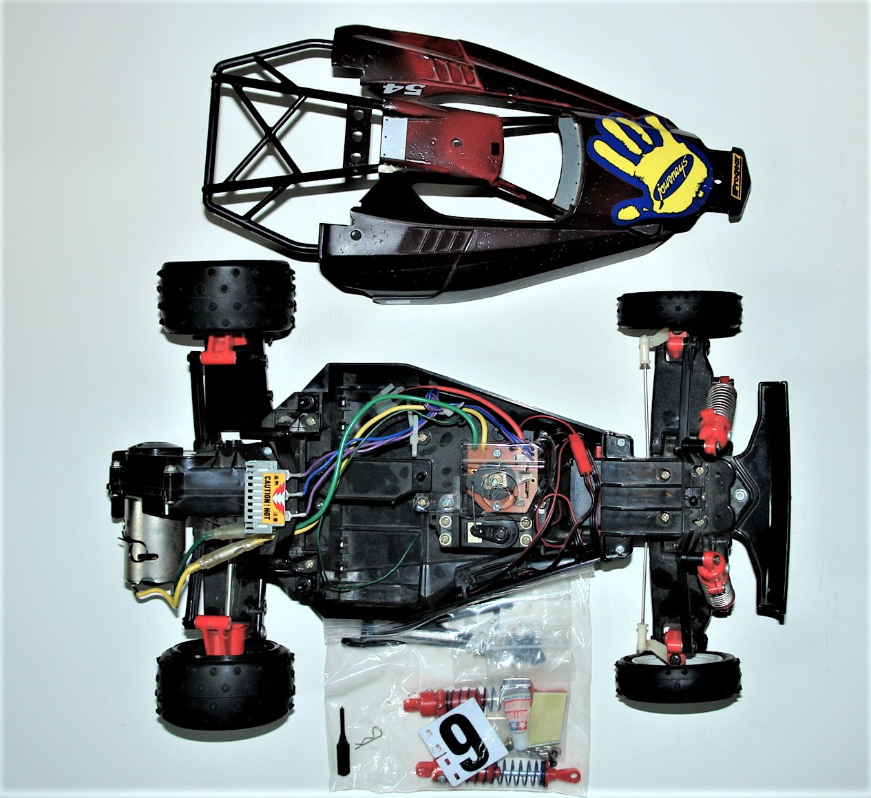

Well the ugliest part of the car was the body.
Thought I'd start there and see if if it could be salvaged. I think it looks pretty good, at least a whole lot better.
So I'll probably keep going forward.
Really need to tear it down a thoroughly inspect everything as this was a pig-in-a-poke.
Also going to keep it as OEM as I can. Maybe throw in some new bearings, 5mm id rubber tubing for the friction shocks and I've been on the hunt for proper tires.
Mechanical speed control will go if I get it to a decent running state. I do have a period correct Tamiya ESC.
Got a couple balls up in the air now and I suck at juggling :D

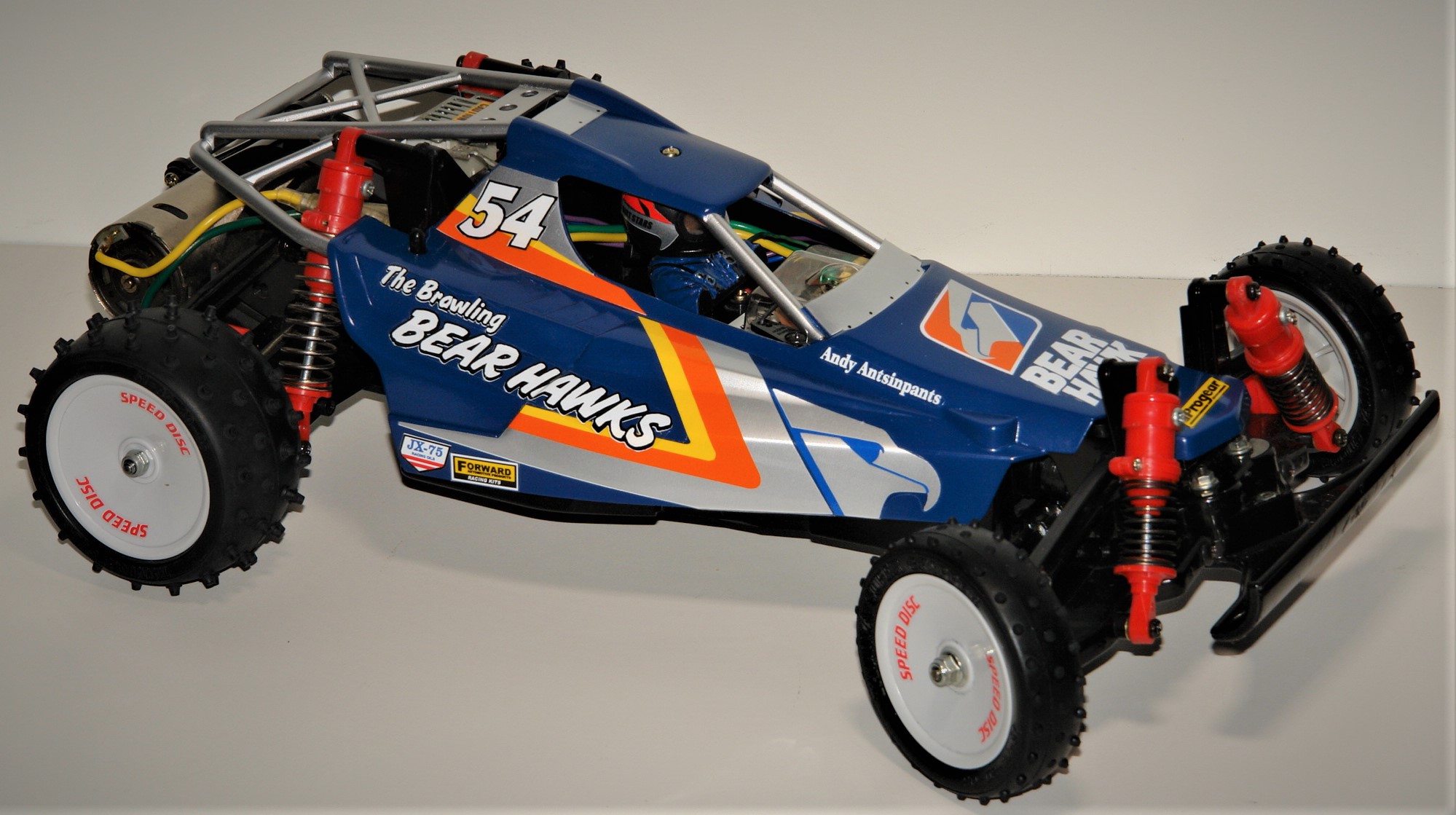

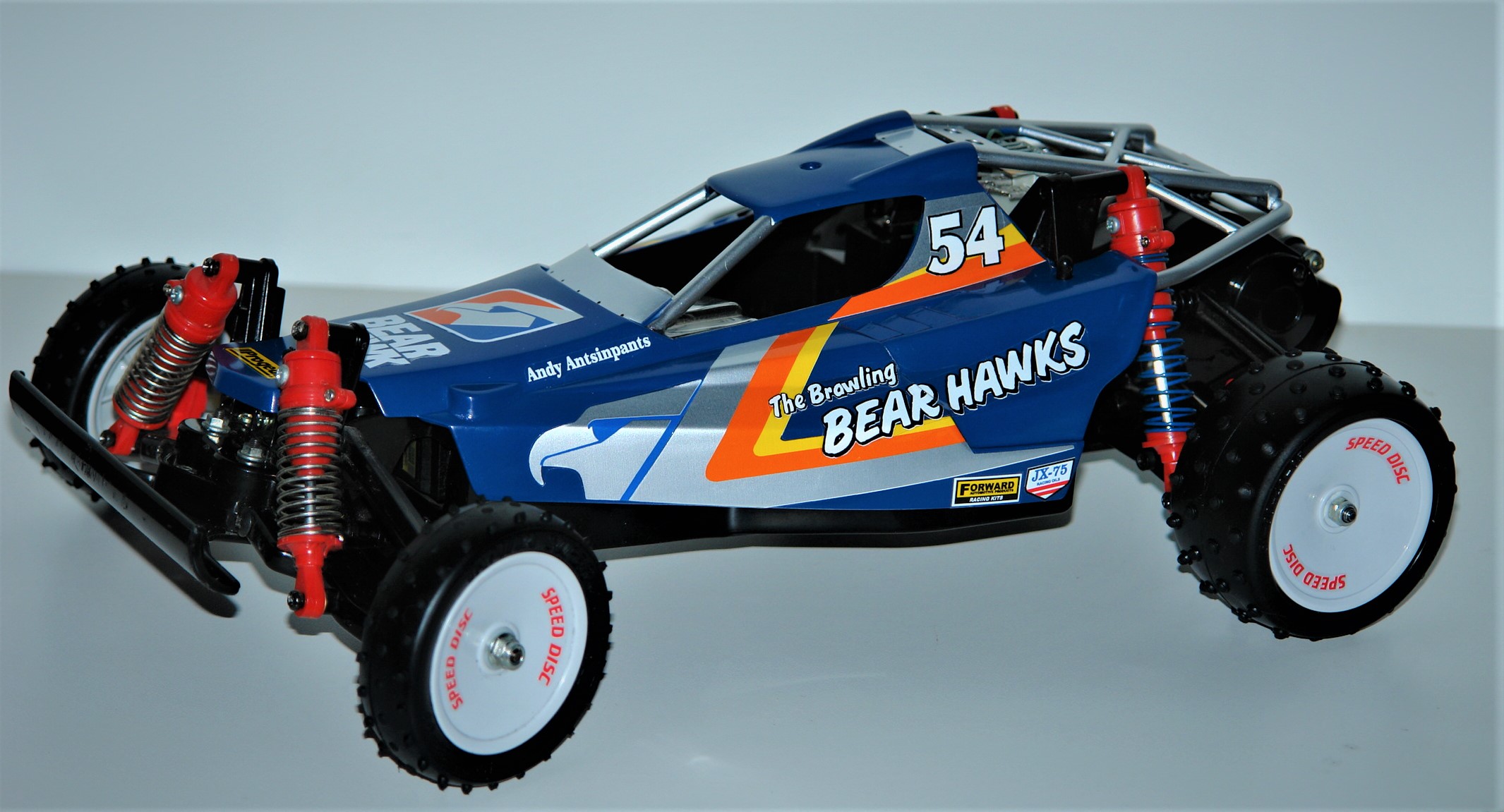

A little bit of finishing up.
Full clean up and wiring reroute.
New pair of correct rear tires for the new rear wheels. Still can't find new front tires but these aren't too bad.
Rebuilt shocks with new silicone 5mm X 9mm hose. Changed the springs as the springs that were on it were both non-original and way too stiff.
The silicone tubing actually doesn't do a bad job of "damping" the shocks. Much better than just non-damping pogo sticks.
Painted driver figure.
Took it for a spin outside and it runs and steers OK.
Up on a shelf now
