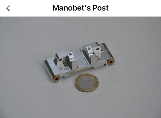

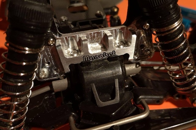

Manobet on Facebook seems to do exactly this type of very low volume custom work. You would probably need to come to him with a design in mind.

I came across his facebook site just this week. His work looks top notch and that transmission brace is a nice thoughtful touch. He might be promising thanks.
