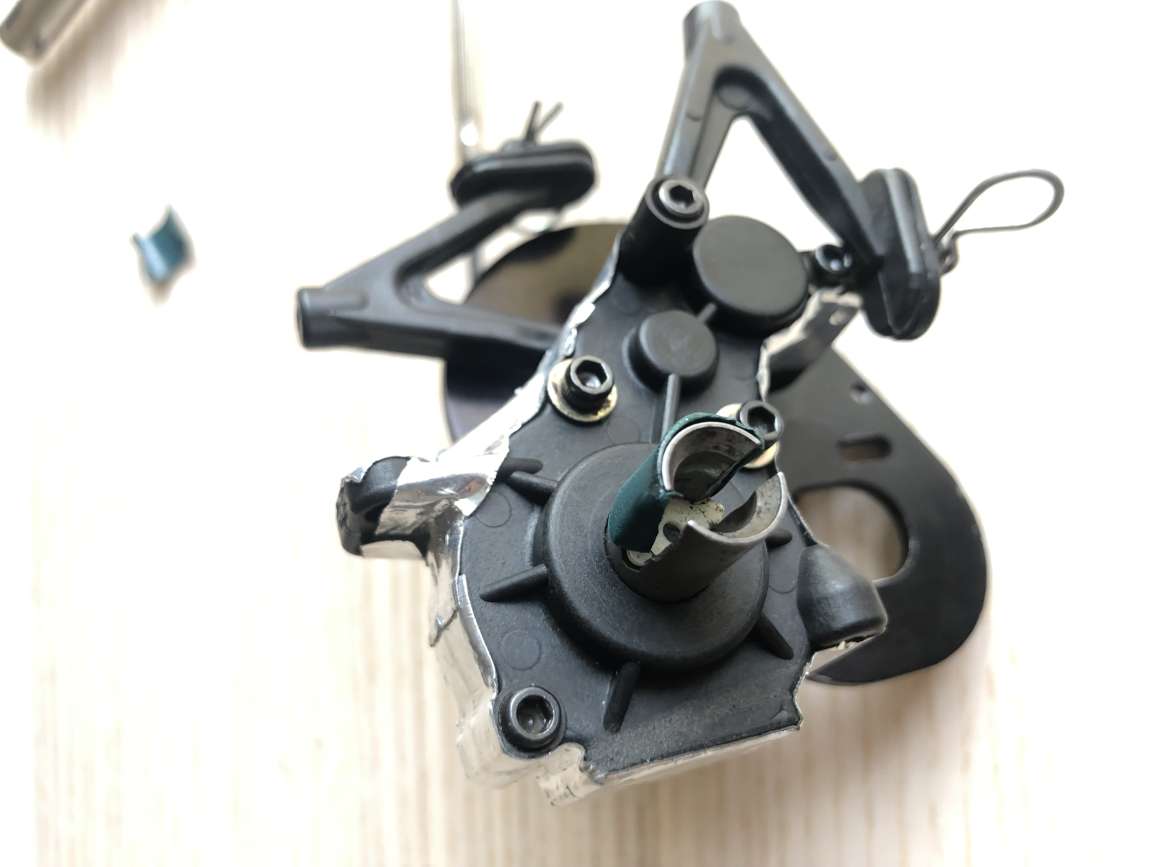

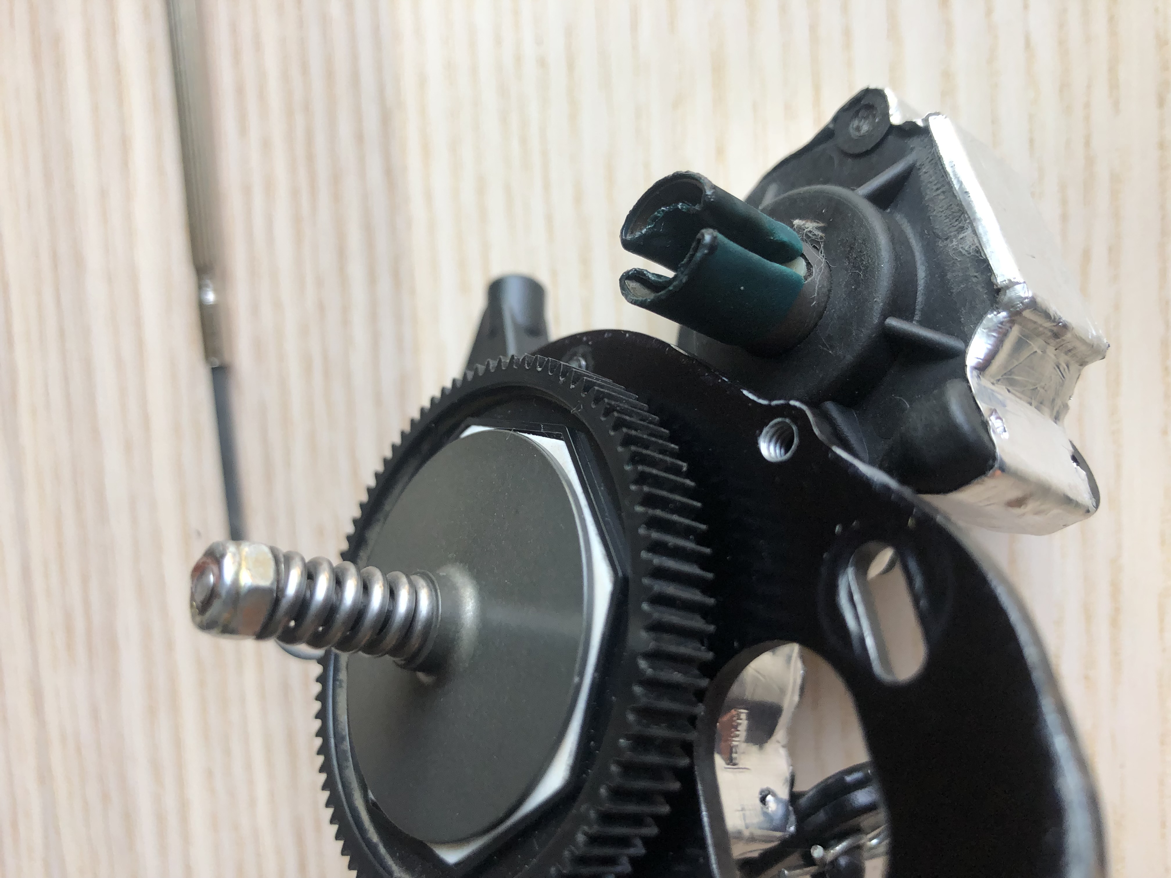

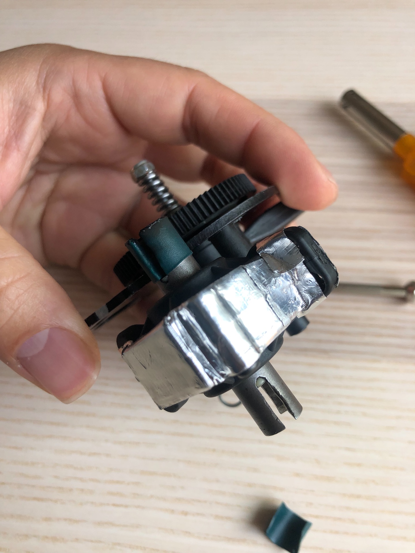

I have too much play in the metal cup (what is the name?) where my dogbone comes out of the diff as shown below.
I don't want to buy a new part and throw away what I have. I wonder if there is a creative fix for this problem.
I tried to be MacGyver, and heated up shrink tubing so as to reduce the play where the dogbone enters. I think my solution is not a good one lol. What can I do, that is cost-effective to fix this issue? Thank you for any suggestions!

You mean the gap for the drive pin is worn so the pin is a sloppy fit?
I have several cars with the same problem and I just live with it. I used to believe that the pin was made from a softer material than the drive cups so it became a sacrificial part but now I don't think that's always true in every case.
If it's any consolation, I have some that are much worse than yours and they still function.
You might want to adjust the ride height so the bone is level leaving the drive cup - this will reduce wear.
I also swap drive cups left to right during routine maintenance for my gear diff cars. Probably some things you've already considered.

So if you're the earlier B4, that should be 7667 and 7668 replacement outdrives. If you're the later B4 with the metric outdrive bearings, it should be the 9852 outdrive set... if you change your mind and are willing to get replacement parts.

Thank you for the suggestion. It's half satisfying but appreciated nonetheless! But you did diagnose my problem or rather the wear problem on the drive cup. I'm not sure why having all that wear gap irritates me, I even tried to sauder the dog bone pins, but that doesn't work, or my iron isn't good enough lol.

My T3 gearbox had blue aluminum outdrives that were worn and sloppy. The CVD dogbones had plastic sleeved steel pins. I replaced the outdrives with OEM steel parts and the worn plastic sleeves with brass pins. Eventually I ended up with new condition, all steel parts. The brass pins also didn't hold up. There's no shame in replacing worn out parts. It's more satisfying to have proper fitting, smooth operating parts. Also, using worn parts can lead to accelerated wear to other parts.

Measure the OD of the drive and get a small length of brass or aluminum pipe you can tightly fit over the outdrive. Use a dremel to slot it just enough to allow for free movement of the dogbone. That might help out.

In the end, for now, I decided to just change my mind on the play in the pins and drive cups as you recommended. Change of mind, means I have no problem
The plastic shrink wrap was not effective and small changes created other issues (resistance) in the drivetrain.
