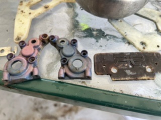

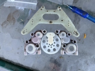

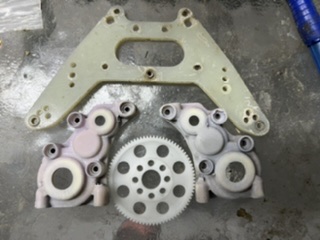

Now that it’s not 105+ in my ‘workshop’ I got back to this.
The results are mixed but positive.
This is where I am in the process
This is where I started.
The pictures have mixed brightness. The shock tower is the same in both pictures.The before picture is much brighter. In person the before was very dark and saturated.
The rit dye remover works well as long as the part was not black.
I think that I have been using a much too small pot for this process. I think the more water in the pot, the more dye is removed. Each time the water came out tinted.
The part looks very improved, but it feels ‘chalky’
I this process won’t get the part oem white but it looks better and could be dyed a lighter color.

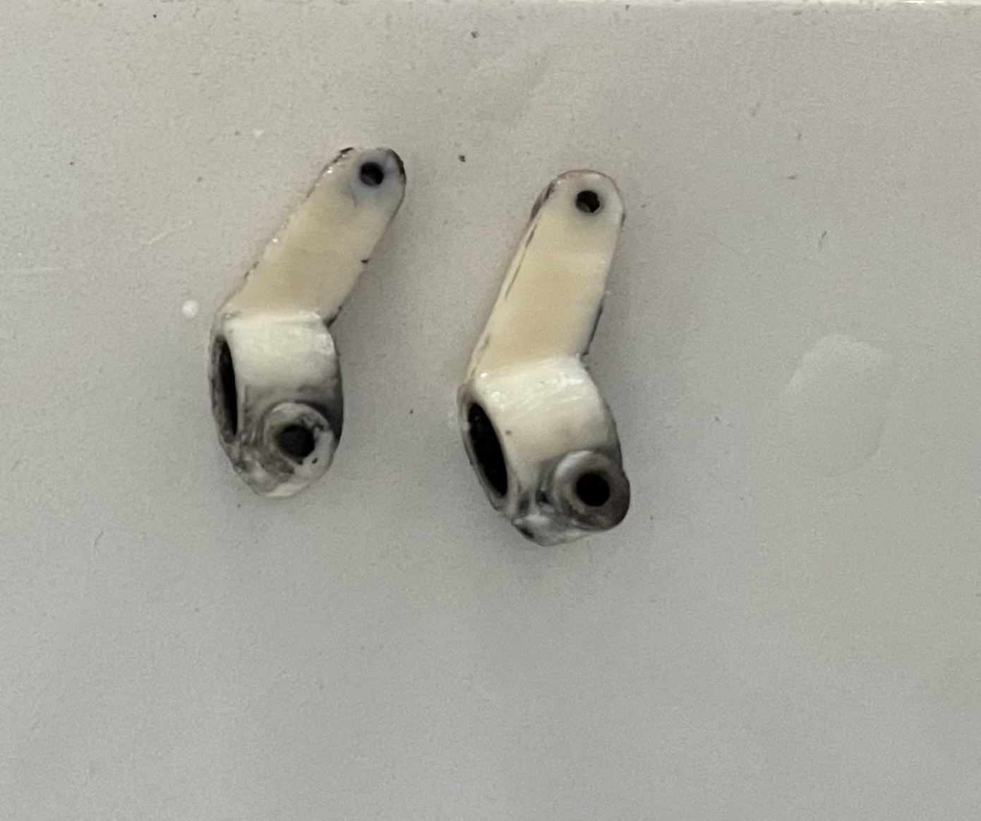

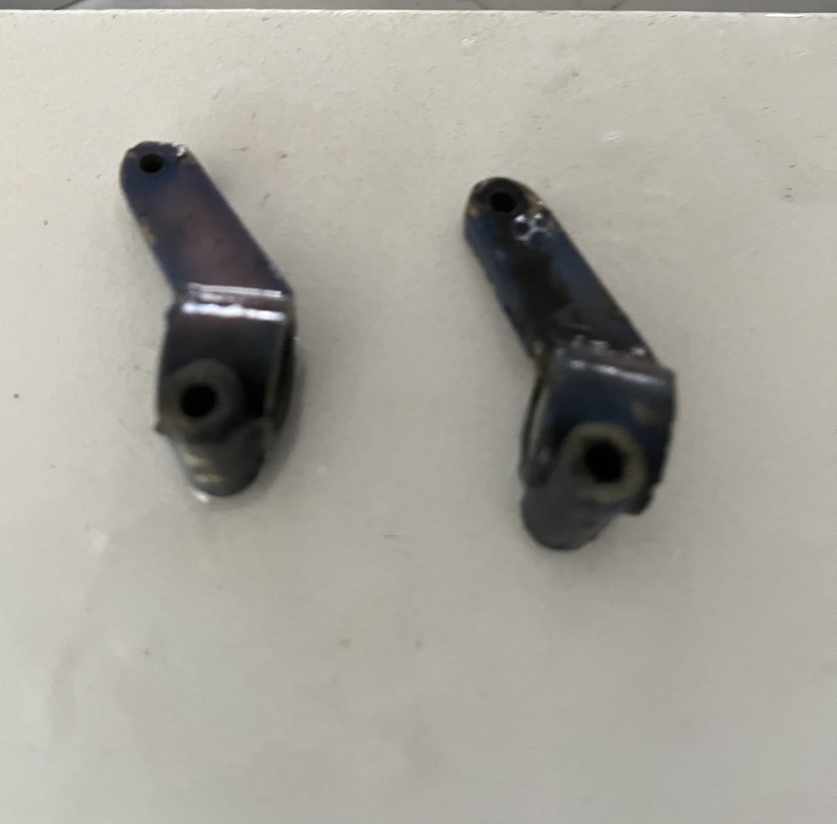

I learned a bit but was surprised by how good the results came out for the most recent try.
I used a whole 3 quarts of water and half a box of dye remover for just these two parts. I boiled for about an hour. This is the first try on this and it’s better than I had expected.
Right now I took the water from boiling and the parts and added it to 5 gallons of water for a soak. I am hoping that with some more time and lots of water to diffuse into the dye will fade more

threesheds wrote: Mon Oct 03, 2022 4:55 am I always think white looks more "plastic" than other colours? Reminiscent of nylon. How much water!!! for two steering horns. We've got a drought and hose pipe ban here (UK)
But if that's your pref ga
These actually look the correct nylon white for associated . This batch came out much more correct than the other 2 from the same car.
The water came from runoff capture and doesn't go away when I'm done. It's going to go on the garden.
