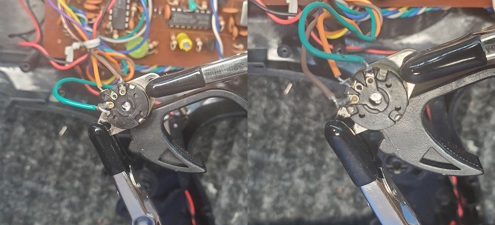

I am trying to wrap up my Sledgehammer, and have run into a snag. The Traxxas 2201 Tx does not have St and Th reversing switches, and my XL-1 ESC is interpreting forward as reverse, and vice versa. I could reverse motor wires, but I don't know if the XL-1 will go full throttle in reverse (doesn't seem as powerful in reverse), and it will still show the red led while going forward and that will bother me.

It should do the trick but you can also open up the transmitter and flip the two outer wires on the throttle pot. Just depends on your comfort level but it’s super easy

GoMachV wrote: Sat May 21, 2022 2:52 pm It should do the trick but you can also open up the transmitter and flip the two outer wires on the throttle pot. Just depends on your comfort level but it’s super easy
Well, one of those options involves taking things apart ................ so that is the clear winner! :D

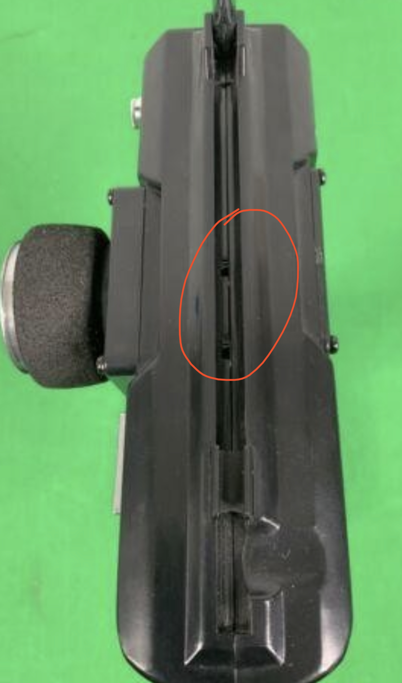

My memory is fuzzy on that transmitter but under the area where the antenna goes for storage- isn’t there a piece of plastic tape that covers switches?

GoMachV wrote: Sat May 21, 2022 3:08 pm My memory is fuzzy on that transmitter but under the area where the antenna goes for storage- isn’t there a piece of plastic tape that covers switches?
WOW! You are completely correct! There are switches under there! :shock:
Oh well, the pot got re-wired anyway. :D Thanks for the help Jeff!
