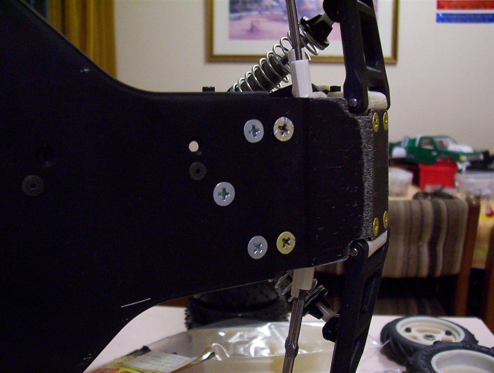

Hi Guys,
Here are some pics,
Cheers, Dave.

That looks like a nice clean truck dave, the white is pretty crisp. I take it you only use it as a light runner? I love those tires but they're discontinued.
I can't wait to get my GT runner up and going.

Yep just a light runner, laps of the street in front of my house, I have been slowly taking the good
white bits off for another project. The only original parts are the front bulkhead, front body mount
brace, shock ends and bumper.
