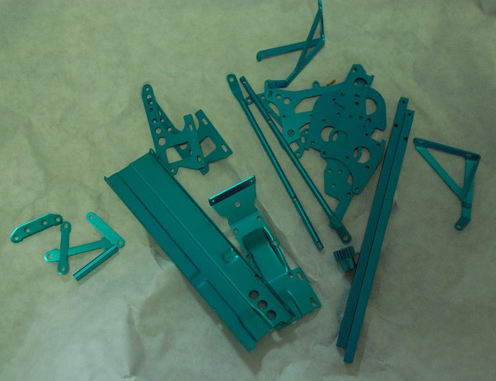

This build began with buying some blue anodized shock mounts and a few other parts from pargu2000...but then I realized I had more than enough parts for a second Optima build, so I negotiated a deal to ship him some of my parts for him to anodize and ship back to me. This build will use blue and hop-up parts wherever possible, to improve the strength of the original Turbo Optima.
The anodizing is done, the parts should ship next week! Here's a teaser pic. The parts I shipped to Korea were sanded with 600, 800, 1000 & 1500 grit sandpaper, then buffed with rubbing compound to prep them for the anodizing. The skidplate had a few deep scratches that I couldn't sand out, but it should still look great.

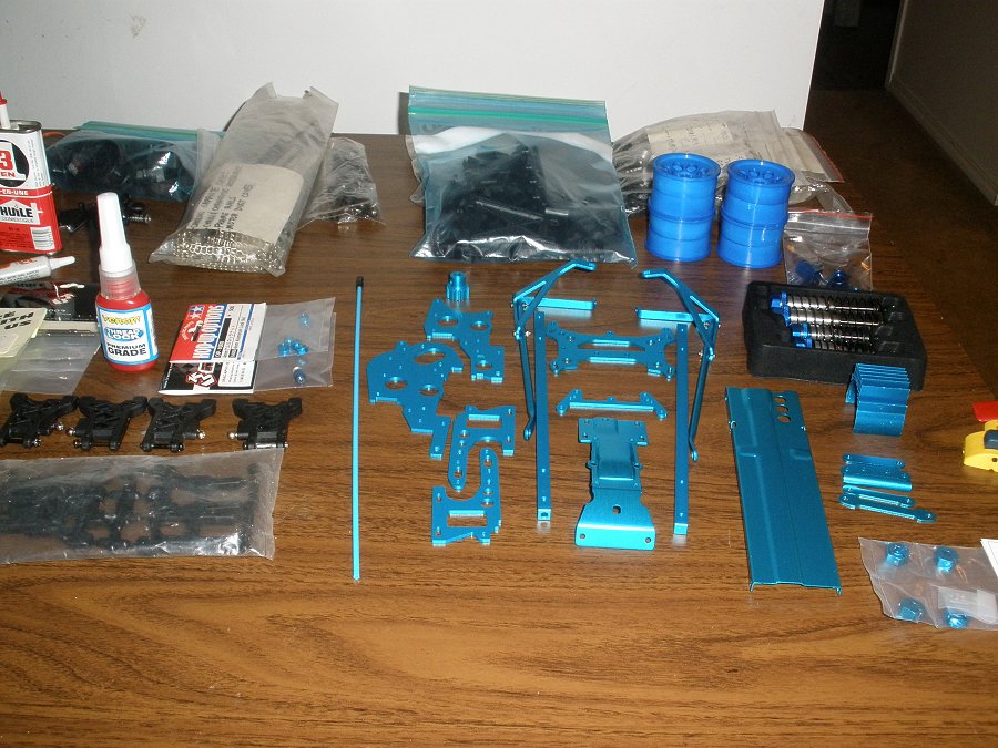

I finally received my blue Optima parts from pargu2000, including 7 pieces I paid him to anodize at the same time (among those were the belly and front skidplates). They turned out gorgeous! I can only imagine how sweet this car will look when it's finished...and the wait for all the odds & ends to arrive is painful. I can't really do anything until a belt drive and a bunch of balls/rod ends arrive!
Oh well, at least I took some pictures while I wait anxiously... 8)

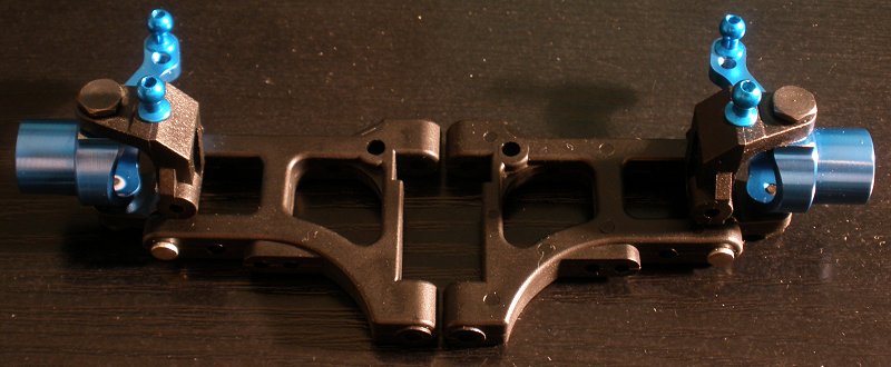

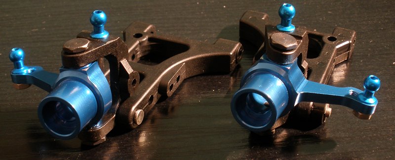

Finally, some of the parts I've been waiting for have arrived, and work has begun!

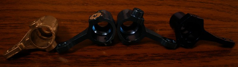

I have 2 different makes of Kyosho Lazer blue alloy knuckles. The darker blue ones from Tower are an almost perfect fit right out of the package, but the other pair were a better color match. :P Those required some work, though...about 3mm needed to be hack-sawed off and carefully filed down from the longer posts. The dark blue pair will be spares.
Here are the completed steering knuckles mounted on the shorter Kyosho EP-10 control arms, with some nice 3mm-thread, 4.8mm alloy balls installed. The spacing for the C-hubs is exactly the same as the Turbo Optima arms, and the wheels will be in the exact same position, wheelbase-wise. The only issue is the Turbo Optima shafts that go through the control arm ends/C-hubs are about 5mm too long, but the EP-10 control arms come with round plastic spacers that made it a perfect fit.
