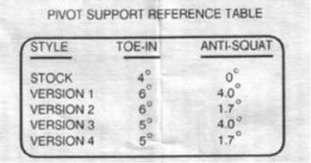

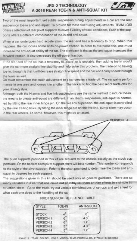

In building my JRX series car, I thought I would tap the knowledge of us all and start a set up discussion.
Rather than this shock piston/oil/spring, these camber link positions...I would rather talk about what changes you did and the result, then we can all test/learn our own set ups and how to adjust the car to fit your personal driving style/track. Gearing discussions welcome as well.
First a few questions:
H arm rear mount, they come numbered 1-2-3-4, but for the life of me, I dont remember what the differences were. So lets start there :)

id say these are different rear toe values... the higher ones the more stability butthr harder it is to recover when the ar gets loose... lower toe gives a harder car to drive but less scrubbing speed.

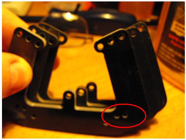

what is the difference between:
Composite Craft Pro SE front tower
Jammin' Pro SE front tower
Losi Pro SE front tower
--Joey --

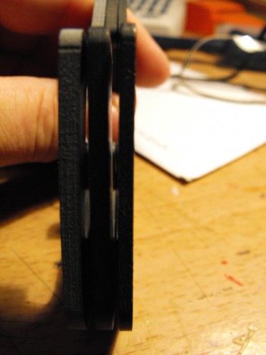

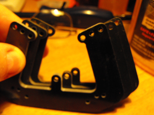

JK Racing wrote:what is the difference between:
Well I have all three the stock Losi se tower came in two different thickness's, the Composite craft was a different material and a little thicker than the thicker Losi one, then the Jammin one by far the niceest one it is THICK :lol: about as thick as all of the others put together! I can did them all out and post pic's if you would like.

JK Racing
Posts: 4618
Location: Placentia, CA
Has thanked: 131 times
Been thanked: 243 times
Re: JRX series set up discussion
Post by JK Racing »
when i was looking at the Jammin, it appears to not have as many camber link holes. is the composite craft & losi identical (other than material)?
--Joey --
Vintage A&L and Factory Works
JKRacingRC.com
bearrickster
Posts: 4372
Location: Hollywood Maryland
Post by bearrickster »
yes its just a better fiberglass. and it has 3 shock and 3 camber holes just like the stock. if you need any of the above let me know. I bought 5 of the Jammin kits, and just took the CC one off. it is not scuffed up on the top. I like the Jammin one the best, the other two flex to much
LOSI RULES!!
Bearrickster's Rides

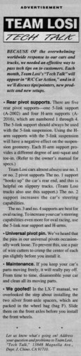

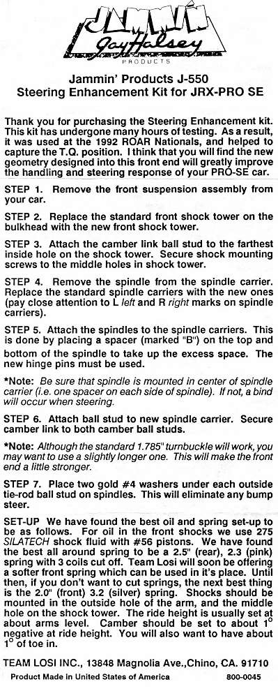

Jirka
Posts: 797
Location: Europe
Has thanked: 30 times
Been thanked: 24 times
Post by Jirka »

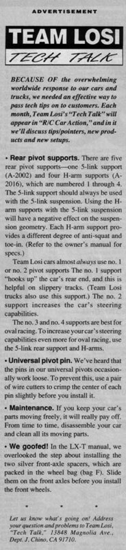

Jammin' J-550 steering enhancement kit was a bundle of parts: front shock tower, monster truck? hub carriers and some washers. They were meant to work together better with softer front springs than original Losi Pro SE parts. Below is scan from vintagelosi.com page about this kit.

bearrickster
Posts: 4372
here are the towers the first one is the Jamin, the middle is a composte Craft, stock Losi from the front their all the same. the Losi one also comes the same with as the Composite craft one. I guess they did a mid year change or something but I have opened nip Losi towers and some are thick and some are thin, with the same packageing.

Posts: 4618
Post by JK Racing »
Rick, are the camber link holes all the same? I thought the Jammin has 2 and the other have 3?
--Joey --
JKRacingRC.com
bearrickster
Posts: 4372
JK Racing wrote:Rick, are the camber link holes all the same? I thought the Jammin has 2 and the other have 3?
yep I missed that they deleted the outside hole
LOSI RULES!!
