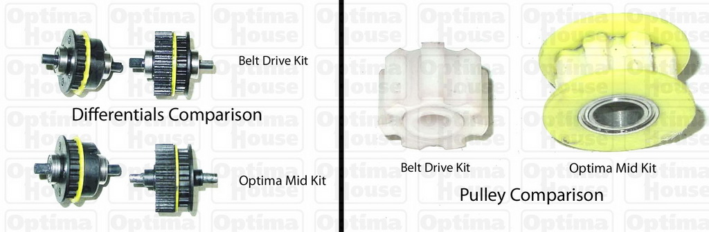

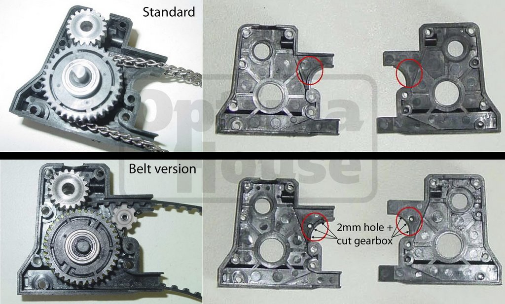

I did my own home-brew of a belt conversion with my Barney build, you can find some details of the gearbox modding that's required here:
http://www.rc10talk.com/viewtopic.php?f=30&t=21530&start=67
That said, if you do it according to the instructions that came with the belt conversion kit, it's a tad more involved if you're trying to piece-meal it. You'll need an Optima Mid belt (I think OT-89), 2 Optima Mid diffs, a regular Optima/Turbo Optima gearbox that has a few pieces cut away and a hole drilled for the idler gear assembly, you'll need the idler gear assembly itself (though I've heard of people doing the mod without) and ideally, you'll want to fabricate a dust-block for the cut-away sections of the rear gearbox.
I added some pics that I used for reference, hope they help out if you're considering this mod.
The idler gear assembly is quite finicky; it includes a little shaft, some washers, a plastic ring if I recall correctly and a couple flange bearings--and it installs on either side of the dust-cover...all while having the belt and idler gear in position while bolting the 2 gearbox halves together. It's a bit of a pain, for sure.
