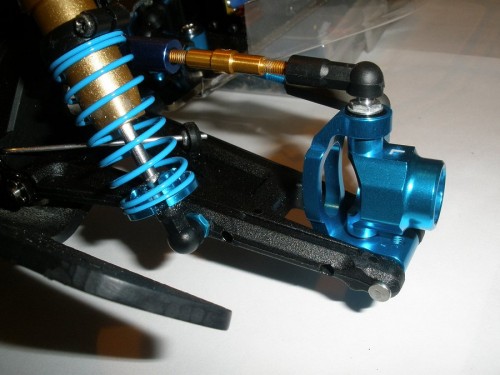

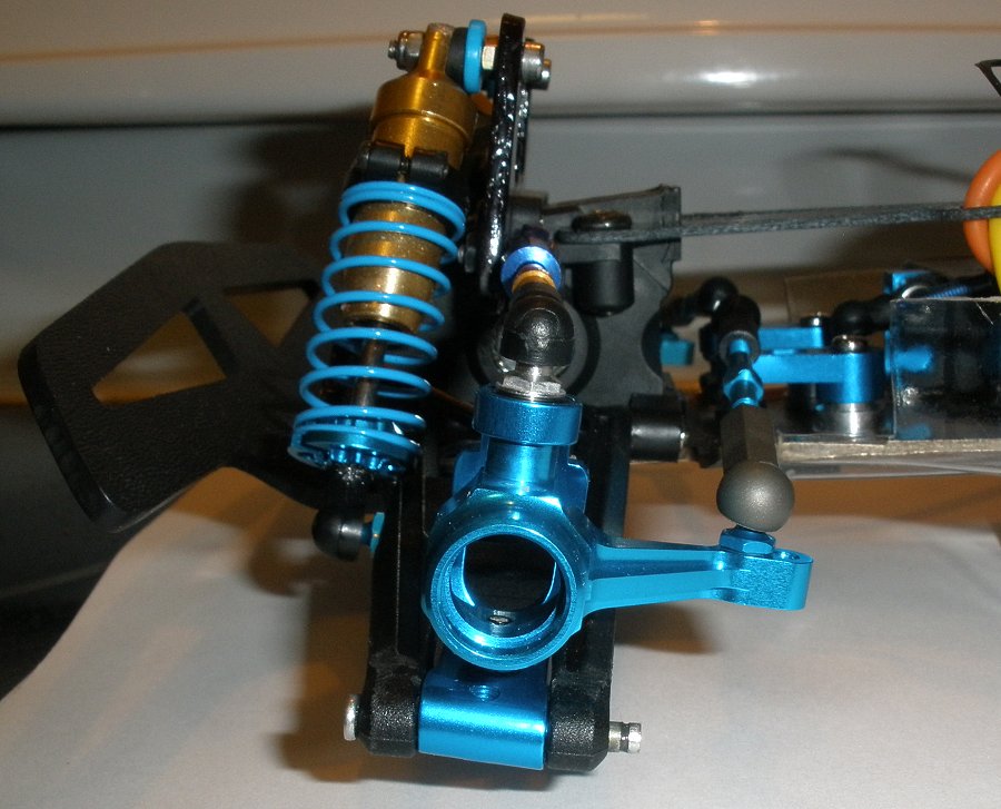

Front End v2.0
I revised the front end, changing the steering knuckles & C-carriers to something that would fit the Maxxum arms better. Lazer carriers fit (I'm using them on my Barney build) but they require some filing and grinding of the Maxxum arms to work properly. I found an eBay seller who took the time to get me measurements on some Tamiya parts that looked promising, proportion-wise...and it turns out they're a near-perfect fit! About the only thing I had to do is drill the hinge pin holes on the carriers to 3mm, as they were an odd Tamiya size of 2.6mm or something. The knuckles & carriers are for the same car series so they fit each other like a glove.
I also prefer these carriers as they give the front end an additional 4 degrees kick-up.
The parts are for the Tamiya TA-05, as follows:
-C-carriers: Yeah Racing #TA05IFS-005BU, $12.90
-Knuckles: 3Racing #TA05-15/V2/LB, $13.50
-Tie-Rods: Tamiya #54250 3x42mm, $4.30
-Bearings: Tamiya 5x11x4mm, $4.00
So, this is actually a pretty inexpensive mod to bulletproof and "alumify" your Optima Mid front end! You'll need to buy Maxxum arms, though. But since the Maxxum arms have the exact same dimensions as Optima/Turbo Optima/Optima Mid front arms, they will swap right in on your Mid.
One thing I don't know is how the Tamiya TA-05 carriers might change the length of the Optima Mid dogbones or CVDs, but I don't think it would change too much. I can't test-fit because this is now a RWD, but with 62.5, 65.5 and 68mm CVDs being made for the Lazer, I'm pretty sure one of those would work.

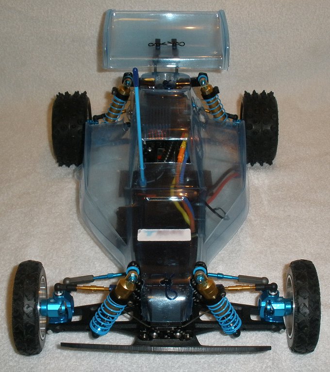

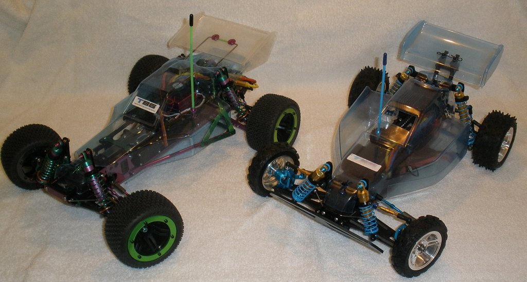

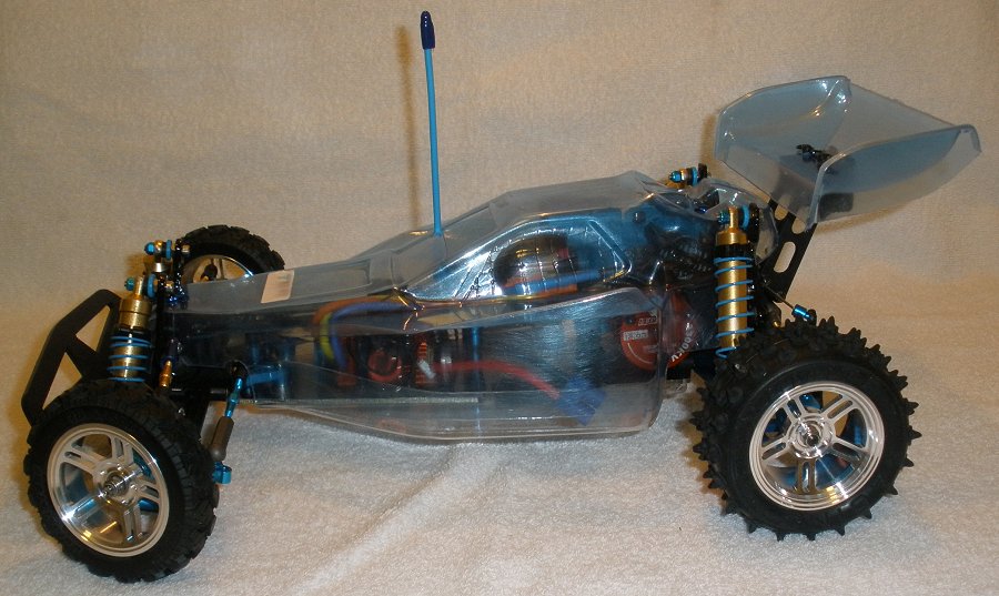

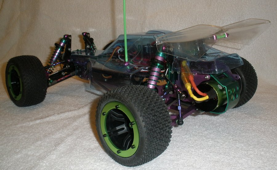

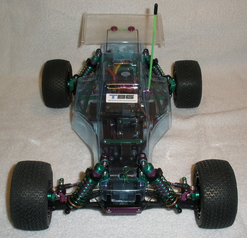

A couple of Optima beasts get bodies
I figured I'd post these all on this topic rather than half here, half on the Barney thread because I kind of liked seeing them side-by-side. I finally have the bodies & wings trimmed for both these Optima beasts. They were both a helluva lot of work to get them to fit and mount nicely, but now they're just about ready for painting. I have some very cool paint schemes in mind!
I particularly love the wing I found for Barney...years ago, one of the LHS's had a bargain box with random tires, wheels, bodies and other crap in it, and this one wing. I loved the shape, it looked different from most other wings I've seen, and had to bring it home. It'll probably get more of an angle when everything's done.

Re: Project OptiMutt
Great pics from the front (love the blue hubs) and the wide track comparison with the green car.
- Coelacanth
- Posts: 7421
- Location: Alberta, Canada
- Been thanked: 325 times
Thanks, Adam--I should actually take a front track measurement to compare the two. Both cars are using the same GPM alloy rear arms, and both are running 68mm CVD bones in the rear. The GPM arms are 5mm longer than stock Optima arms so the 68mm CVDs are needed; the stock 62.5mm Optima bones would be too short. Other than that, the rear carriers are stock on Barney but the axles are a a bit longer. I'm using about a 1.5mm spacer on the outsides of the wheels before bolting them on.flipwils11 wrote:Great pics from the front (love the blue hubs) and the wide track comparison with the green car.
Both cars have the same front arms, but different carriers & knuckles. One thing that widens the OptiMutt front track is that I'm doing something quite unusual for the front axles & bearings. I'm running 4WD front knuckles with bearings inside, and axles with cross-pins & hexes for mounting 12mm hex front wheels; but if I want to mount older-style wheels with bearings captured in the wheels, the front axles are long enough that I can also mount those kinds of wheels (which I'm running for the above pics). So at the moment, there's 4 bearings on each side of the front--2 in each carrier and 2 in each wheel.
