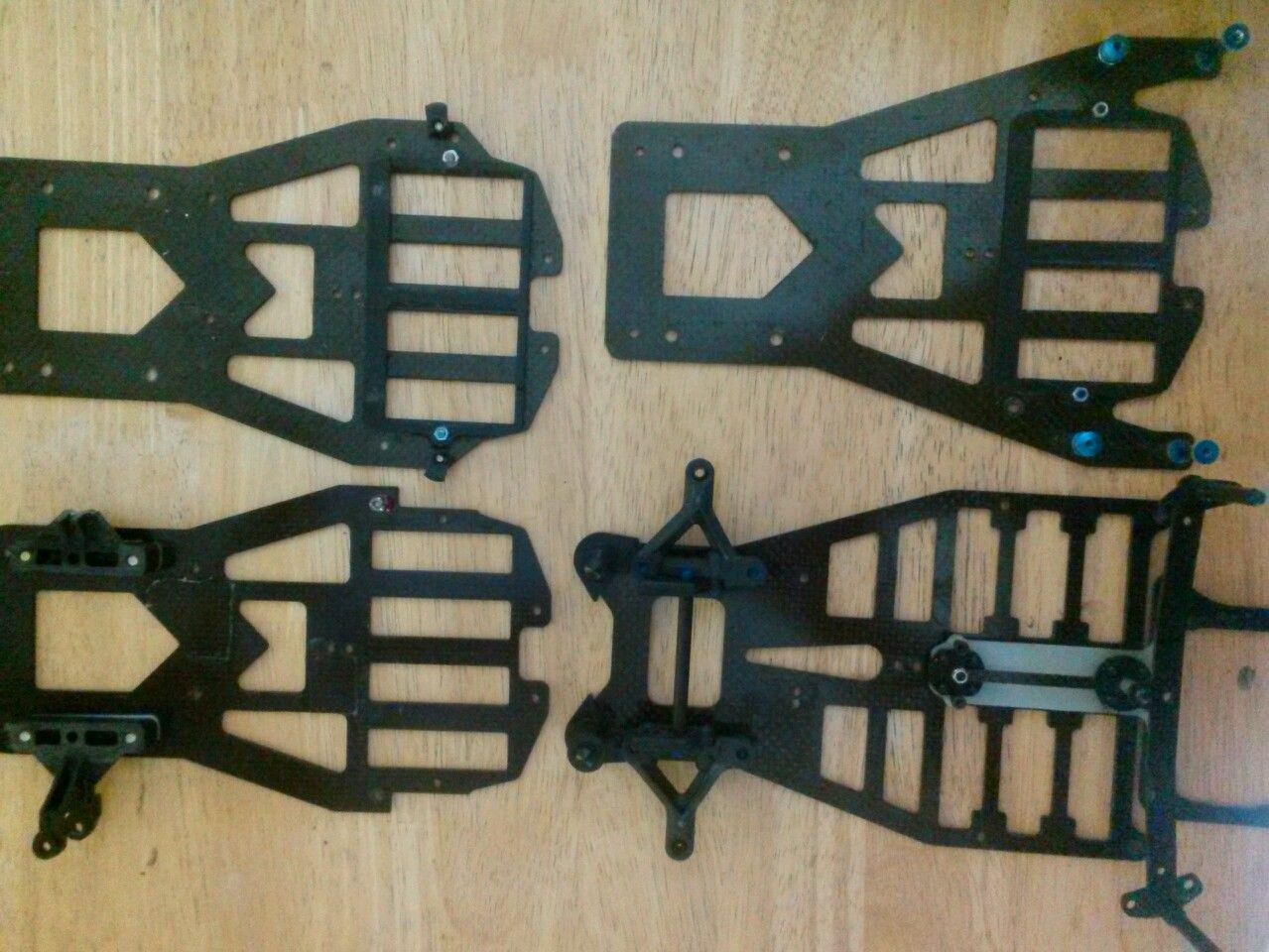

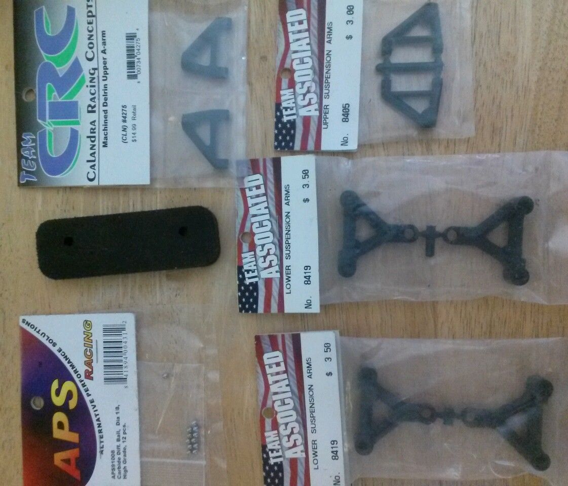

I've been interested in doing something different from 1:10 offroad buggies lately and had been eyeing pan cars on eBay the last several months, waiting for something good but cheap to pop up. I finally spotted a nice auction lot with carbon fiber chassis'; one turned out to be an RC12L3 and the other three were Team SpeedMerchant Rev 3.0 chassis plates. I decided to build the AE because I figured finding parts or a donor car would be much easier.
I scored this parts lot all for $30 + shipping; it included a baggie of extra parts and several NIP parts bags too.
Fortunately the 12L3 chassis plate was in very good condition, but practically everything else bolted onto it or in the extras parts baggie had been cut up, ground down, modded or otherwise worked over somehow--and not too skillfully, I might add.

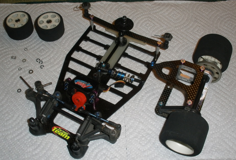

Somebody on RCTech.net advertised an RC12L3 for sale months ago, but I took a chance and sent him a message asking if he still had it...long story short, this donor chassis arrived today for $45 shipped. It looks mostly complete.
The plan is to disassemble everything from the donor chassis and install everything on the chassis I bought, as it's in very good condition. I'd also substitute any aftermarket or NIP parts where possible. The original lower arms installed on my chassis plate were sadly cut down in nasty-looking amateur fashion.

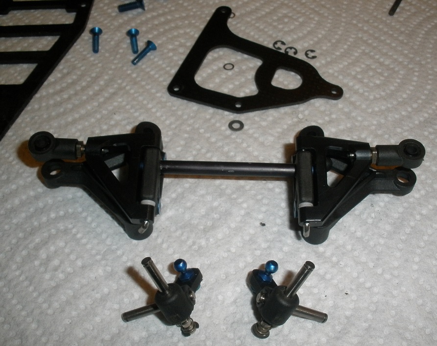

I had NIP front lower control arms and CRC machined Delrin upper arms, so I started transplanting the goodies over. I noticed the donor chassis had one upgrade: the pieces that attach between the upper & lower front arms and affect the caster angle, from the looks of it. No idea what the actual part name is, but I kept those parts from the donor chassis. Here's the front end assembly in progress.
I have a couple questions...I haven't downloaded a manual yet, but it seems unlikely that the upper arms are merely pinned onto the aftermarket parts I mentioned above with those steel J-rods? Shouldn't there be something with e-clips perhaps? Also, is it possible to remove the black balls from inside the control arms' outer ends without damaging them? The new AE lower arms don't have the balls inserted and the two balls I attempted to remove from the used arms just got damaged without budging.

The upper arm pins are merely held in by friction in the upper arm mount, but you want the arms to swing freely though. The L4 was upgraded with set screws in the upper arm mounts to hold the pins.
It is possible to remove the balls but tricky, an old jewlers screwdriver or something similar to use as a punch. There are aftermarket companies that sell delrin balls so replacing them with new shouldn't be too hard. If the arms are poorly cut they are of little value so cutting the ball out would be another way.

You probably have enough spares to also start rebuilding the Speed Merchant chassis.Coelacanth wrote:Somebody on RCTech.net advertised an RC12L3 for sale months ago, but I took a chance and sent him a message asking if he still had it...long story short, this donor chassis arrived today for $45 shipped. It looks mostly complete.
Arms were cut down so that the tires could be trued to a smaller diameter and still make ground clearance requirements.The original lower arms installed on my chassis plate were sadly cut down in nasty-looking amateur fashion.
If you mean the caster blocks, the ASC4561 kit came in 3 angles...0, 5, and 10. You can further adjust caster by moving the white shimsto the back or front of the caster blocks.I noticed the donor chassis had one upgrade: the pieces that attach between the upper & lower front arms and affect the caster angle, from the looks of it. No idea what the actual part name is, but I kept those parts from the donor chassis. Here's the front end assembly in progress.
The pivot ballas can be removed but only from one side of the ball end. With the stock plastic ones they're pretty hard to remove without damaging. I typically insert a 4-40 socket screw into the ball and press the head of the screw against a table to pop them out.I have a couple questions...I haven't downloaded a manual yet, but it seems unlikely that the upper arms are merely pinned onto the aftermarket parts I mentioned above with those steel J-rods? Shouldn't there be something with e-clips perhaps? Also, is it possible to remove the black balls from inside the control arms' outer ends without damaging them? The new AE lower arms don't have the balls inserted and the two balls I attempted to remove from the used arms just got damaged without budging.
