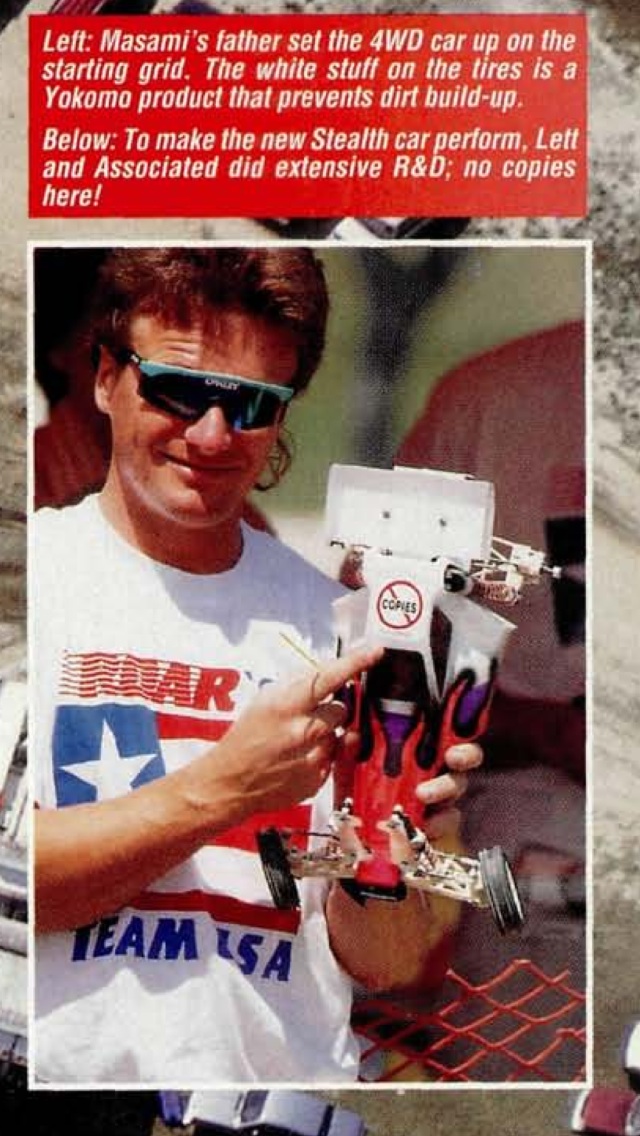

you have an idea what you're going to build? masami edition, or someone else's stealth ride?

Re: 91 Masami Stealth replica COMPLETED!!!!!!
For now just the pieces. I'll have to think about it a bit. I like the simplicity of the paint scheme in the one Cliff is holding. Plus it would be fun to make a second "no" circle over the "no copies" sticker lol
