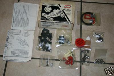

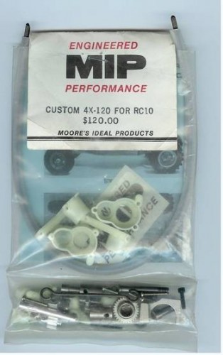

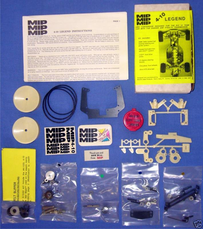

It sounds like the car your subscriber is sending you is the first of the SP-1 transmission based 4x4 kits, not the 4-10 legend kit. There were basically 4 MIP 4x4 kits for the RC10. The first one had a cable drive system. That was followed by the SP-1 chain drive kit (later a belt option was released). The last one was the 4-10. A very generous fellow indeed as those kits still bring some pretty good prices.
I wouldn't build one using modern parts either, but I have to admit that I'm curious to see what it'll look like.
Good luck with your builds!

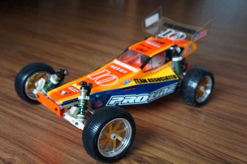

hi ,
first, sorry of hijacking the threat.
i know there have lots of very nice 4-10 projects on here and they are great.
if compare to them ,mine just a small potato ha ha .
so i just post some here.
but here have lots of nice guy that can help u to build up ur car.
here my self 4-10.
here my self 4-10.

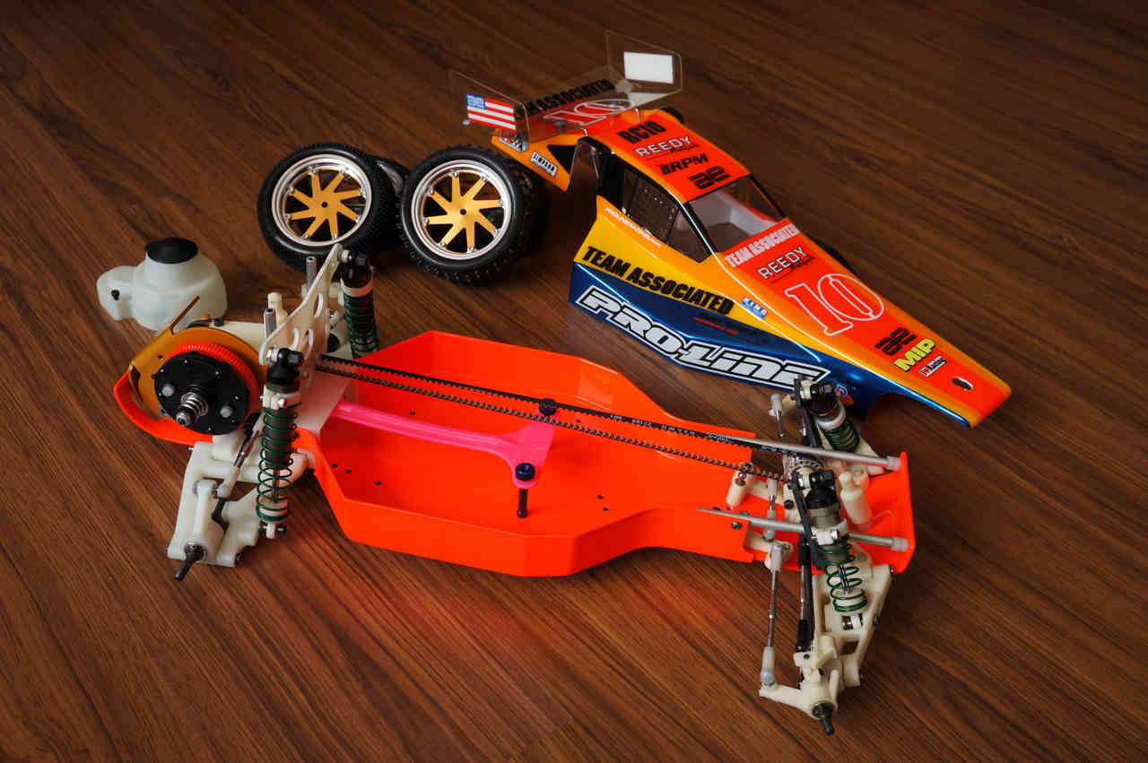

So I got to tearing this thing down, throwing aside any parts I deemed not worthy for the restoration. That basically means the MIP conversion parts only, and most of those I am putting aside for the SP-2 restoration. Most of the chassis was just a standard RC10 with the snot kicked out of it. I'll clean those up later and restore it into a normal 2wd.

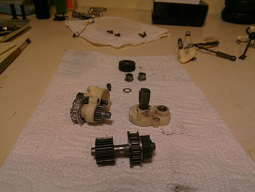

So what this really comes down to, is the front gearbox and the rear output pulley + idler. Picture below. I have to build up a whole new chassis from just that. Wonderful
I have a few goodie bags to get started on this. I plan on starting with the front end, which will be a Worlds front end with the taller shock tower. I already ordered longer belts that should be perfect for the job - S3M-633-4 - from polybelt.com. Ironically, these are the exact same belt length as what you get on the SC10 4x4, with the only difference being the width (5mm on the SC10 vs. 4mm here).
The front diff is literally two one-way bearings on either side, mated to the center of the diff gear. One of them is a little wonky, though, occasionally permitting some rotation in the locked direction before actually locking up. Not really an issue for a shelf queen, but definitely irritating. Both the front and rear pulleys mount onto a conical shaft, meaning it's a b*tch to get them back off. Still trying to remove the front pulley without breaking anything. Might need to throw some WD-40 at it?
The rear pulley is a slipper-type pulley, but is missing both slipper pads and and the spring washer. I think I can cut new pads from a set of AE high torque pads, and I'll improvise on the spring washer.
I'm surprised a conversion this derelict went for so much money. I'm positive somebody else would have paid as much if I did not bid on it, since I got it with like 3 seconds to go. So, if that means that is the actual market value for this thing, it had better be worth a hell of a lot more by the time I'm done with it, big bores and all.

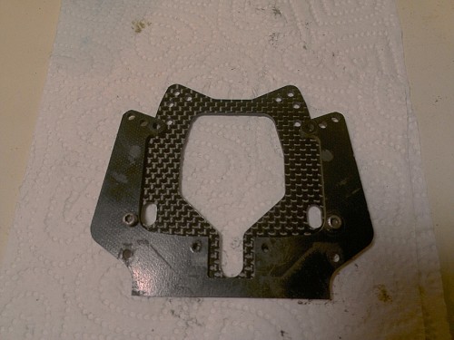

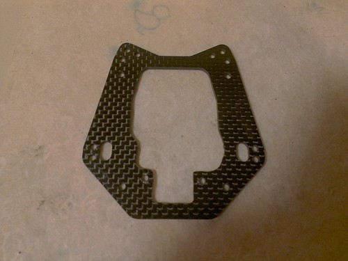

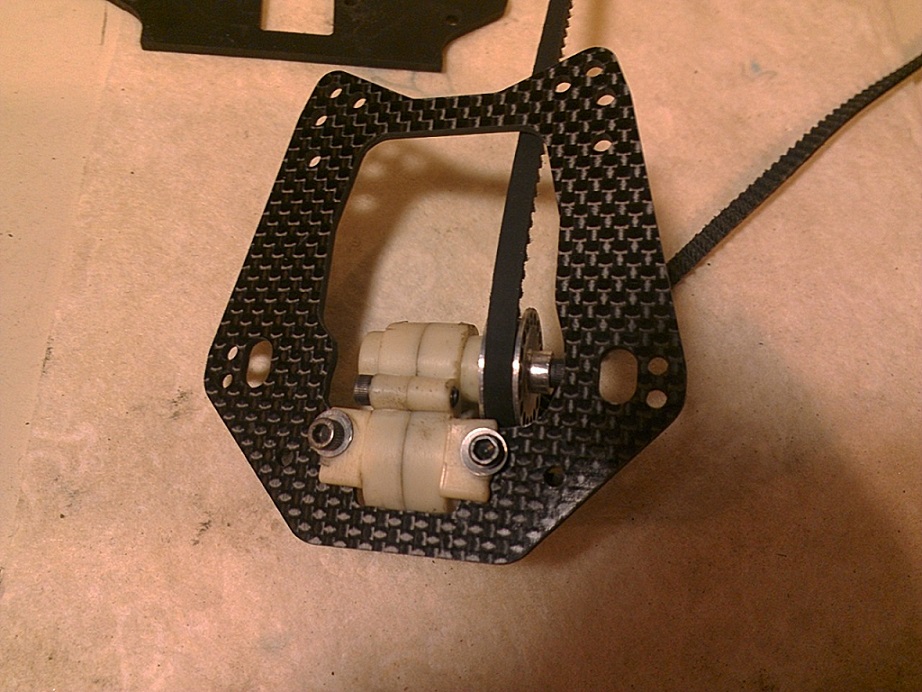

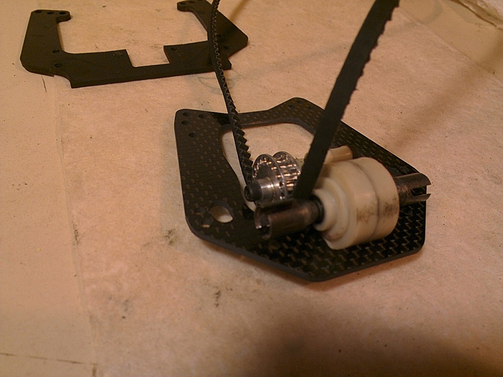

Ok, front shock tower taken care of. I started by bolting the MIP tower to the World's tower and tracing out the shape and hole locations. Then, I used a router bit and a sanding bit on my Dremel to remove the traced-out regions (2.5mm drill bit used for the holes). This required quite a bit of trial and error, since the pulley runs up against the World's tower in a way it never did on the MIP tower. So, I had to remove some extra material after test fitting and figuring out where unnecessary contact was being made. It does fit, though...just took a bit of work.
