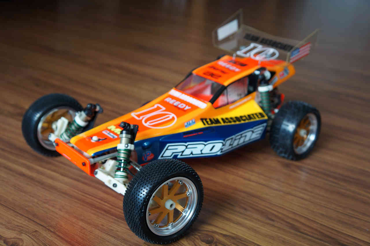

hi ,
first, sorry of hijacking the threat.
i know there have lots of very nice 4-10 projects on here and they are great.
if compare to them ,mine just a small potato ha ha .
so i just post some here.
but here have lots of nice guy that can help u to build up ur car.
here my self 4-10.
here my self 4-10.
