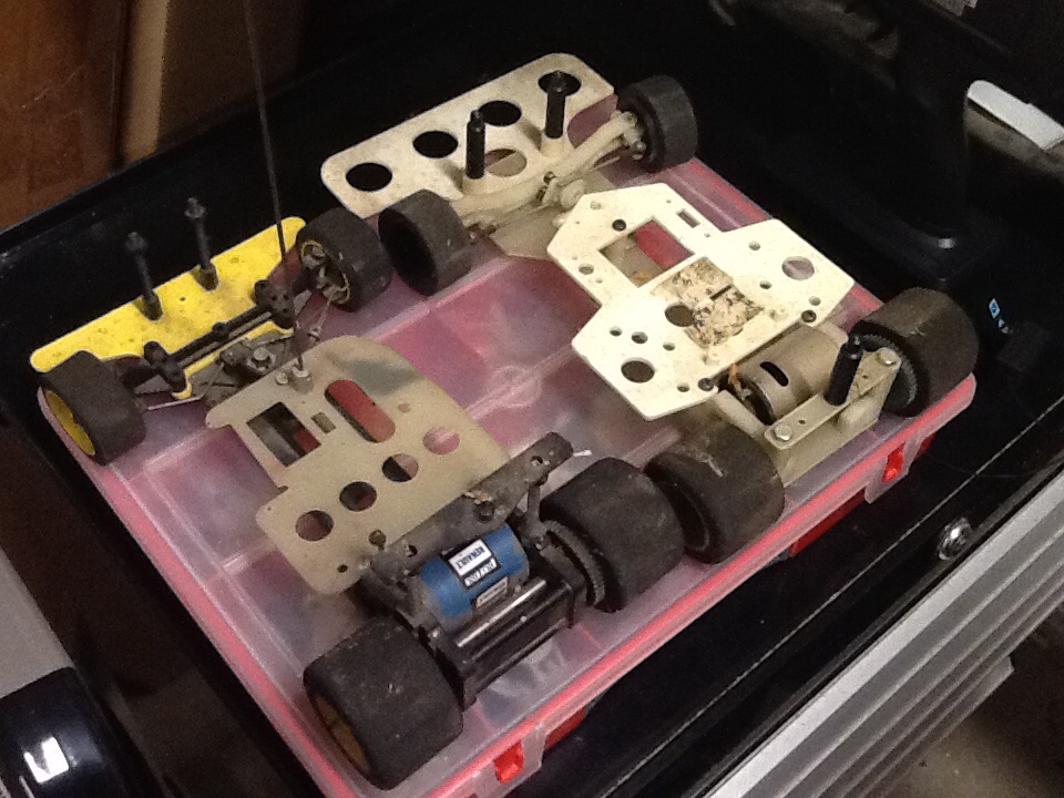

I have an old 12E, and Parma panther, I intend to fix them both up in the near future. My 12E has a different front end on it though, and I can't tell you what parts they are..these used to belong to a friend of mine, and I'm pretty sure he cobbled the car up from available parts..
Here's pics.

cashrc wrote:I have an old 12E, and Parma panther, I intend to fix them both up in the near future. My 12E has a different front end on it though, and I can't tell you what parts they are..these used to belong to a friend of mine, and I'm pretty sure he cobbled the car up from available parts..
Here's pics.
Cashrc, your car is a clone of the 12e called a cx12. Look here...
http://www.rc10talk.com/viewtopic.php?f=33&t=14461&p=419338&hilit=Tomopolus+cx12#p419338
