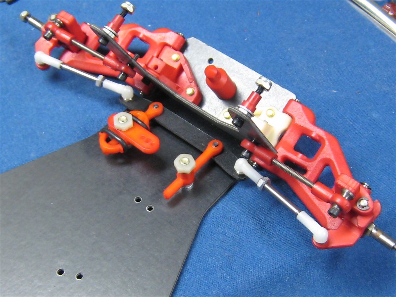

Yeah, you need to be sure it works on Nylon. The std natural fiber clothing dyes will not work. I have yet to find a Fluorescent dye that works with nylon. Most of the dyes from yesteryear are no longer available due to epa regualtions. If anybody has some of the old Litespeed Fluorescent they want to get rid of, please let me know! I have some worlds parts to restore :) . -Jeff

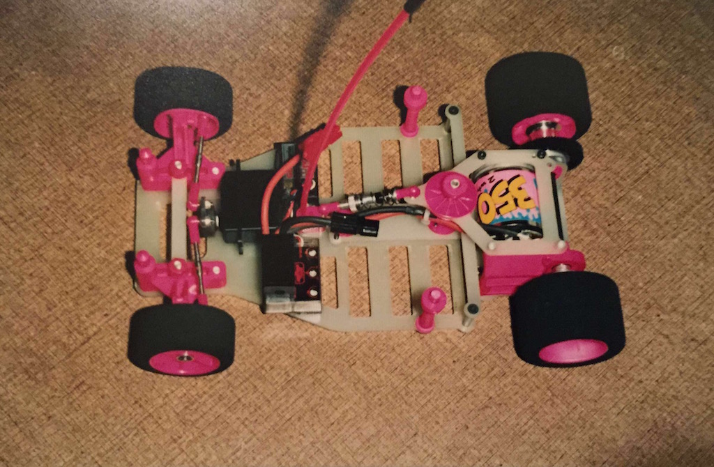

DerbyDan wrote:
SMOKE-DOG wrote: Maybe... a quick check and it looks like the 3 neon colors they offer (neon yellow, pink, and green) are in there professional line and only sold through RIT online.
I do know that Fuchisa and petal pink are in stores, just saw them at Krogers. They are close to hot pick.
Rit dyes are not widely available over here in the UK - I've been buying it on Ebay from needlework suppliers.
Rit Fuscia will definately give you a very bright 'hot' pink... but be warned (I learned the hard way) DO a couple of test runs with different mixes & keep an eye on the length of time your test peices are in for... for my Yokomo wheels I used what I now know was a rather 'strong' mix of dye/water, just 20sec would have probably given me the colour I needed, a further 20 seconds would have given me super bright pink.... I left them in even longer & got an almost red/magenta colour :|
- Dan
You can boil the colour out, i know as I have the original pink wheels. I boiled them to get the glued tires off with some Losi 5 spoke neon yellows in the boiling pot too. The Losi 5 spokes ended up turning orange because of the pink dye releasing from the pink Yokomo wheels. The Yokomos are now a slightly sun faded looking pink.

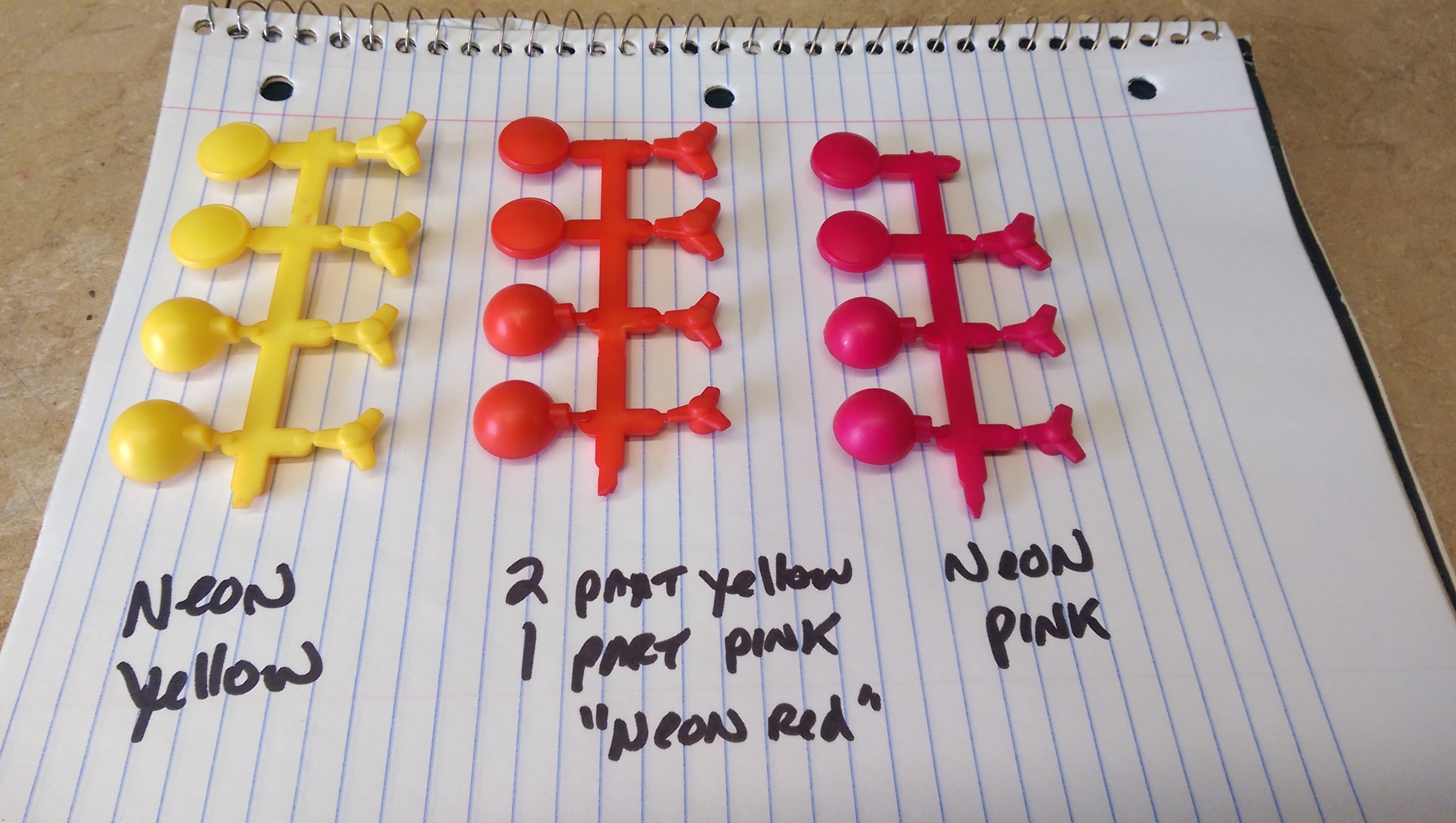

I'm yer huckleberry :mrgreen: just got my pound of neon yellow and pound of neon pink. Ive only tried the pink so far, first with .35oz to a quart (this is lightspeeds mix ratio) , then the same with 2 quarts of water. It's brighter than the rit pink and looks much better.... But I still don't think it's as bright as the Dylon. Can anyone post up pics of the Dylon florescent pink? The only one I see is Ltodave's and the wheels look more purple than pink?
Top row is two quarts water and 10 minutes at boil
Bottom row is one quart water and 10 minutes boil
Also note worlds stealth case is not really white to start with
I'll try the yellow over the weekend

Posts: 12336
Been thanked: 3919 times
Re: Who makes HOT PINK dye?
Here's the yellow and a custom red
