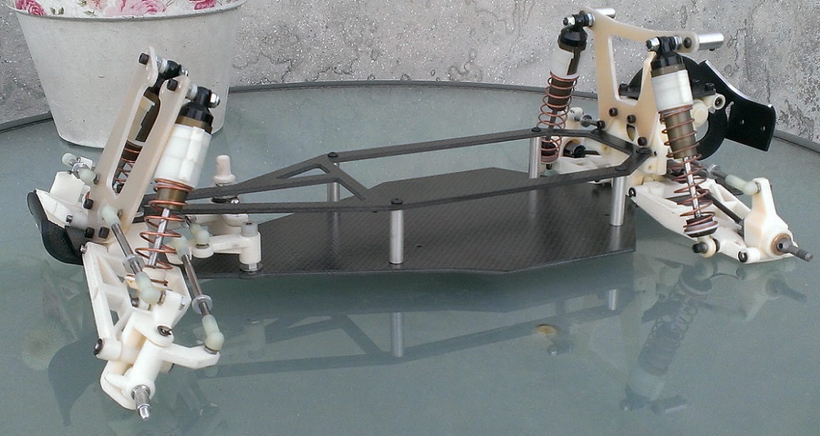

Wow Niki!
Love your work. They look really good.
This means I might have to revise my build again :evil: :wink:

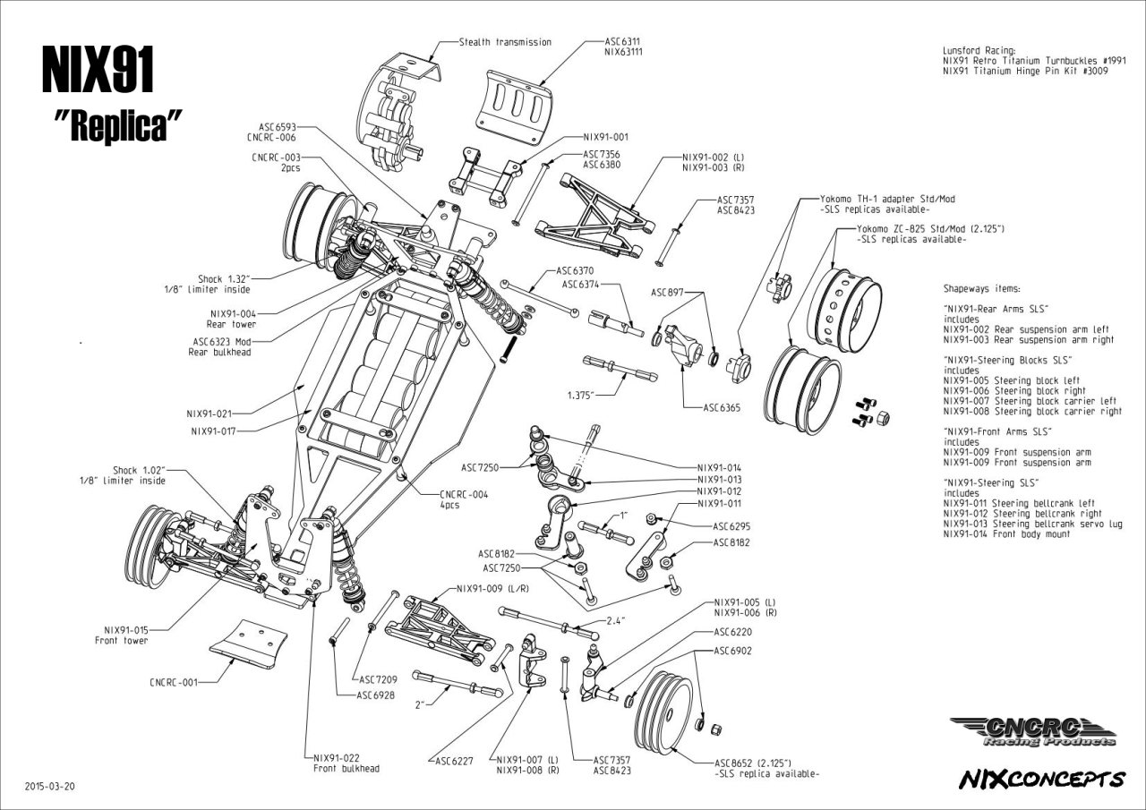

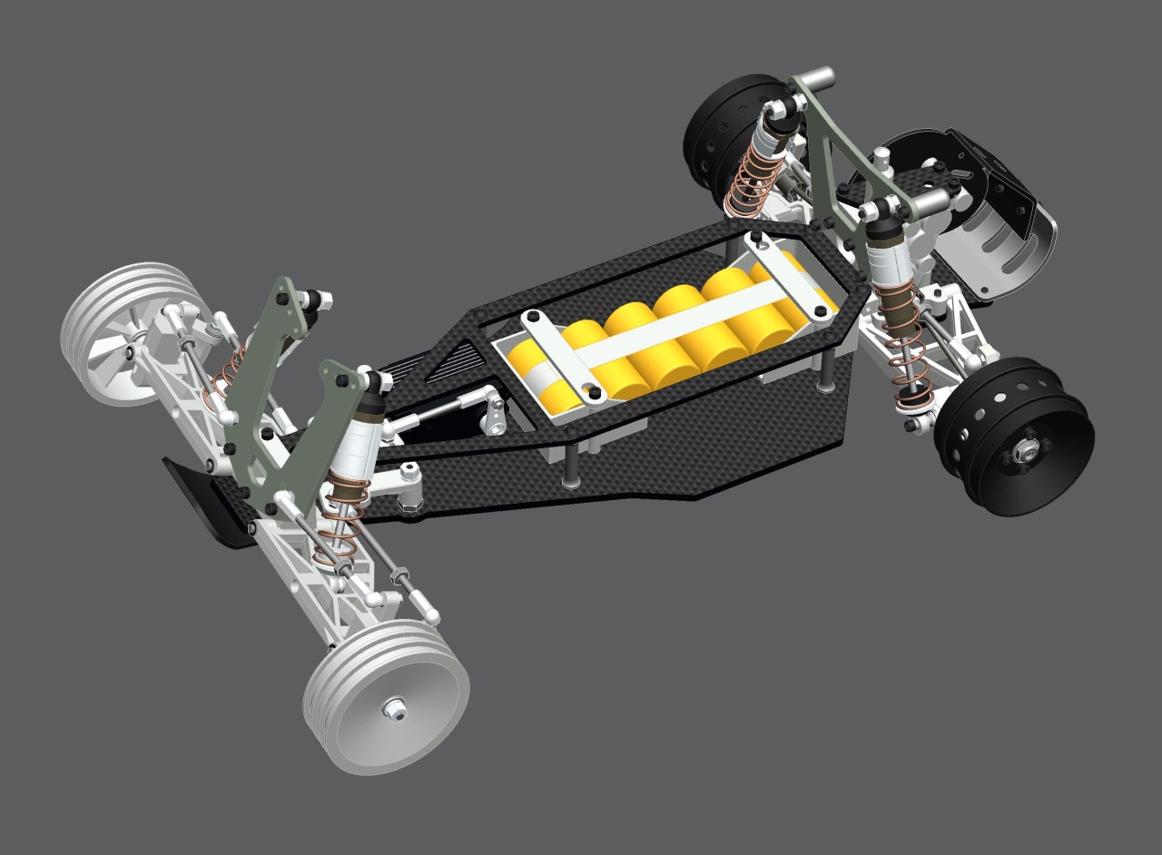

I decided to make separate assembly drawings for "Replica" and "Race" versions. Just to be more clear with all the options.
This is "Replica"...

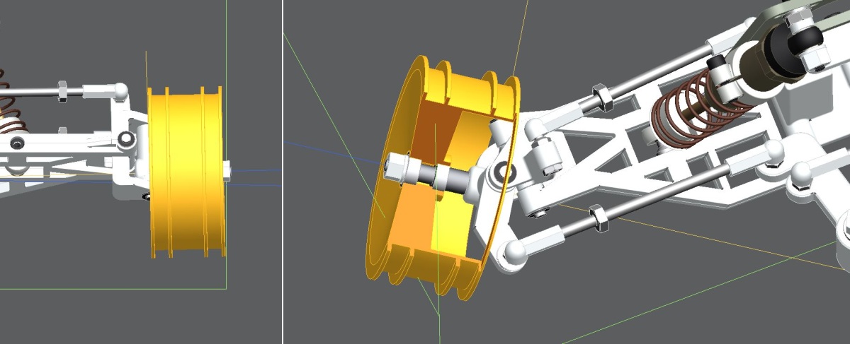

There has been confusion if 1" wide B4 front wheel can be used or not.
For some reason I had a vision axle #7222 + B4 wheel will make front end too wide for race use. That's not true... it's spot on right.
-Niki-

The wheel width is perfect, right at 250 mm, technically, the nut that keeps the wheel on is too wide. Nobody is going to care about the wheel nut. If it bothers you, cut off the threads, drill and tap the axle to hold the wheel on with a button head 4/40 screw.
