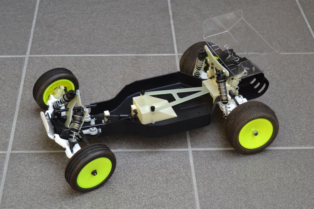

B4 rear hubs can not be used. You need RC10 or B2 type hubs.
#6365, #7364, NIX63651 or maybe CustomWorks 3241.
If you want to use big outer bearing (#7935) I think your only option is NIX63651...
-Niki-
-Niki-

Thanks Niki. I don't even know why I asked. I'm not even using B4 rear hubs on that build.

Love the front tower. Any way to get one here in the US?
Cant wait to dream up how I will built this one up.

From what Joey said on FB, they move the hinge pins in to the same width as the front hinge pins.

Thanks GoMachV ! Superfast service

I see, so they are modified slightly to move the pins inboard. Makes sense.
thanks, looks like a great project guys! natural evolution from the WOIN.

Re: Quadra-symmetric RC10
Looking good so far
Just to be sure:
- B4 cva's and B4.2 axles + hexes to fit these wheels¿
- inline axles on the front to fit the ''old'' b4 wheels¿ What about the Worlds ReRe front axles¿ would it work¿
- do i need longer turnbuckles¿
Can't wait to start mine
have to order many parts
Just to be sure:

Yes, full power line from B4.2 including wheel.Vale wrote: - B4 cva's and B4.2 axles + hexes to fit these wheels
Shortest possible inline axles #6220. Worlds rere axles #7222 are too long.Vale wrote: - inline axles on the front to fit the ''old'' b4 wheels¿ What about the Worlds ReRe front axles¿ would it work
Worlds rere turnbuckles are ok if you use long shank rod ends.Vale wrote: - do i need longer turnbuckles

Start of the topic updated...
Wheelbase and track width front and rear match B4.2 really closely. New rear tower (NIX63772) can carry B5M wing mounts.

Can anyone tell me the distance between inner and outer hinge pins centres on the wishbones?

Trying to understand, as i didnt see. what front shock kit. .71 or .89? and im guessing 1.32 rear with 1.32 shaft?
