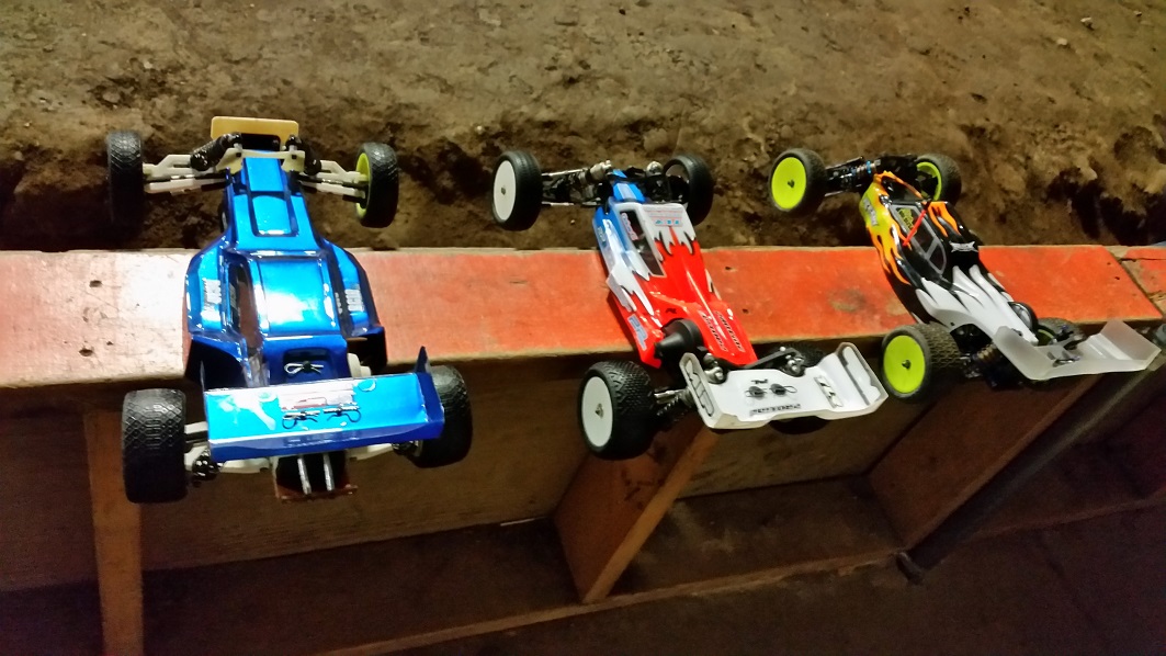

JasonB
Posts: 55
Joined: Mon Jan 06, 2014 12:40 pm
Location: Detroit Metro, USA
Re: Quadra-symmetric RC10
Post by JasonB »
mk-Zero wrote:
Beau S wrote:Niki,
So, this design has the front and rear Track width maxed to 250mm, Roar Limit, using B4 drives, hub, hex, and std rc10 front casters with OG inline axles?
I read thru all 4pgs and saw this kinda scattered through comments. I'm just dbl checking the width, and strict need for the front suspension components.
thanks ;)
Joey's car was outside the limits, might want to check with him...
http://www.rc10talk.com/viewtopic.php?f=35&t=38746&start=15
Check that thread again... Joey is using b4 caster blocks, Niki designed for rc10 caster blocks. On a B4, he wheel is a little 'further out' from the hinge pin. How much... maybe 2mm? But enough to make it too wide. I would love to add trailing axle and front hex to my quadra-mid gold pan racer.
My racer pictured below is an absolute blast to drive. The quadra suspension and longer wheelbase transformed the car. I took 3rd place of the class of 12 stock buggies last night. I am planning to run two local club racing series this winter with this car in 17.5 blinky.

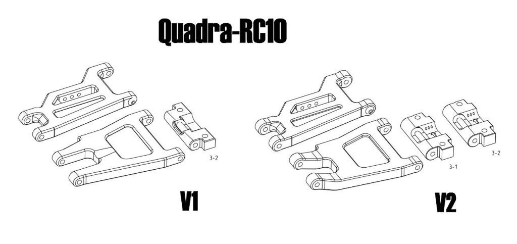

Jason, your Mid looks great.
I just made beefier rear arm mounts with 2 degree and 1 degree anti-squat. Both 3 degree toe-in / side.
Do we need 3 degree and 0 degree anti-squat versions also?

Niki
Posts: 524
Joined: Wed Nov 02, 2011 7:32 am
Location: Finland
Been thanked: 45 times
Post by Niki »
V2 parts ready. New arms are much stronger around hinge pin areas and rear arm has a new bent shape.
