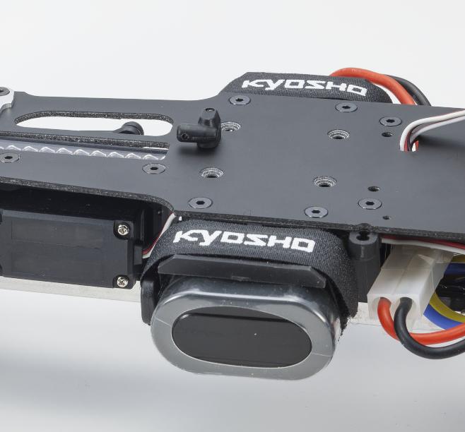

Coelacanth wrote: I wonder what they're using for a battery? Finding a LiPo pack that fits in the original Optima's battery receptacle is now damn-near impossible. Years ago, I managed to find some Gens Ace 2S packs that were very close to the original 8.4V NiCad pack dimensions, but even those required some minor filing down of the plastic battery holders in order to fit. Modern 2S LiPos--shorty or otherwise--don't even come close to fitting without major modifications. Furthermore, 8.4V NiCads were too long to fit inside the Optima body...the Turbo Optima had a wider body to accept the longer packs.
The battery in the pictures is a standard size Team Orion Rocket 7.2v Nimh Pack. It's not a lipo.
The nimh pack in the photo is 138.5mm long, any square lipo pack can be no longer than 139mm to be homologated for racing, and all will be the same size as the nimh pack in the photos.
The modern battery holders have been redesigned specifically to use lipos, Kyosho states that the chassis is designed for lipo.
If you want to fit lipos in the original shaped battery mounts all major battery manufacturers make rounded packs that will fit straight in, for example from Hobbyking, Reedy, Team Orion. Schumacher even sell a Core-RC stick pack which is 5mm shorter, so it will fit into vintage car battery compartments while modern nimhs are too big. We have the situation where a modern nimh pack is too long to fit an old RC10 battery tray, while the Core-RC lipo will drop straight in.

terry.sc wrote: If you want to fit lipos in the original shaped battery mounts all major battery manufacturers make rounded packs that will fit straight in, for example from Hobbyking, Reedy, Team Orion. Schumacher even sell a Core-RC stick pack which is 5mm shorter, so it will fit into vintage car battery compartments while modern nimhs are too big. We have the situation where a modern nimh pack is too long to fit an old RC10 battery tray, while the Core-RC lipo will drop straight in.
None of those will fit the original Optima battery holders, unless you file the curved ends of the holders completely flat. Those batteries are all ~46 - 47 mm wide; the battery I bought (and only barely fits in my Barney car after filing down one side of the battery holders) and linked previously is 41.89 mm wide. Furthermore, the Gens Ace I bought barely squeezes inside height-wise at 18.82 mm; all of those you linked are 23 - 24 mm thick. The only way those will fit is if you remove the original battery holders entirely.

Venom 15085, $33 at tower and others, rounded and short enough. Also has nifty battery connectors to use with anything. I bought two when the re-re scorpion came out, I use them in that and my optima runner.

I'm a tad embarrassed today! But honestly, the fault is in the specifications of the Gens Ace battery I bought at HobbyPartz.com...the specs they list for the battery, and the specs I was going by in this discussion, are WRONG. I have two of these:
http://www.hobbypartz.com/98p-25c-4000-2s1p-hardcase-direct.html
The specs are listed as: Size: 139.18 * 41.89 * 18.82mm (L * W * H)
I got out the calipers last night and measured the damn thing...it's actually close to 46mm wide and 23mm tall. D'oh! :oops: I have no idea why the Gens Ace specs are so far off...but I apologize for disagreeing based on my assumption that the website specs were in fact correct.
That said, the batteries suggested by Terry and others should all work for the original Optima, except that you will still need to file down the curved ends of the original battery receptacles so that the wider LiPo batteries will fit snugly. (This obviously isn't necessary with the re-re Optima, the battery holders are already flat.)
