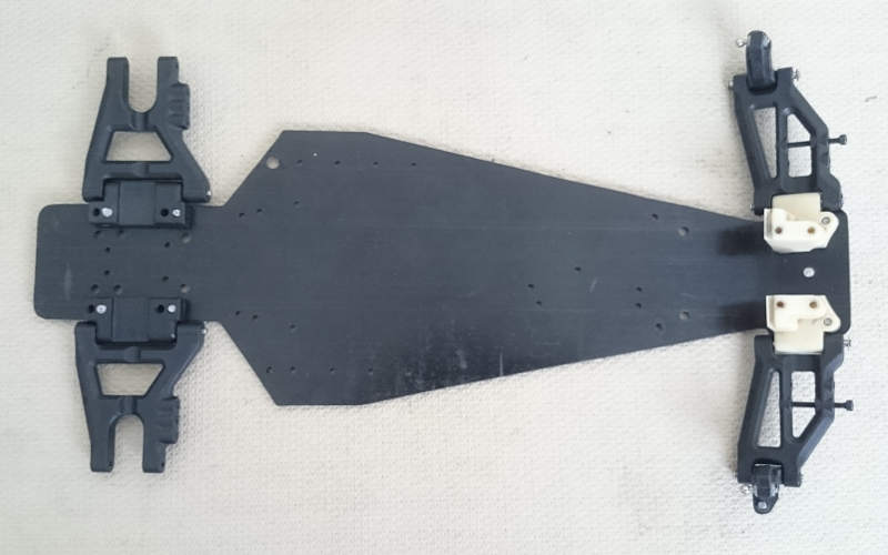

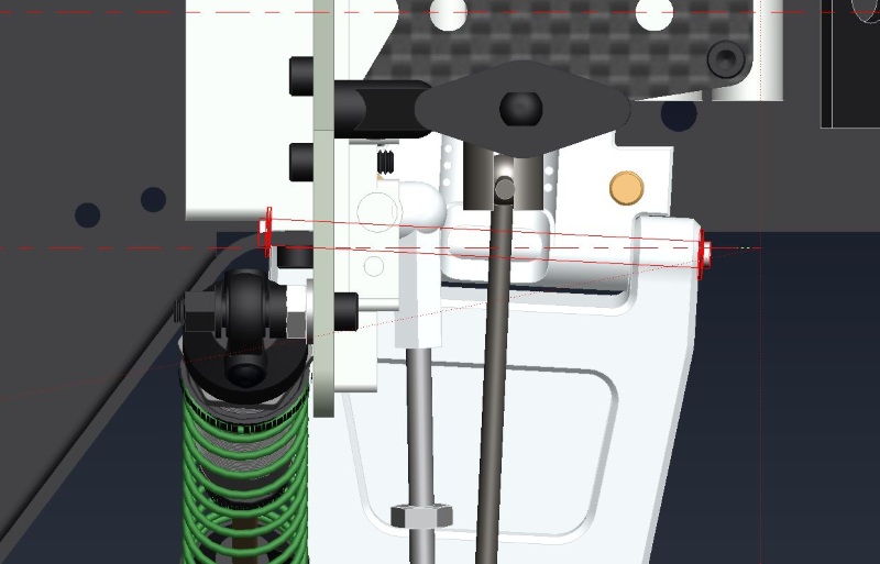

Working on a project and got a question about toe-in and quad-symmetry.
With toe-in at the rear arm mounts the pin-to-pin distance is narrower at the front of the inner hinge-pins than it is at the back...so which measurement is supposed to match the inner hinge-pins of the front arms? Narrowest point of the rear inner hinge-pins, widest point, an average of the two (center)...or should I be matching the front and rear arms using zero degree mounts :?:

Post by Niki »
When looking at the B2/3/4 rear end, matching dimension is somewhere between hinge pin center and rear end. Maybe at the point where arm mount and arm touch.
My version was made (if I remember right) with a imaginary zero degree arm mount. Turned arm mount then around rear screw and made the final 3d model. End result should be close the same.
Phin
Posts: 2818
Location: NY²
Has thanked: 87 times
Been thanked: 248 times
Re: Quadra-symmetric RC10
Post by Phin »
Thanks for the answer. :)
With 3 degree arm mounts there's up to a 1/4" difference in the pin to pin distance at the inner hinge-pins depending on where you measure from. If I measured from the front of the rear arm mounts I was close to symmetrical but at the back of the rear arm mounts I was too far off for my liking.

Post by Niki »
This is how Quadra was designed. Front end symmetry line and rear hinge pin highlighted in red. I couldn't get it closer to B2/3/4 symmetry than that :lol:
Obviously hinge pin end difference (compared to symmetry line) would be smaller with basic B4 type rear toe-in 1.5deg/side.
1.5-1 and 1.5-2 rear arm mounts could be easily done for Quadra.

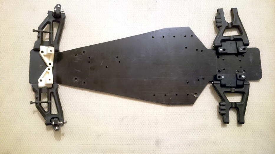

This is what I'm playing around with:
Started off as a wide nose graphite chassis (Hot Trick width) that had seen better days. I cut the nose down so the inside arm mount holes became the outside holes. I'm using RPM Truck Conversion arms up front which are practically the same length as stock length rears (2.25" vs ~2.23").

I tried Traxxas arm mounts before, and at first, they seemed just as off as the RC10 mounts (but wider than the rear instead of narrower), so opted to stick with all AE parts. I wasn't considering the difference with toe-in at the time though. Retried the traxxas front mounts matched up to 0 degree rear blocks and it's just about spot on.
With 1.5 degree mounts the pin-to-pin at the front arm's inner pivots is wider than the front of the rear hinge-pins by the same amount as it's narrower than the back of the rear hinge-pins.
So inner and outer pivots points are only about a couple of tenths of a millimeter off symmetry...which is closer than I thought it would be. :)
