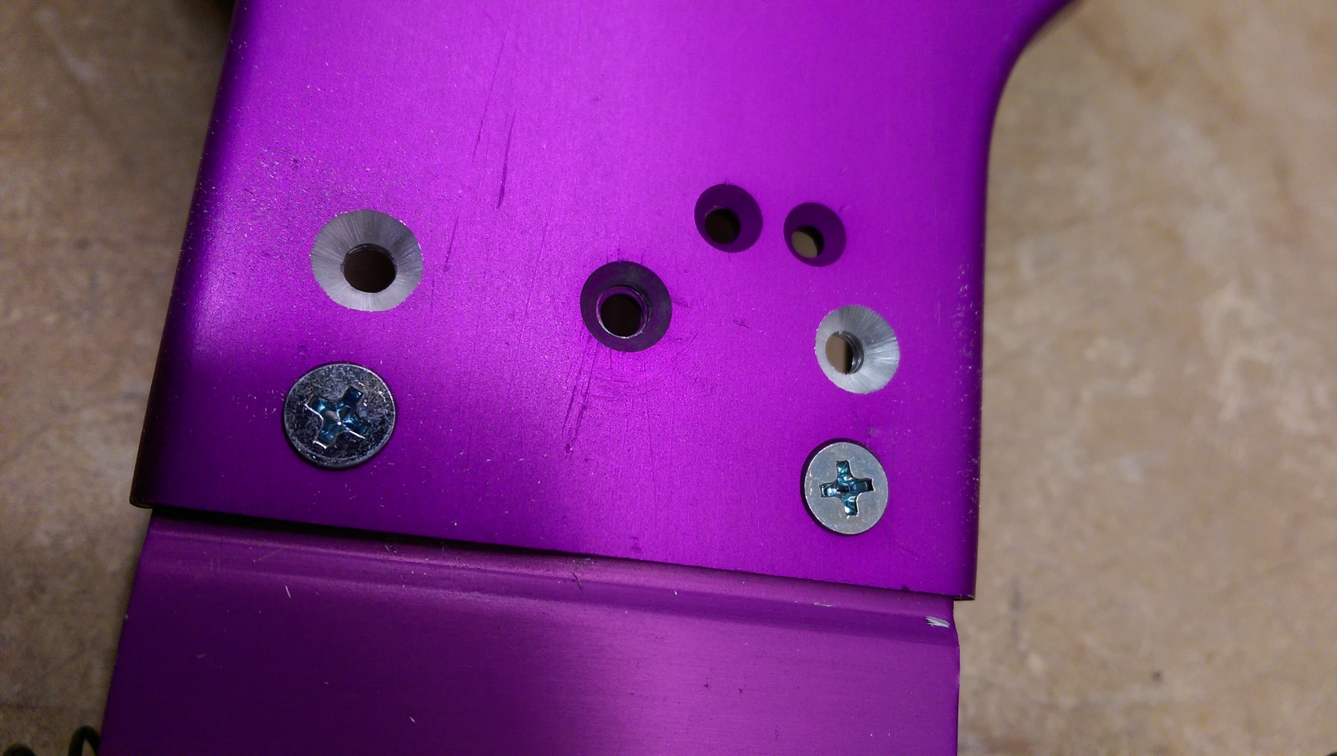

Doh! That sucks. Switching the nose will be fine. You'll need to either countersink the nose like I did on those, or drill and countersink the chassis and run the bolt thru. It's a better method for sure, but I know a lot of people wouldn't want to drill the chassis so I made it easier on them. Your choice
