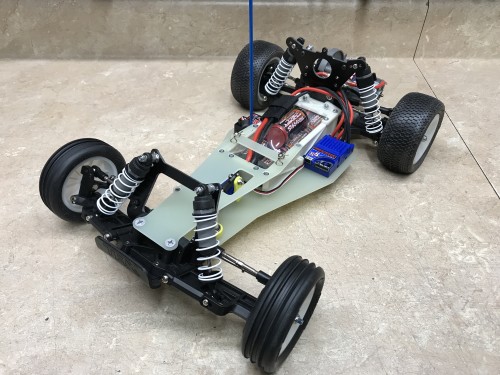

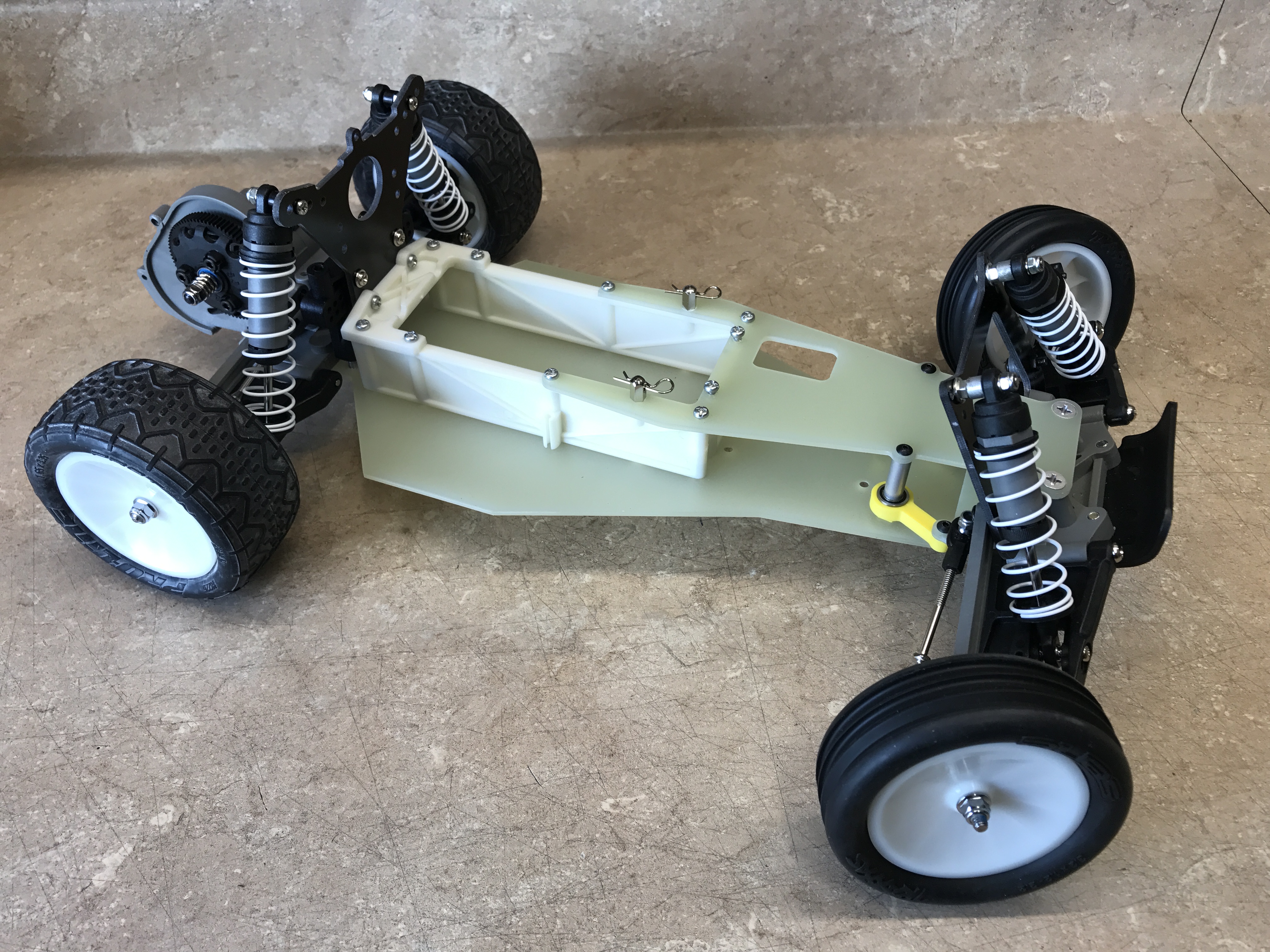

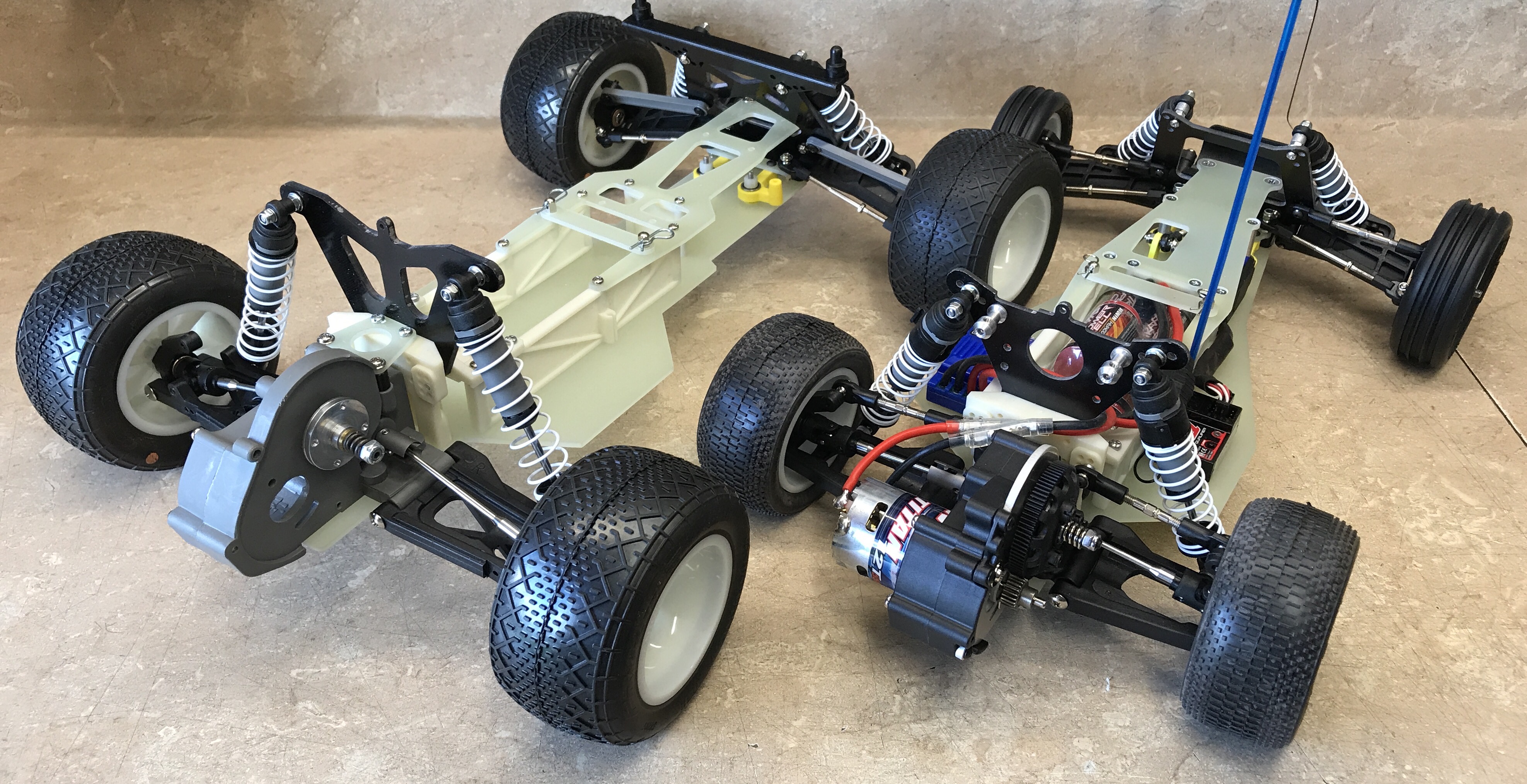

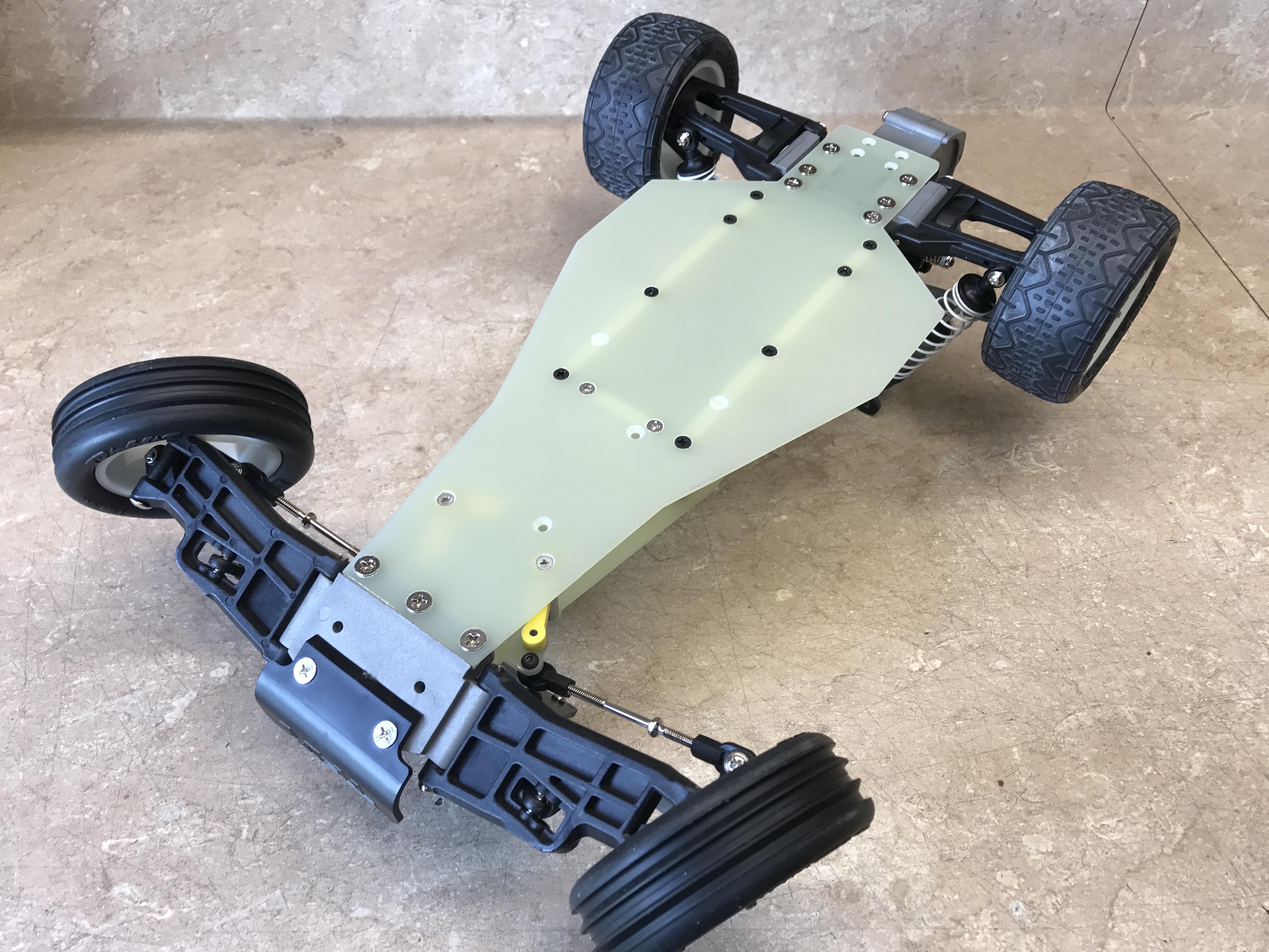

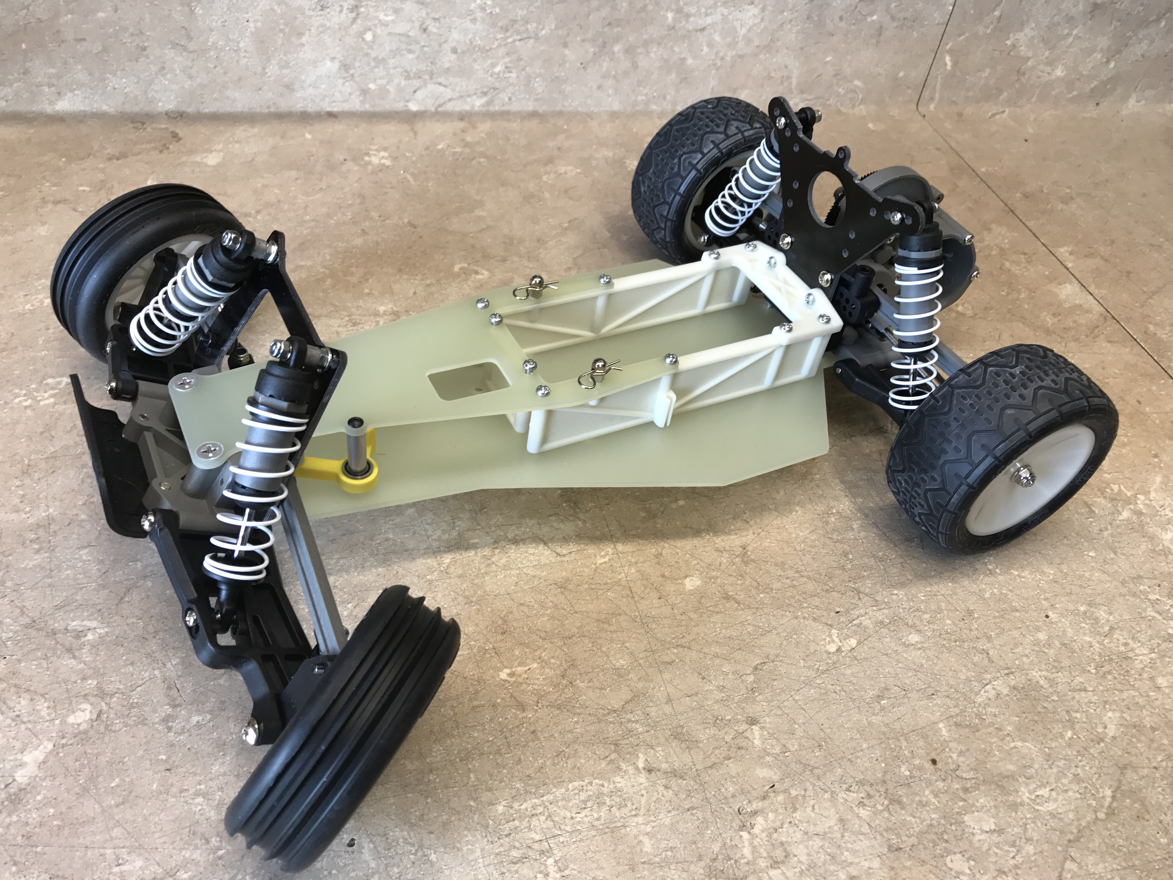

Not a difficult conversion, but since the TRX3 front bulkhead is so hard to find I used a Rustler/Bandit clip in whole. The rear is stock Bandit with a Nitro Stampede bulkhead (will need spacers) or a TRX-3 will bolt right up as well. I'll made a short brace for the trans to the bulkhead. The battery boxes are pretty easy to find. I'm using a A&L steering kit, but a TRX style should bolt right up if you can find one. The shock tower is a copy of the TRX3 but wider for the bulkhead.
It's not a clone by any means, just a cheap and easy way to have a runner that isn't just a damn Bandit

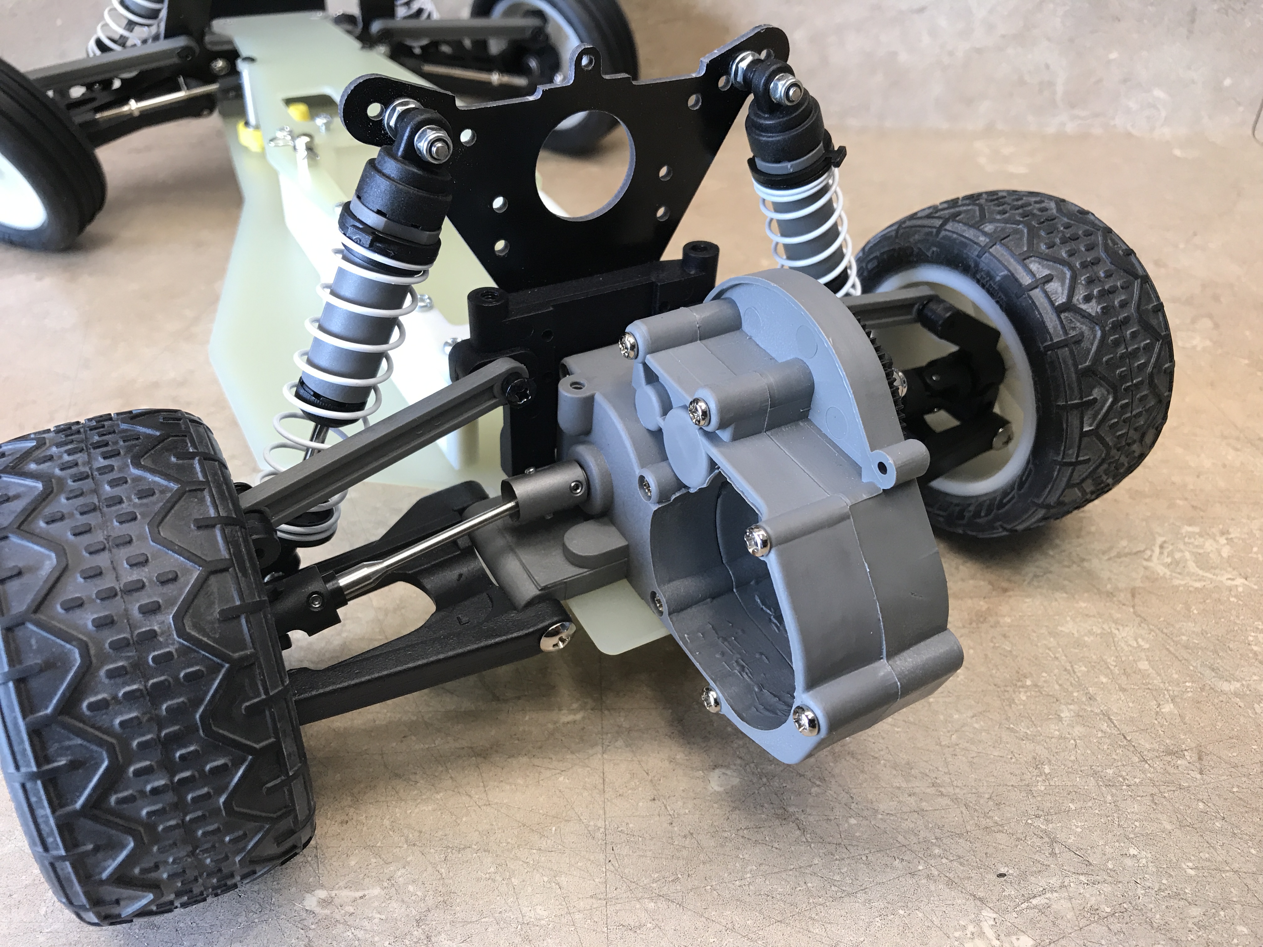

Nice work. Is the mounting screw pattern for the all plastic with integral arm mounts trans identical to the original 272 trans? And do the traxxas steering posts fit the A&L bearings or what's up there with the posts?

Hole pattern for the entire rear is identical...except...the small screws are not correct. On the sample shown you can see I don't have any screws in them. I plan to move the one set and eliminate the other. I don't see people with a true trx3 doing this so might as well cater to the Bandit.
The posts up front are just A&L yellow posts with some aluminum standoffs above em. The stock steering set would fit but you'd need the whole thing. I can replicate this setup where the Traxxas parts are harder to find. The rack bar is custom to allow stock Bandit links to work without modification
The bone conversion is different too. The trx1 set won't fit Bandit, these are A&L Losi bones for the LW cut down 1/8". I might have some made up.

I could use a trace of the chassis and upper. I have the rear tower drawn. I think I have the front but not positive. They are cheap tho!
I think I'll convert the Bandit(TRX-B) to the Rustler (SRT-R?) instead of buying a fresh kit to swap. Not many differences in pieces really

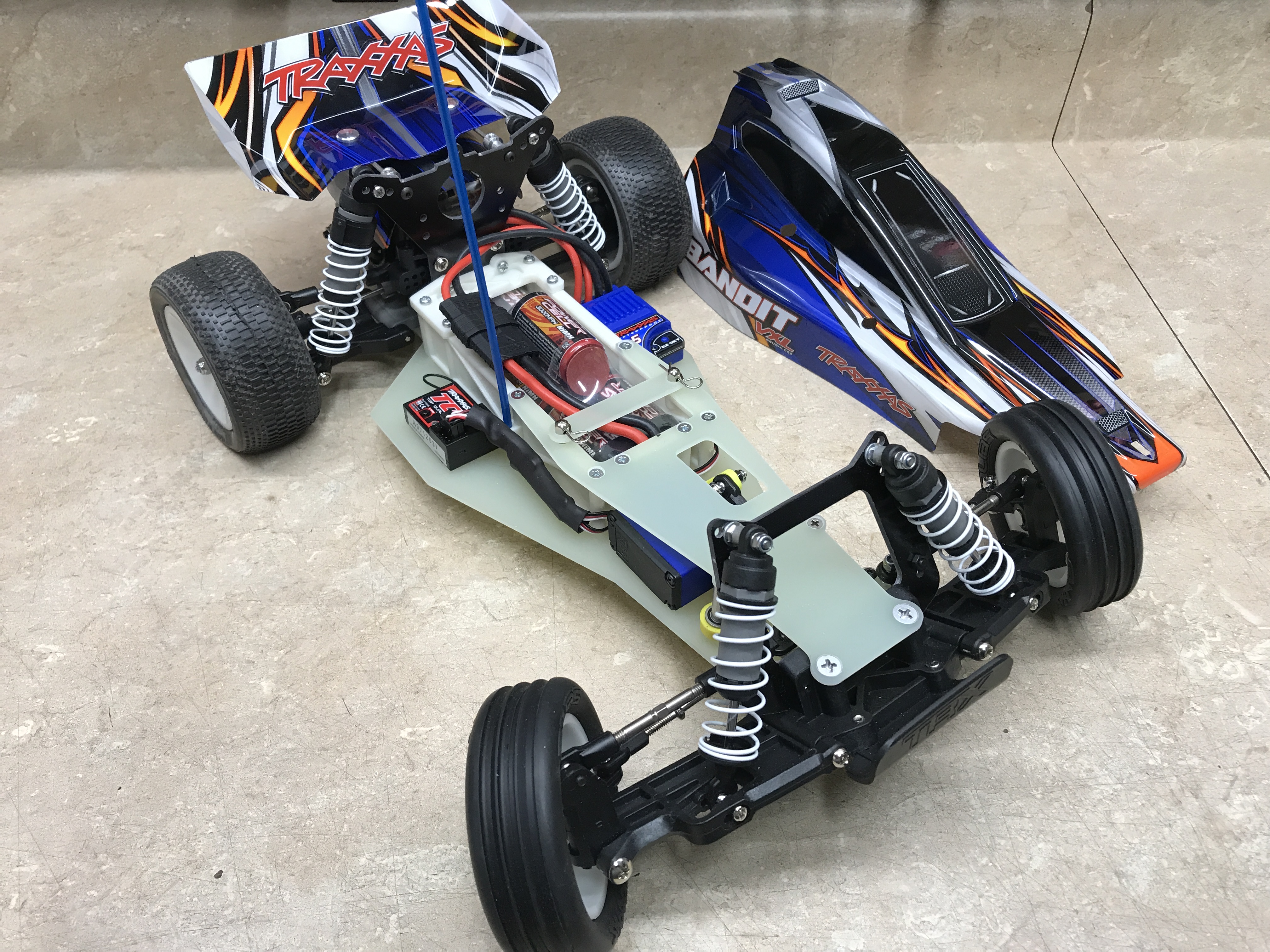

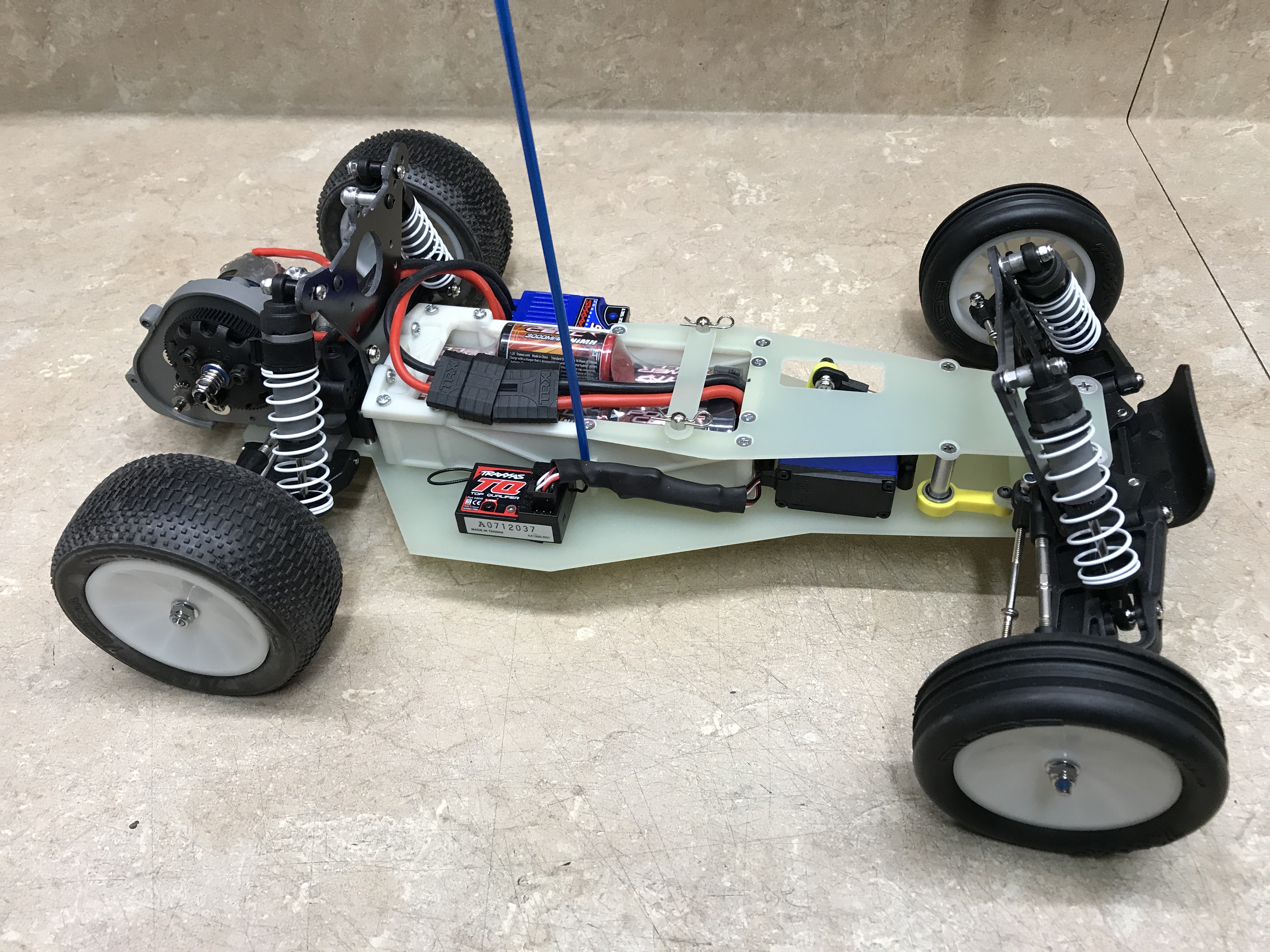

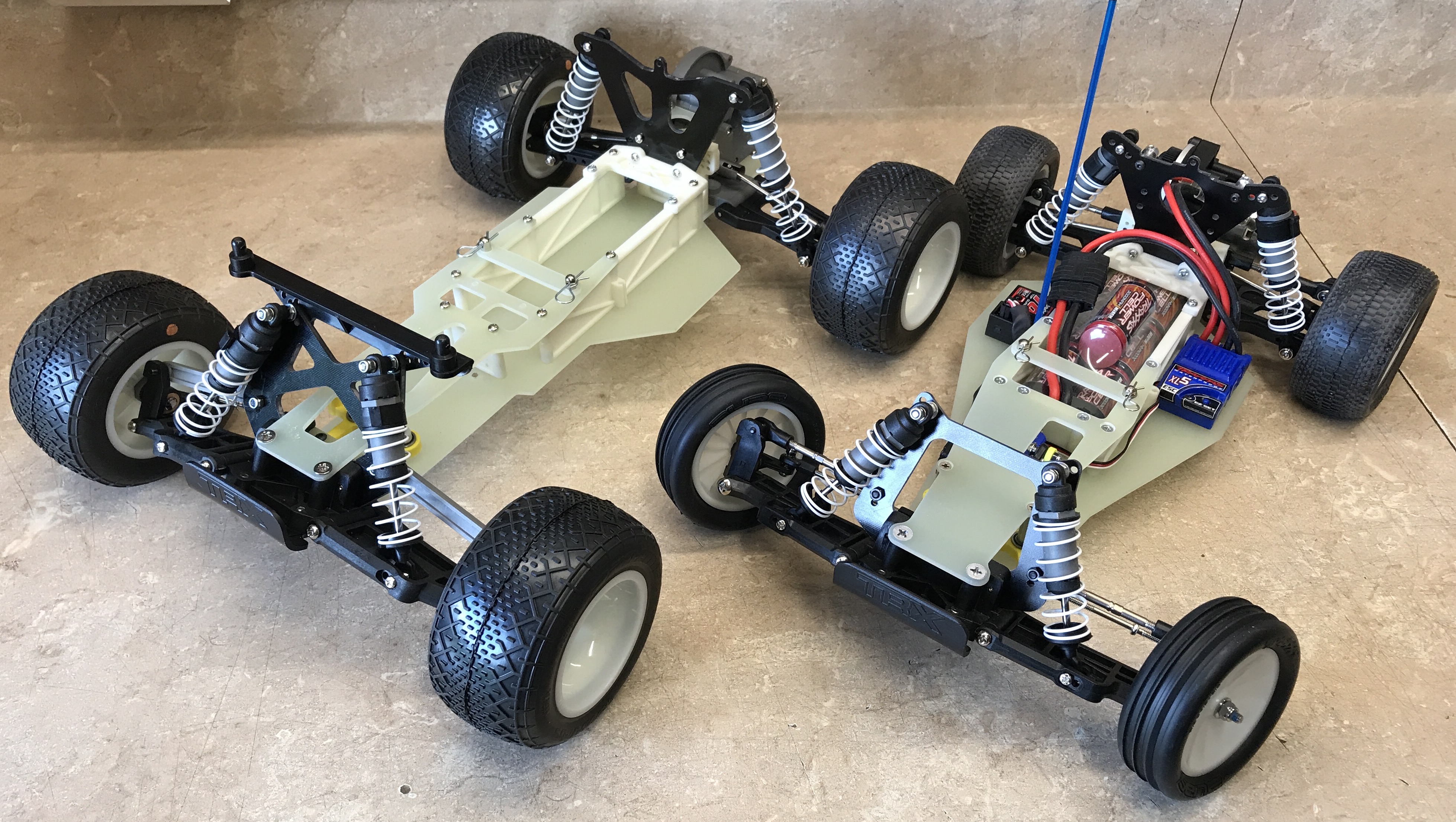

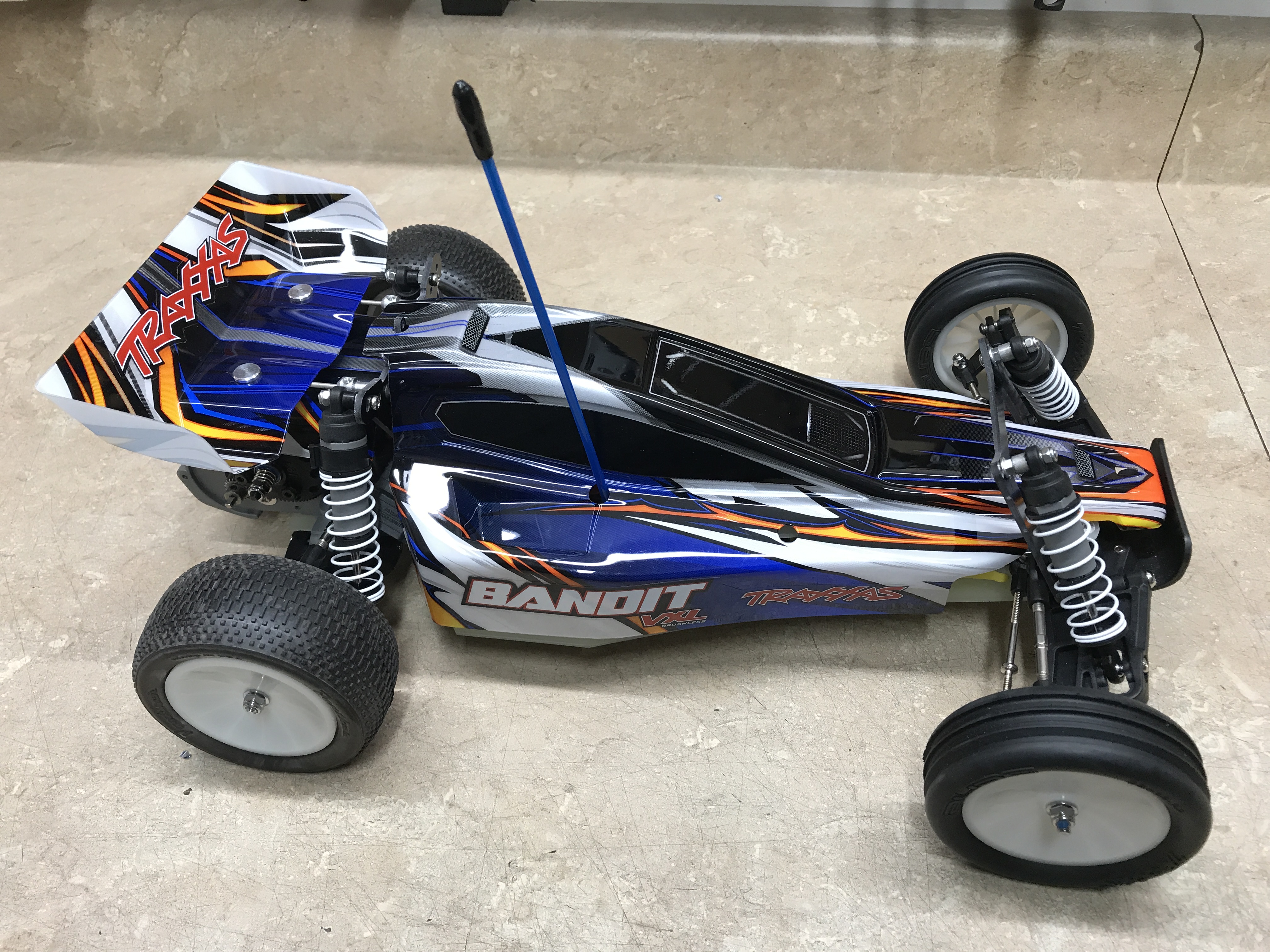

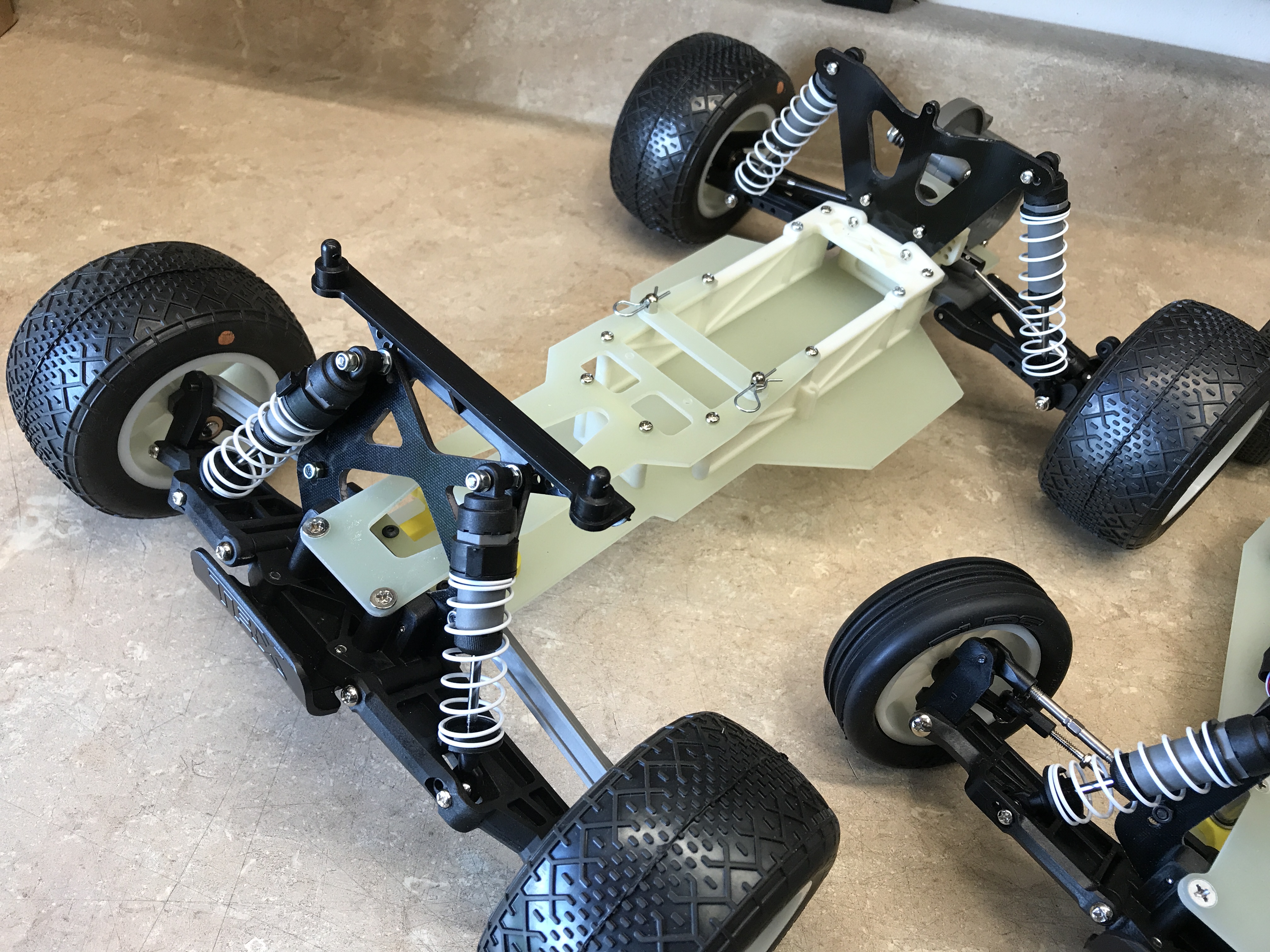

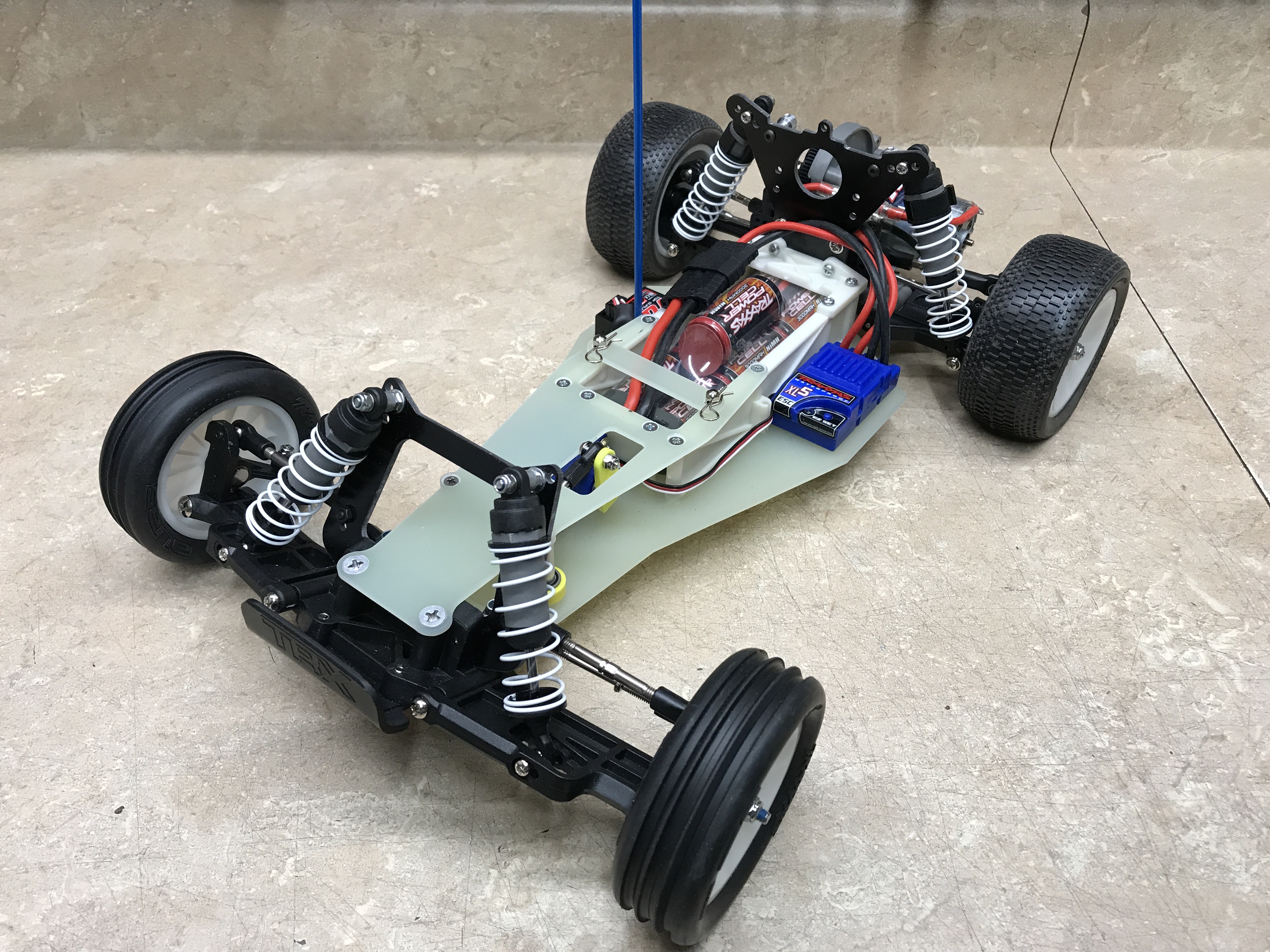

Re: TRX-B (poor mans TRX3) and SRT-R (you guessed it!)
A few pics of the SRT-R brother alongside the TRX-B

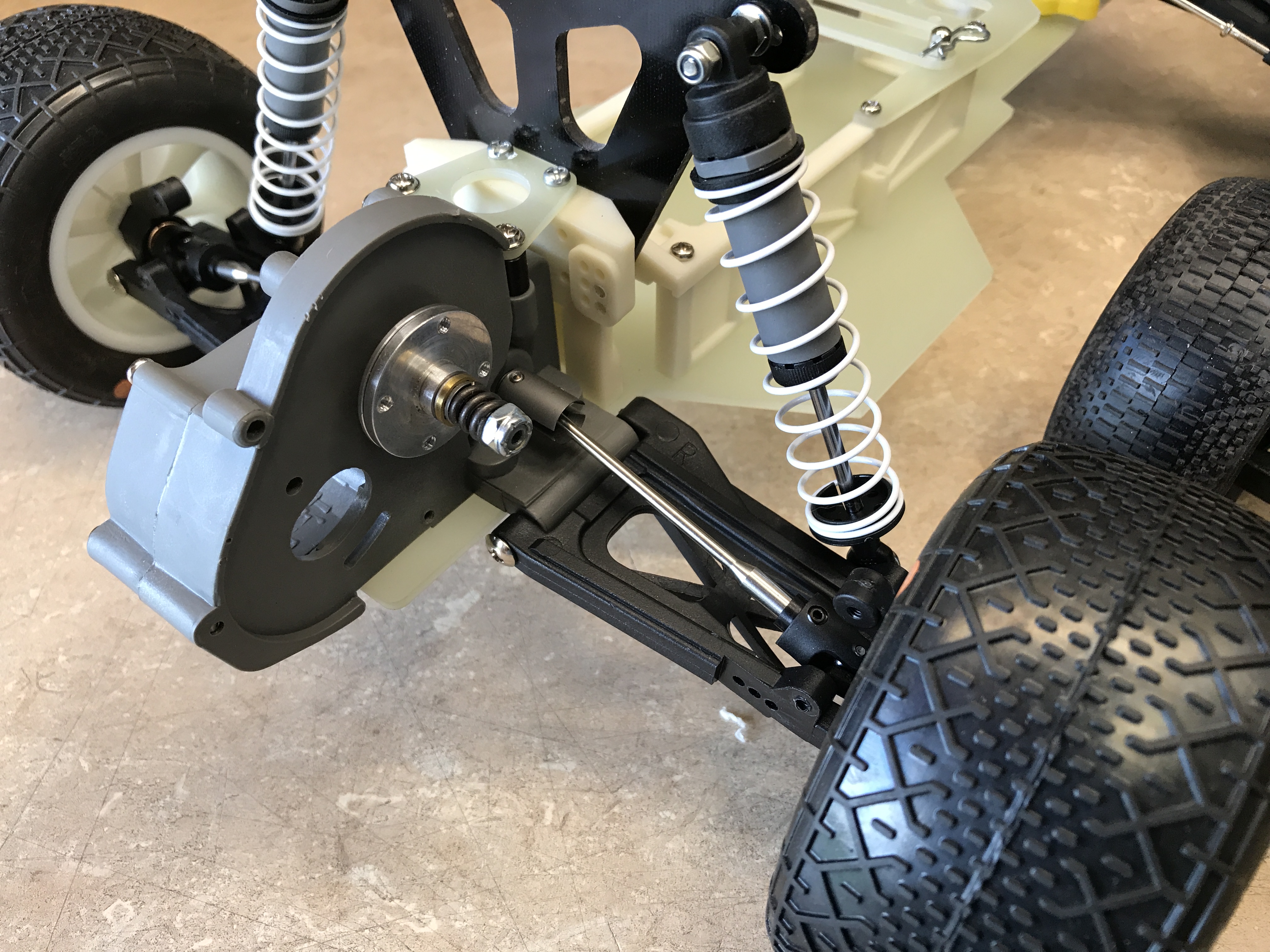

SRT-R is set up with the Power Clutch as well. I wanted to know if it fit

Did you reproduce the rear shocktower also?
I don't know if it's the ageing, but a lot of the old black glassfiber epoxy towers i have from traxxas, have stress cracks or miss a broken off part.
I do like this conversion better than your ultima trailing arm one. More space on this chassis to mount the electronics low.
- Posts: 12214
- Has thanked: 1084 times
- Been thanked: 3762 times
Yes I have the towers available. The rear on these are original style but I did draw up a version with modern wing mount holes too
