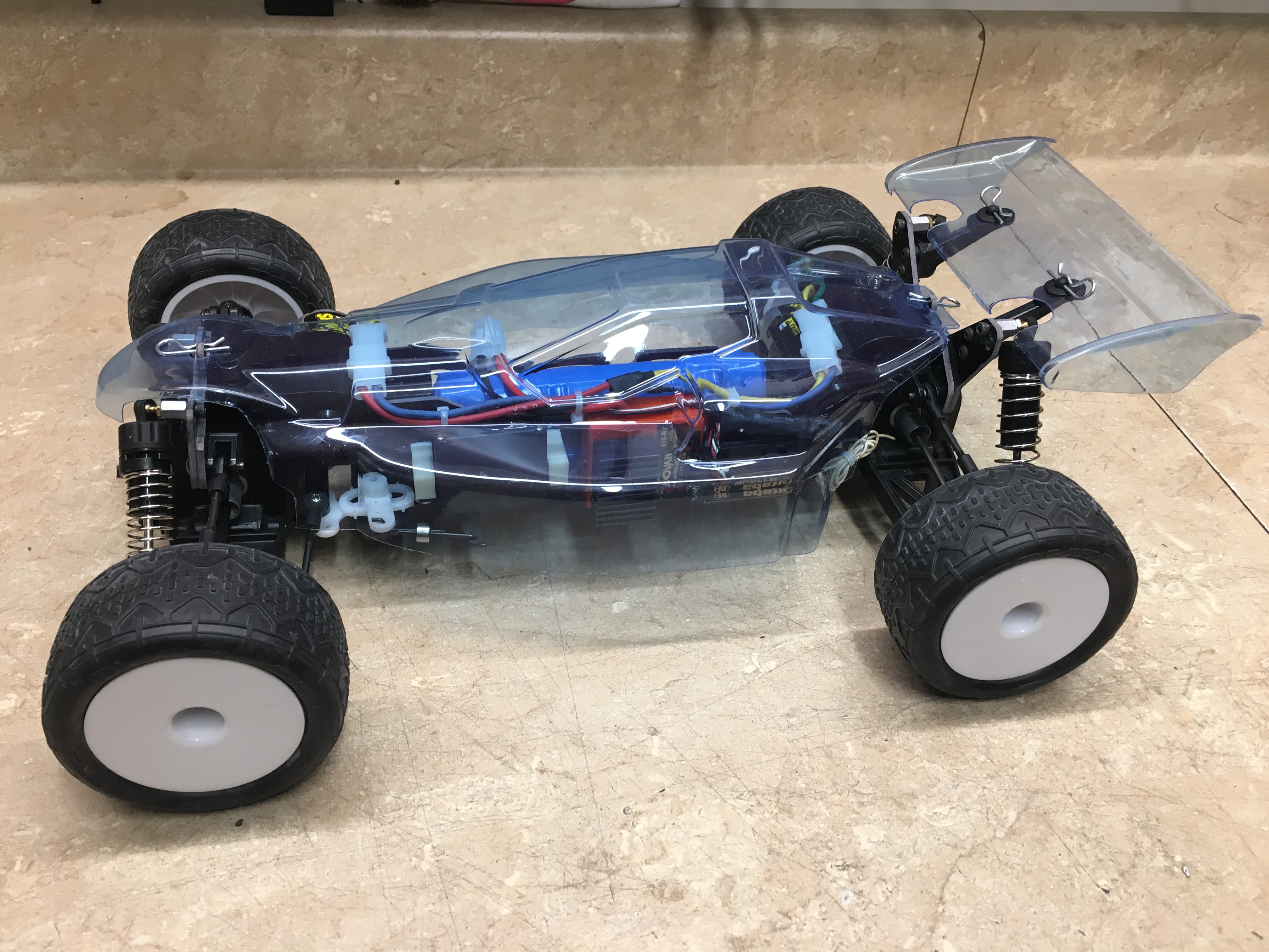

Can anyone explain the impact of the rerelease Egress's lack of the lower BF8/9 lower shock mounts has on the newer version's handling vs the original? It seems to dramatically lower the front of the car as well as set the shock angle more like that if the Vanquish. It also almost allows the chassis to bottom out as opposed to letting the shocks bottom out. Did Tamiya only omit the brackets but keep the tower height the same? Thanks.

Thank you! Awesome reply. This is exactly the kind of info I was after. As far as I know, Tamiya kept the shock tower of the re-release tall, but also wider. Wow, so the ol' Bigwig was better to drive than the Egress? I could see it. Those first gen Tamiya 4WDs were plastic fantastic but pretty tough overall. Thanks again.

I remember that short Hi Cap tower. I think it was for adapting Hi Caps to the Avante and Vanquish. Basically, I think I'm retracing your footsteps Dan. I'm trying to get the front end to bottom out before the shocks run out of travel to save the control arm mounts molded into the front gearboxes. I hate that design aspect and want to preserve those gearbox casings.
