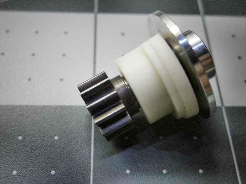

I need a bit of help from the Guru's on the 6-gear tranny...
The manual says to tap the tap the diff pinion onto the diff tube. What I'm not getting is how far, how much?
Bum on Direct Deposit
Posts: 12336
Been thanked: 3919 times
Re: Trannies on the corner...
Just to seat it. That should be fine. You don’t need to use a press or anything. It’s somewhat like setting a Jacobs chuck in a drill press
jwscab
Posts: 6580
Location: Chalfont, PA
Been thanked: 505 times
Post by jwscab »
Right, it's a taper fit, just be sure it's seated squarely and that's it. No further pressure. Once it's assembled with the top shaft and thust and diff gear the spring and nut apply pressure to keep seated and locked.
NomadRacer
Posts: 1467
Has thanked: 81 times
Been thanked: 79 times
Post by NomadRacer »
Thank you kindly, gentleman!
