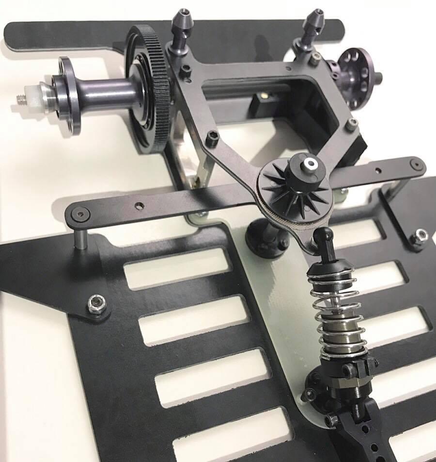

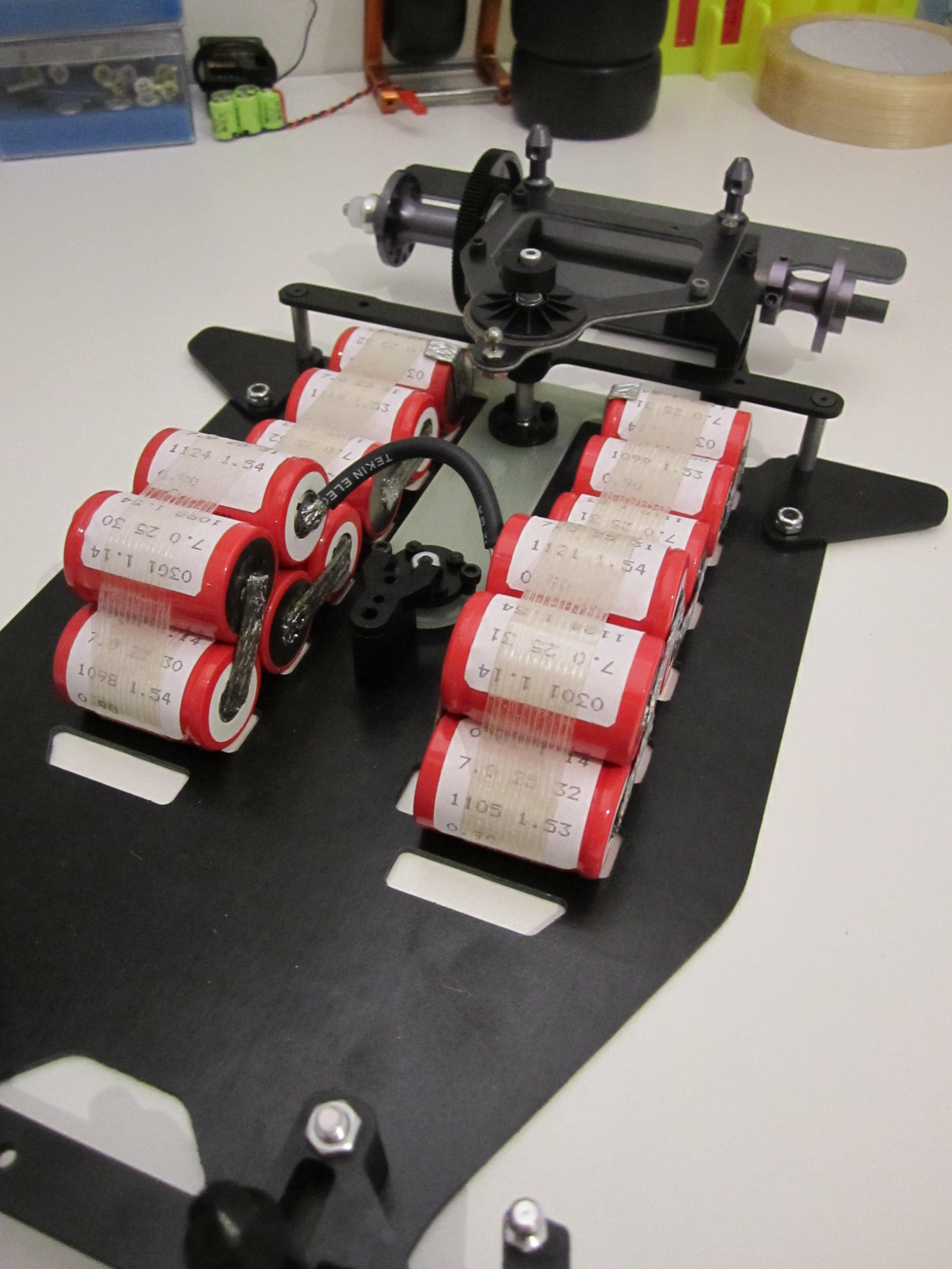

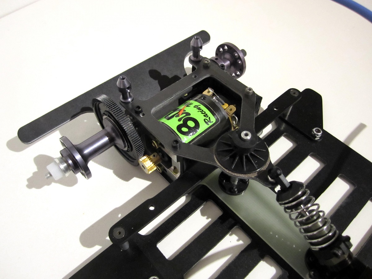

It has been a while since I updated on this build, but there has been som progress.
Rear end is in place and battery packs has been built. Cells bought trough Aliexpress, braid funded by NomadRacer and made some matched decals using Dotrice font on self adhesive paper.

Re: Insane speed run build
Thanks Michael

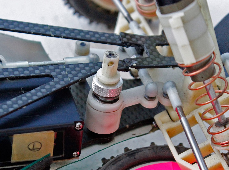

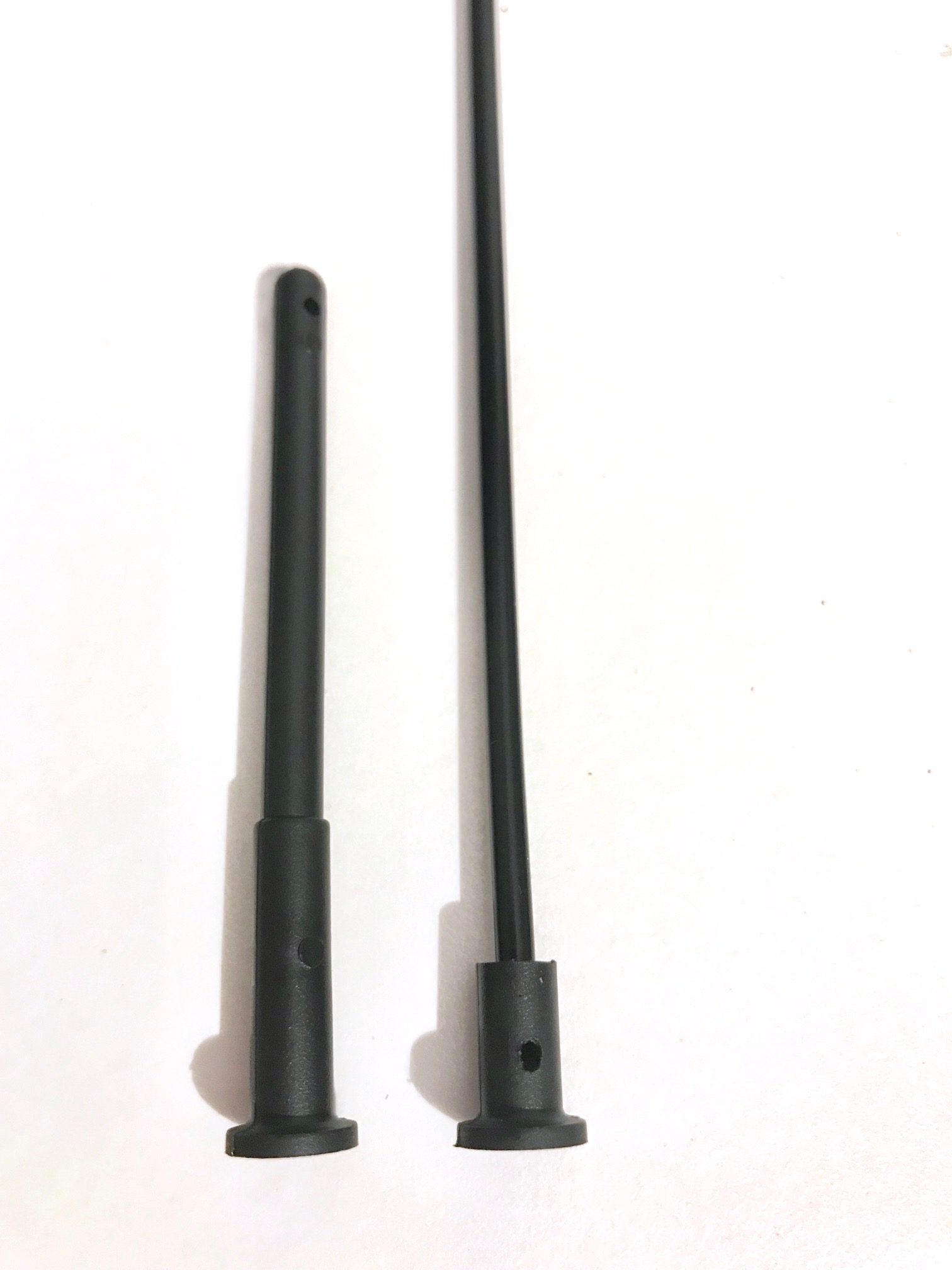

Played around trying to create a antenna mount for the car.
I had these body posts lying on the bench and thought: Hey! Is that what Clausen used on his 1991 car?
Well looks kind of similar anyway
Hey Erik, thanks for sharing your antenna mount! I have a project that I'm gathering parts for and have been stumped on what to do for a mount!
You're wellcome manNomadRacer wrote: ↑Tue Nov 07, 2017 5:47 pm Hey Erik, thanks for sharing your antenna mount! I have a project that I'm gathering parts for and have been stumped on what to do for a mount!
Come to think of it. Could it be that Masami used similar post as body post on his 1991 Stealth car. In the front I mean!?

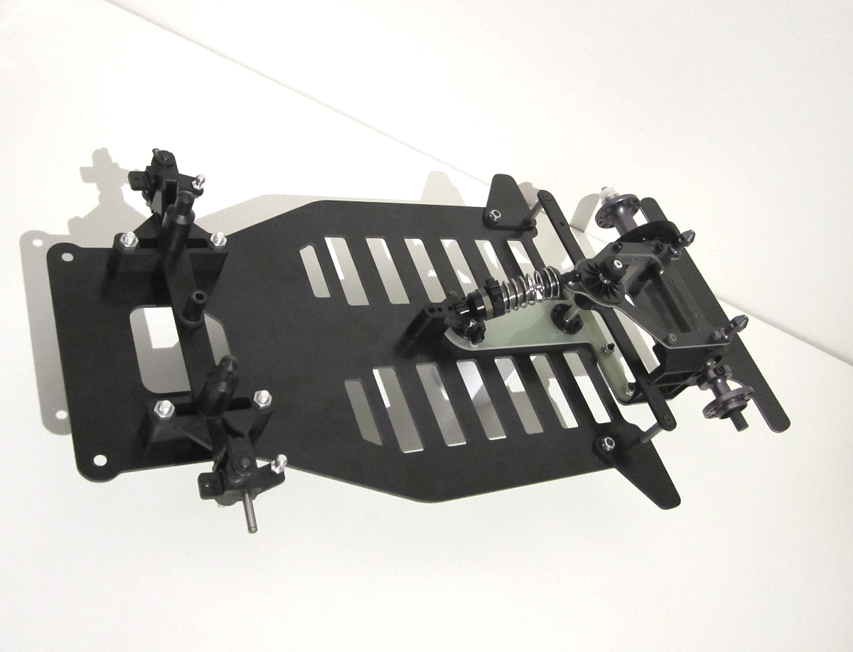

Summary of the build so far:
Newly bulit AE hard anno .56 shock with silver spring.
TRC aluminum ball joints.
HPI hubs and wing mounts.
Kimbrough 64p 120T spur.
Composite Craft Teflon tape on upper pod brace.
Some BRP aluminum 4-40 screws here and there.

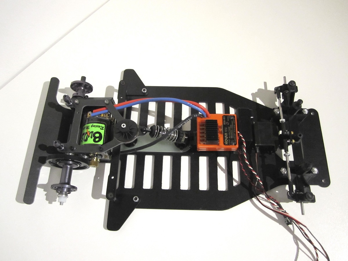

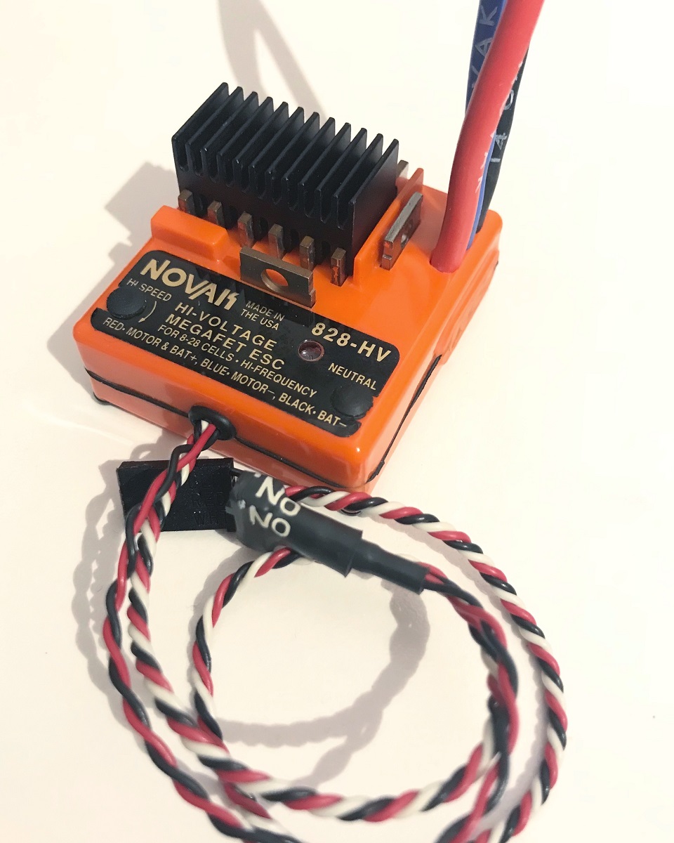

Made some progress this weekend.
Delivery of servo, soldering Schottky Diodes, modified housing and re soldering wires on esc and tried different layouts of the electronics.
Everything looks so clean but the installation of the diodes is stunning!
Thanks man, quite pleased with that myselfNomadRacer wrote: ↑Sun Nov 19, 2017 12:36 pm Everything looks so clean but the installation of the diodes is stunning!
Next up is to get hold of a body. I'm leaning towards repro Tamiya Mercedes C11. The cockpit is abit on the high side in profile, but era correct. I have noo big hopes finding a AE 6125 Jaguar for this build.
I also need to manufacture a front bumper and tidy up the wiring.
