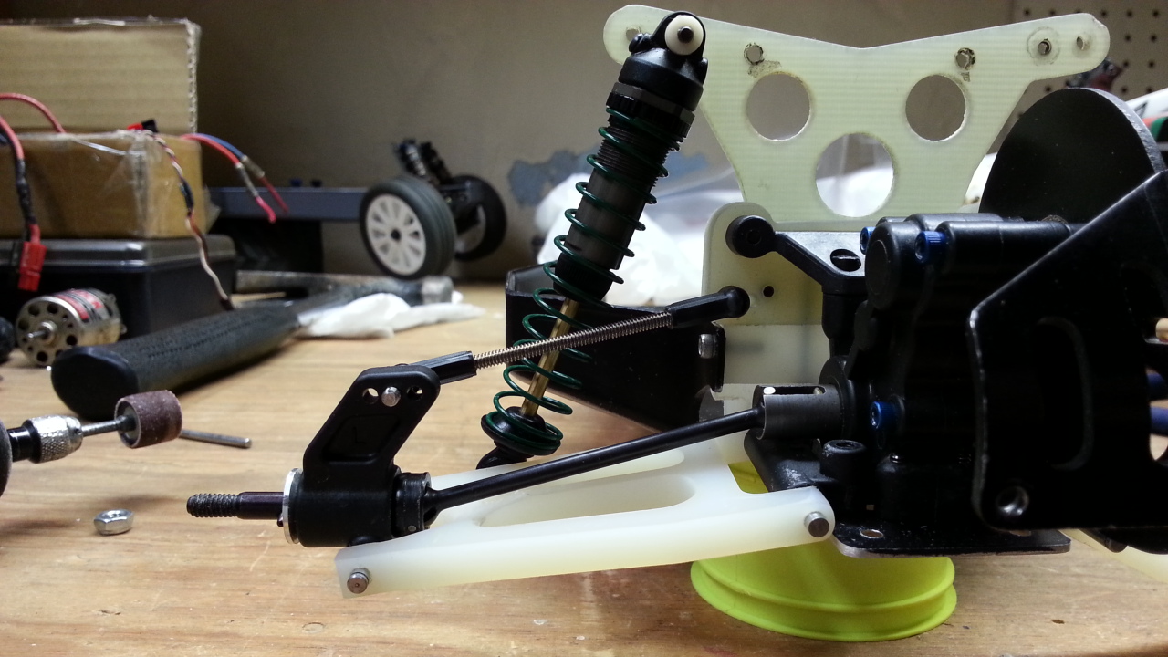

I had to run to hobbytown so I grabbed a pair of b4 rear hubs to try on this. With b44 cva's, I'm about 1mm wider than my "old is new" cars. I still need to clearance the arms a bit, but I think this setup should work. I'll just run b4 wheels on it.

mocked it up a bit last night. did some dremel work on the outer arm for clearance. also tried some shocks to see which length i will need. without making a taller shock tower, 1.32's are too long. 1.18's seem to be about right, so i will go with them. it's quite cluster%@#$ of different parts so far. t2 tub, b2/b3 trans and arm mounts, b2 arms, b4 hubs, shocks and wheels, b44 cva's and an rc10 shock tower.
now that the rear is basically figured out, time to move to the front. at this point, i'm going to go with a truck nose plate just for ease. but there will be longer front arms made for it.

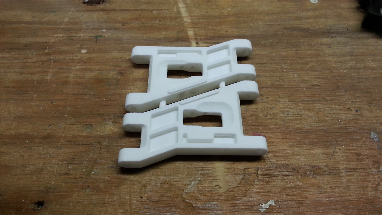

I finally get to update the purple chassis build.
Around October last year I asked Niki if he would be willing to help me out drawing up a pair of front arms for me. He agreed, but it evolved into a much larger project which is why it has taken so long. That project build will show up on here one day. But back to the purple build for now.
My plan is to just use rere white parts on the back. But with the truck nose I would've been stuck using rpm or dynotech arms. I didn't want that, so I sent Niki an rpm worlds arm to draw up and asked him to make it look like an AE wide track arm. Well, here they are...

Re: RC10 B1.5 - Build #3 and #4
Take a coffee or tea break to get that bright white color away...
