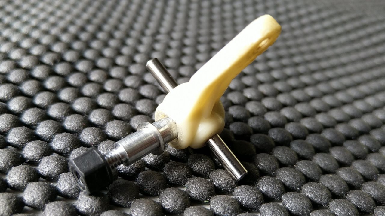

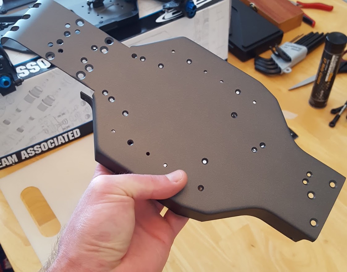

Gathering parts for the build. Niki, the MJF parts look great and feel pretty study. Jeff, the carbon work is fantastic. I've cleaned up the pan and plan to have it Cerakoted.
Re: Quadra-symmetric RC10
Sorry, not too much to see yet. I planned on dropping off the pan and nose section for Cerakote last Friday but couldn't get off work in time. Tis the season when massive corporate projects are due

I got some MJF parts also and I agree. Good thing about MJF is that material properties are equal in all X-Y-Z directions.
Tower set looks great.

Sorry about the hiatus guys. Life got in the way and I've been scrounging more parts. The tungsten Cerakote came out awesome! It should be more durable than powder coat or Type 2 ano.

That color is amazing. Something different for sure. Its gonna be a sharp ride.

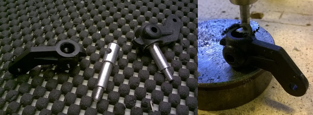

Hi, good you found axles. These are the options I know...
Pan car axle #8443 can be used. Axle thick end is shorter than #6220 but with a shim washer you can stop bearing cutting into plastic.
If you want slightly narrower front end, B3/T3 axle #7221 can be used. Then you need to take a little bit material off from the steering block.
-Niki-
