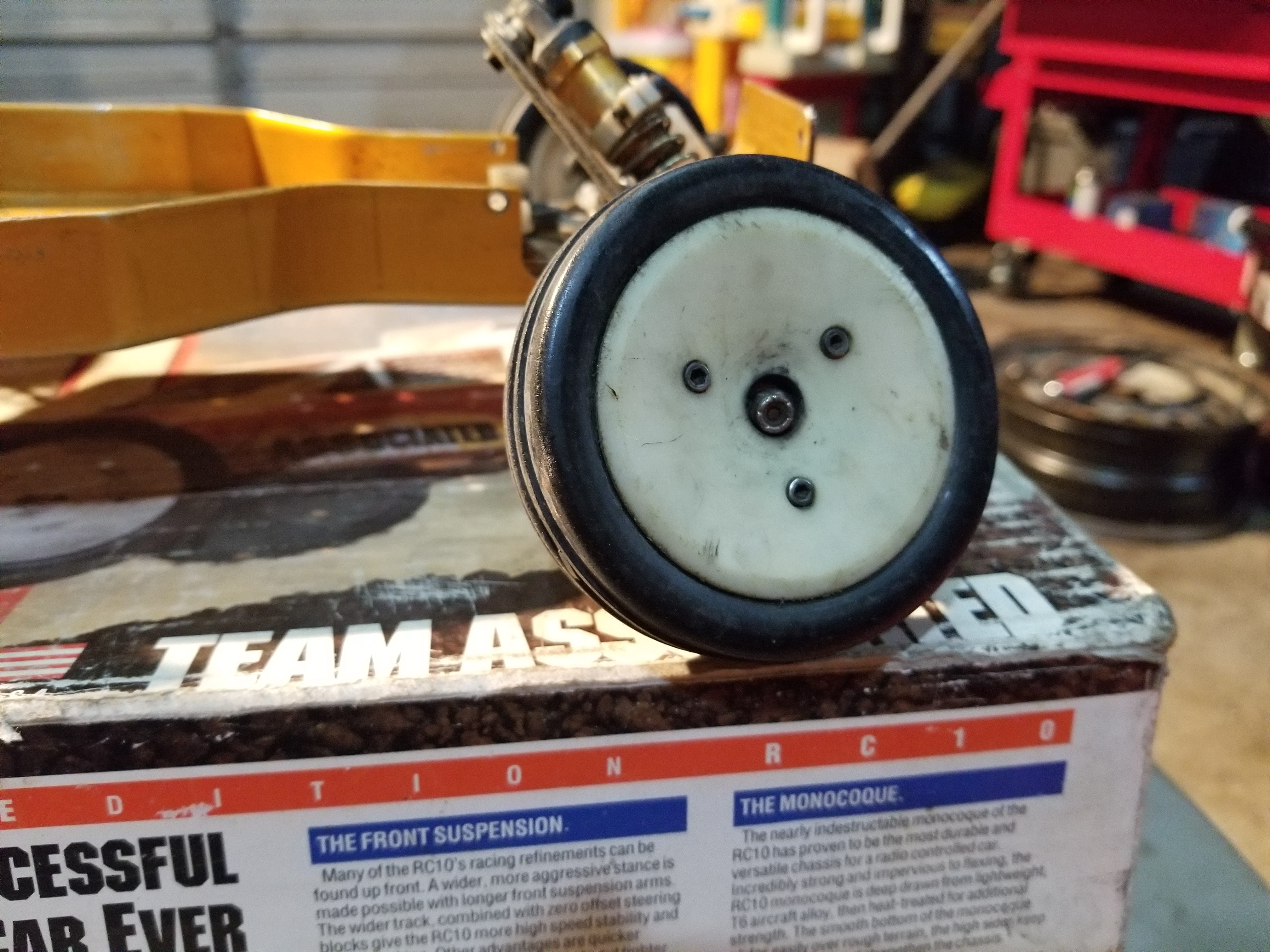

#1. Modern wheel/tire upgrade, spoked wheels would be nice, not a fan of the smoothies anymore. Need wheels for sure, pin slots in rears are stripped out in my stock wheels. So what do i need as far as front axle size, wheels and bearings? This also plays into the next question on axle size as well...i have no idea where to start.

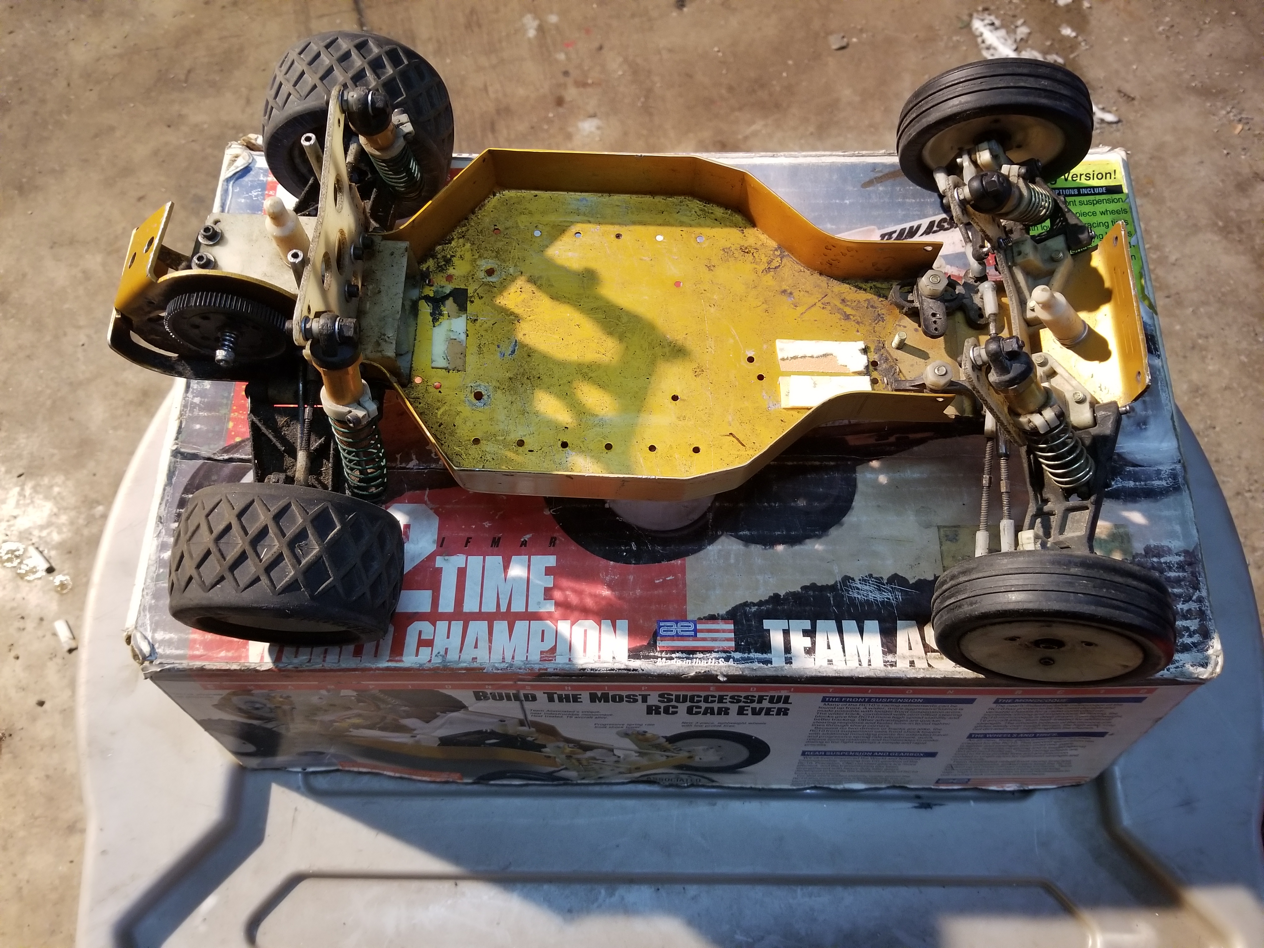

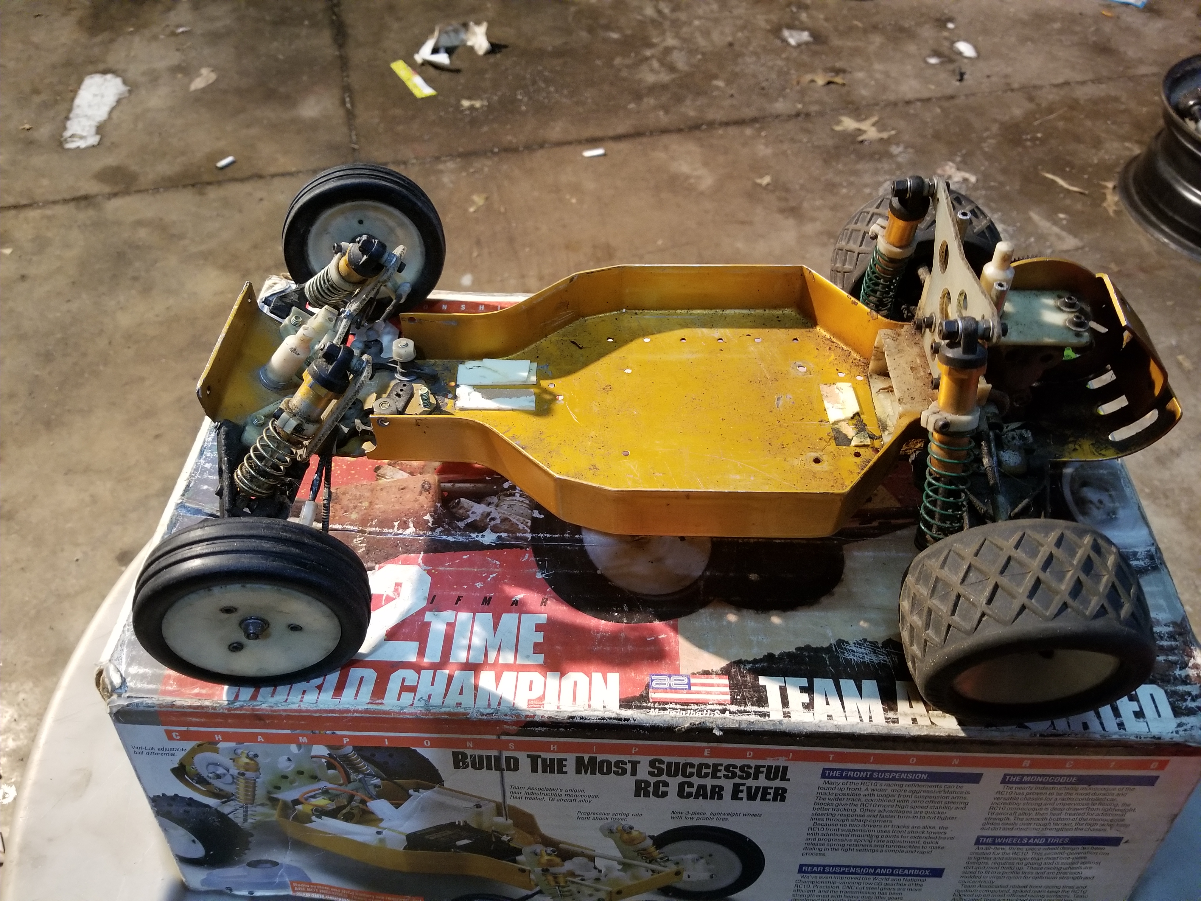

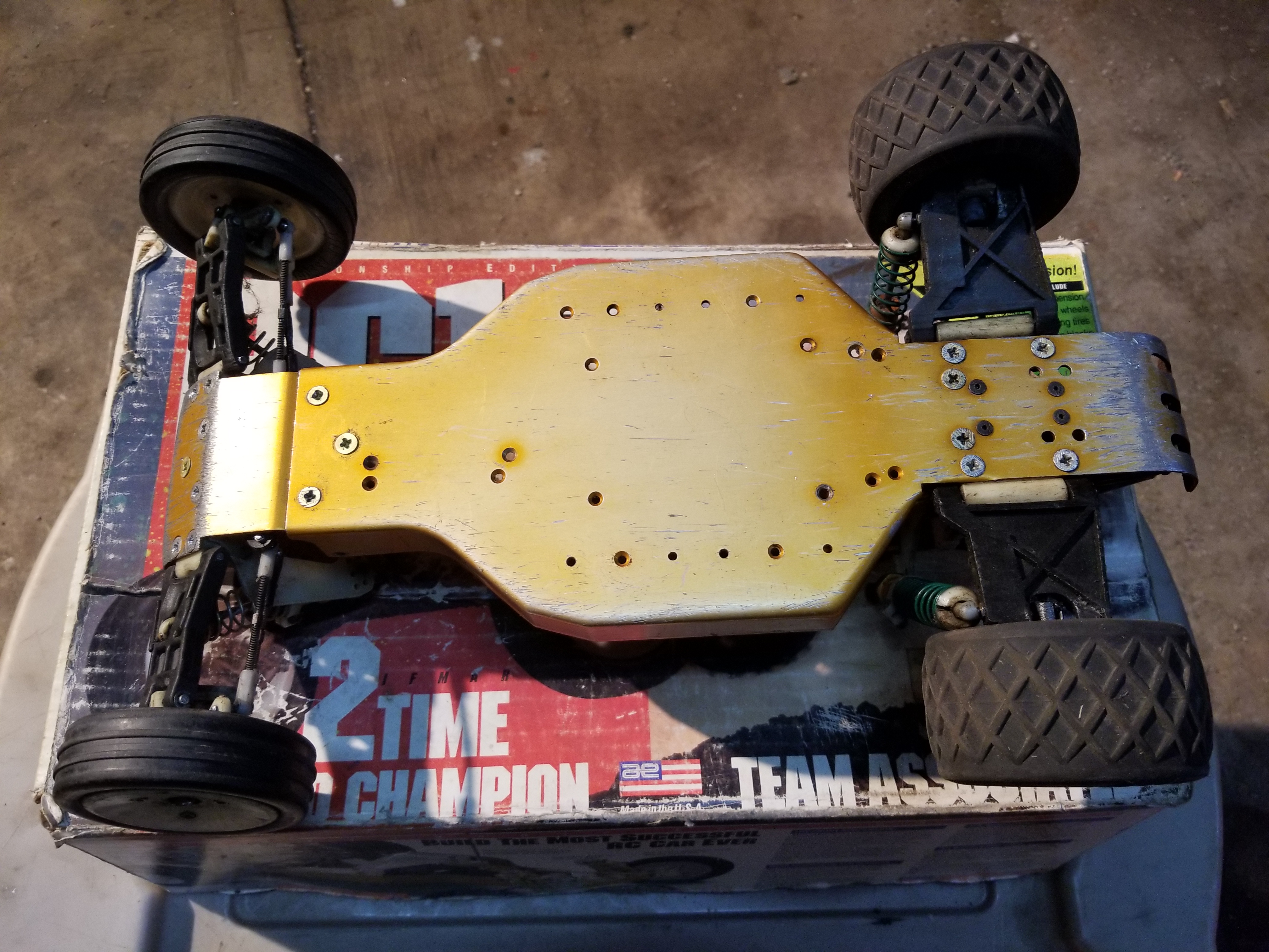

Well, it's a start. Should clean-up pretty nice. Missing nose tubes = bent nose plates. Fortunately, replacements for both are readily available.

Re: 20 Years In A Box - Another RC10 Revival (Need help with upgrades)
Yep, that nose plate has seen concrete a few times, on the edges its so chewed that its almost paper thin, I will definitely replace it, for cosmetic reasons if nothing else. Did they ever make a plastic bumper for these?
Amazingly only 1 shock is empty and i have the rebuild kit, just need to make sure the shafts arent too bad.
The slop on the trans top shaft is horrible, hub carrier bushings are so smoked that the wheels flop around like they arent even there and the diff feels pretty gritty. Otherwise it just needs a cleanup, new set of bearings and a radio.
I hope to get started on this in the next couple weeks.

In the photo second from the bottom, it looks like your front shocks are leaning back quite a bit which suggest a loose or bent plate. However, it could just be distortion in the photo. Anyway, you'll know when you install the new tubes; they will appear to be too long. If the plate is bent, they're pretty easy to correct using a bench vise and some patience. I've had to straighten a few before.
