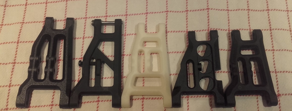

Got another Pro-XL question...what is the pin to pin on the XL front arms? I could find comparison info but I couldn't find an actual measurement. :?
I think they're longer than Any's Ultima arms (~2 1/2") which I'm guessing should put them at about the same length as RPM JRX-T arms (~2 3/4").

We can´t do inches over here!

Thanks Dennis. Metric is fine...I'm one of them there's that think the US should ditch inches anyway. ;)
Was thinking RPM JRXT might work as a sub, since they're easier to find...but it looks like they might not have the room to mount the uprights in the outside hole, and would have rubbing issues, at the front of the arm, with a deep offset wheel.

You are correct, JRXT arms will only work with upright inner hole.
