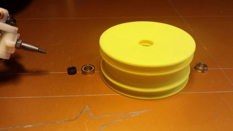

JK Racing
Posts: 4619
Location: Placentia, CA
Has thanked: 139 times
Been thanked: 246 times
Re: B4 front wheel axle combo
Post by JK Racing »
I'd need to find the pics in photobucket, download them and re-upload them here. Using a combo of different sized bearings, you CAN use the B4 front wheels on the original length front axles.
I'll start here in a few minutes....
--Joey --
Vintage A&L and Factory Works
JKRacingRC.com

These are not my pics, but I had saved them: (I dont quite remember who did this originally)

Here was my results - Duratrax wheel on one side, B4 on the other:
